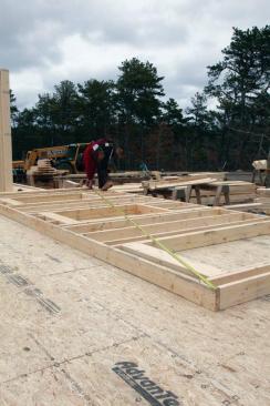

Equal diagonal measurements between opposing corners ensure that the wall is square.

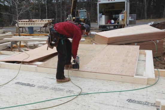

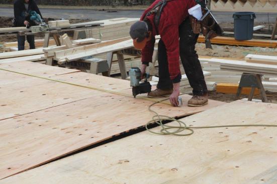

TACK THE SHEATHING IN PLACE
The crew then tacks the sheathing to the studs, using a tape measure to follow the layout.
On this home, the sheets are flush with the top plate and they split a stud.
With the framing complete, the crew takes diagonal measurements between the opposing corners of the wall. The top plate of the wall is tapped over until the measurements match exactly, which ensures that the wall is square. The crew then tacks the sheathing to the studs, measuring from one end with a tape measure to follow the layout with the nails. They make the sheathing sheets flush with the top plate and set the sheathing so the edge runs down the middle of a stud.

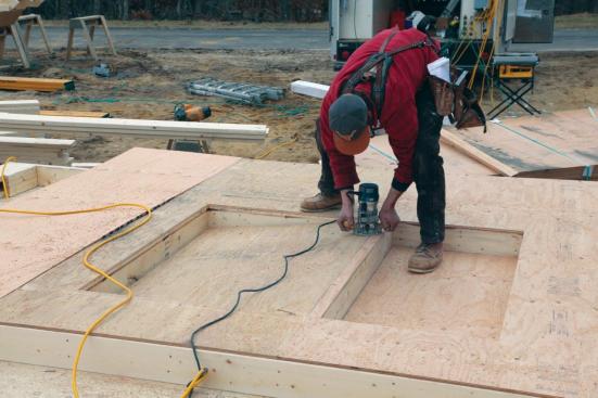

CUT OUT OPENINGS

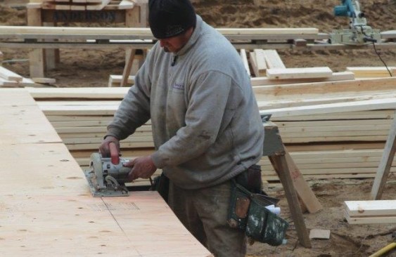

A worker using a router equipped with a bearing-guided bit cuts out a window opening. Openings can also be cut out with a circular saw or a recip saw.
Some framers prefer to cut out the openings by sawing along snapped chalk lines. The cut-out openings then provide easy access for nailing off the perimeter. Typically, the edges of the sheets and the opening perimeters are nailed 4 inches on-center, while nails along the studs are driven every 6 inches. Most jurisdictions require 6d ring-shank nails or 8d common nails for attaching sheathing.
The sheathing is typically nailed to the framing at edges and around openings with 6d ring-shank nails or 8d common nails (or their pneumatic equivalents) 4 inches on-center, while nails along the studs are driven every 6 inches o.c.
With the sheathing sheets tacked in place, a crew member uses a router equipped with a bearing-guided bit to cut out window openings. Once the router bit plunges through the sheathing, the bearing follows the rough-framed opening of the window. Some framers prefer to cut out openings by snapping chalk lines and then sawing along those lines. Once the openings are cut out, the crew has easy access for nailing off the perimeter opening. They can then complete nailing off the field of the sheathing. Typically, the edges of the sheets and the opening perimeters are nailed 4 inches on-center, while nails along the studs are driven every 6 inches. Most jurisdictions require 6d ring-shank nails or 8d common nails for attaching sheathing.

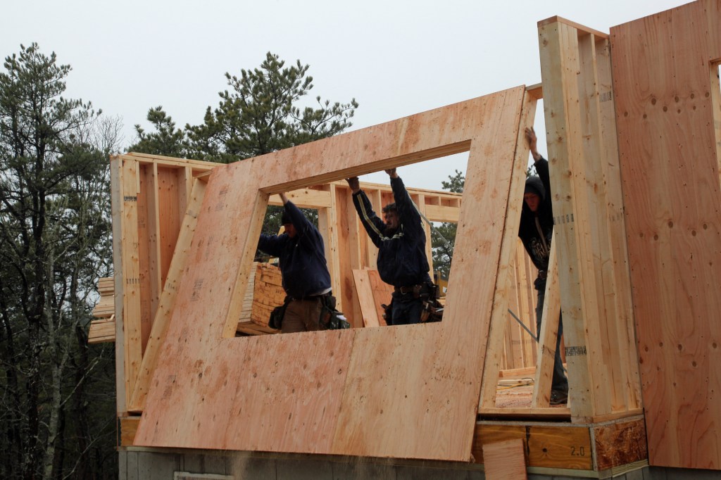

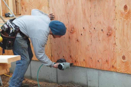

DEALING WITH THE RIMS

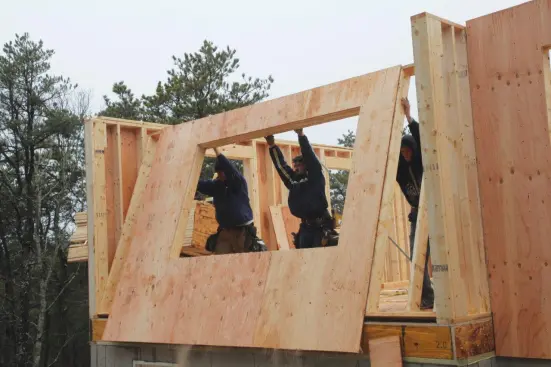

The sheathing is installed and trimmed to length so that the panels overlap the bottom plates, rim joist, and mudsill.
When the crew raises the wall, the sheathing at the bottom of the wall covers the rim joist.
The crew installs the sheathing so that the panels overlap and extend beyond the bottom plates, rim joist, and mudsill. After measuring to determine how much of that length is needed to cover the rim joist and mudsill, a worker snaps a chalk line and cuts off the excess sheathing with a circular saw. When the crew raises the wall, the sheathing at the bottom of the wall covers the rim joist. Once all the walls are in place, the crew nails the sheathing to the mudsills and rim joist to tie the wall framing to the floor framing.

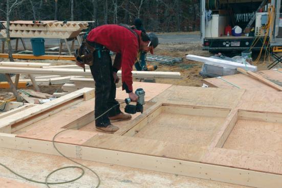

FILLING IN
Certain sections of the walls on this house were engineered to increase their racking strength. Placement of the sheets meant that small strips needed to be filled in after the walls were raised. Short jogs were also raised without sheathing and were filled in afterwards.
After raising a wall, make sure the sheathing has been nailed off at the mudsills and rim joist.
Certain wall sections on this house were engineered to increase racking strength with the sheathing sheets placed at designated stud positions. This sheet placement meant that small strips needed to be filled in after the walls were raised. Additionally, short jogs in the exterior wall were raised without sheathing and those areas were filled in afterwards. These sections overlap onto the corner studs to help tie adjacent walls together.
When all the sheathing has been nailed to the studs, a crew member goes around the perimeter of the house to make sure the sheathing is nailed to the mudsills and to the rim joist. Because of the infill sheathing sections, the crew installed housewrap after the walls were raised.

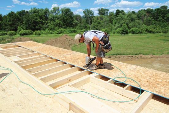

HORIZONTAL ORIENTATION

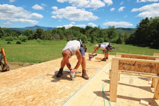

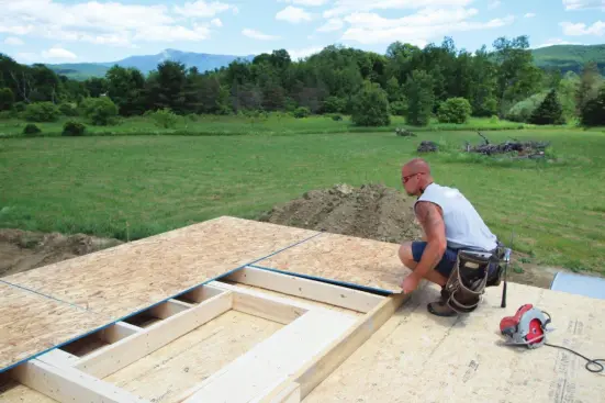

As with vertical orientation, the crew squares the wall frame first, then snaps a chalk line to guide the horizontal sheathing placement. With the studs visible beyond the edge of the first course, the crew can adjust the stud spacing to hold the studs straight as the sheathing is tacked in place.
After squaring the wall, the crew snaps a chalk line across the studs to guide sheathing placement.
With the layout marked on the sheathing, stud spacing can be tweaked to keep the studs straight.

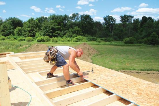

When nailing off the sheathing, avoid driving "shiners" (nails that miss the framing) or overdriving the fasteners.

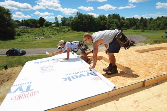

It's much easier to staple housewrap to the sheathing before raising the wall than afterward.
The second course begins with a half sheet so that the end seams are staggered between courses. One person cuts out the window openings with a router, as before, while another nails off the sheathing. The final step before raising the wall is stapling housewrap to the sheathing.
