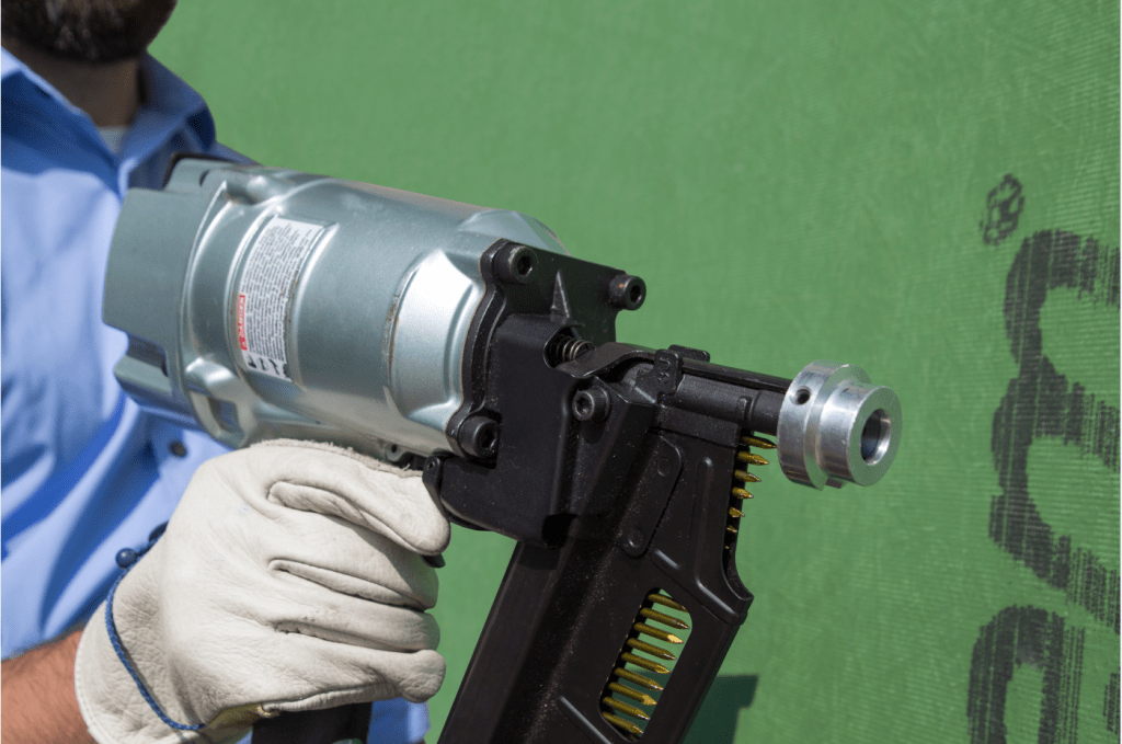

Two common mistakes people make when it comes to fastening sheathing panels are shiners and overdriven fasteners. When fasteners are countersunk into sheathing, the head is not flush with the panel surface, or water-resistant membrane in the case of ZIP System sheathing. This can cause a disruption in the surface area where tape is applied at the panel seams. To get the most out of ZIP SystemTM tape adhesive, keep the nails flush so the tape has a smooth surface to create a continuous, strong bond for locking out water and air.
Overdriven fasteners can happen because of inconsistency in the pressure used in nail guns. An easy fix is to install a “flush-mount” attachment or “collar” on the end of the gun. This adapter helps provide more consistent control over the distance between the nail and panel surface. Another option is to lower the pressure on the nail gun or install an in-line pressure regulator.
Shiners present a different risk. Missing too many studs with any structural panel reduces composite action—or, the combined strength of the frame and panels—and reduces the strength of the exterior. Plus, other subcontractors working inside the building can make the problem worse, which could mean a bigger penetration and possible path for water. To maintain the integrity of the built-in water-resistive membrane on ZIP System panels, drive shiners back out and seal them with ZIP SystemTM tape outside or ZIP System® liquid flash inside.
