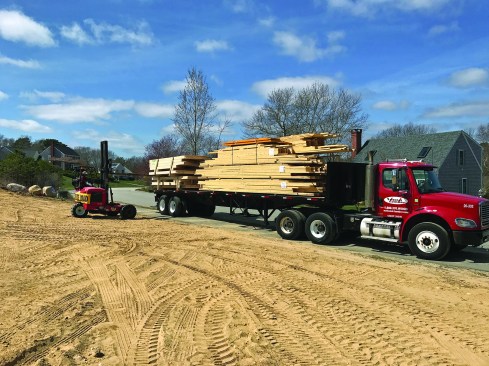

BMC’s ReadyFrame is one option. A builder hands a BMC supplier a set of framing plans and gets back an annotated set with letters and numbers added to each wall. The builder also gets a truckload of wall plates, jack studs (known by many framers as “trimmers”), cripples, and headers. “You now get everything precut, not just full-length studs,” explains Matt Risinger.

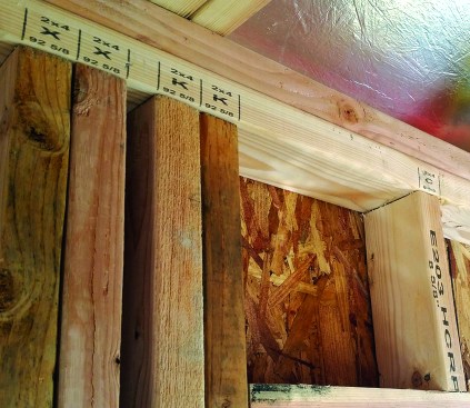

The components for each ReadyFrame wall are banded together and labeled to match the letters and numbers on the plans. Wall plates have layouts premarked with an inkjet printer. All the framer has to do is break the banding on the wall sets and assemble the pieces, pulling full-length precuts off a separate pallet. Austin, Texas-based builder Luke Mezger, who completed a number of ReadyFrame houses in the past year, describes in visceral terms the transformation of the jobsite when using ReadyFrame: “It’s an eerie sound on the jobsite when you’re used to a lot of saws going on; all you hear is nail guns going off.”
Not having to cut components increases the speed of assembling the frame (estimates range from 15% to as much as 40% faster, depending on the complexity of the wall). It’s also safer and simpler, involves zero cutting waste, and requires less skill. Often, the most experienced person on the crew will mark-out the plate layout while other workers cut the headers, jacks, and cripples. All of the time and the skill required to complete those steps accurately is completely removed.

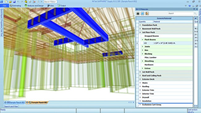

Another option is offered by MiTek’s Sapphire suite, a BIM-based system for designing and optimizing wood frames. According to Brian McCormick, MiTek’s director for residential supply chain, the software lays out all framing according to user-defined rules and produces a bill of materials as well as a cut list for the framer.
Ultimately, MiTek’s goal is to move builders toward using more manufactured components. The company already makes the saws used by many truss and panelized-housing plants, as well as the software used to run those plants. The company recently added a framing module to Sapphire that will generate a BIM model from a 2D set of plans drawn in another program, optimize the framing, and make sure it meets local building codes. The builder can then transmit the BIM model directly to a truss or panel manufacturer.

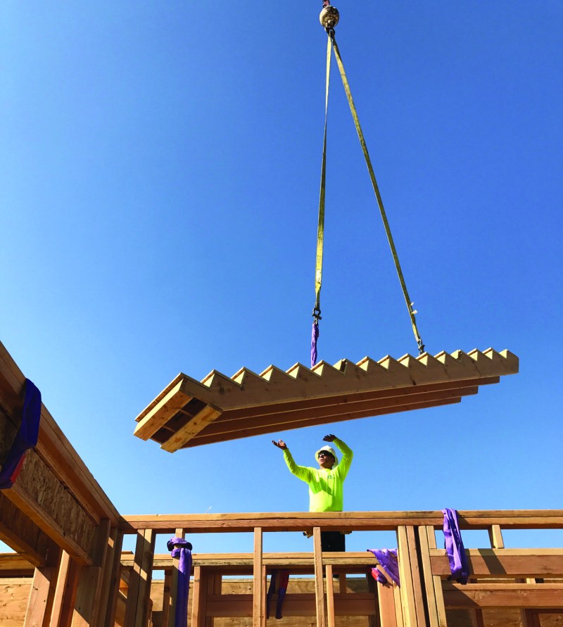

Rebooting the Framing Process
Some industry players believe that market forces and improved software will inevitably make manufactured housing the norm; as a result, they are putting design, engineering, and manufacturing under one roof.

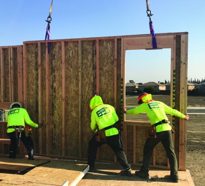

Those market forces include builders’ labor woes. “The industry’s problem isn’t a shortage of labor but a shortage of efficient processes,” insists Gerry McCaughey, CEO of Entekra, a Ripon, Calif., startup that serves the Bay Area, Sacramento, and Central Valley markets. “North America is the only place where people still build on site. It’s as if the last 100 years didn’t happen.” McCaughey is the former head of Ireland’s Century Homes, which he grew into one of Europe’s largest home manufacturers. He believes the off-site model can revolutionize the U.S. housing market the way Amazon revolutionized retail.
He also insists that Entekra is not just a panelizer. “We’re an engineering company. We don’t exist to make components but to look for the fastest, most efficient way to get the building up.” He says that his company’s process allows a builder to erect a house in one-third the time and with half the workers that conventional framing requires. “Our approach is so efficient that the existing labor force can deliver everything required.”
While Entekra employs human workers in its current plant, McCaughey refers to that as a pilot. He is raising capital for an automated operation with the type of robotic assembly lines used to make everything from pickup trucks to insulated glass units.
Entekra isn’t the only building manufacturer banking on robotics. Other North American companies running automated panel plants include Blueprint Robotics in Baltimore and HomeTechnology in Toronto. Blueprint is a new company targeting the custom-home market. It will deliver panels with insulation and mechanicals already installed.

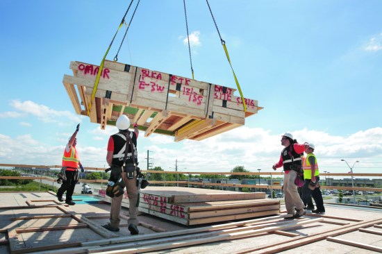

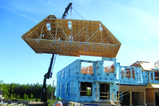

HomeTechnology, a subsidiary of Great Gulf, one of Toronto’s largest developers, has an automated factory that CEO Tad Putyra says is “run by automotive people.” It has been in operation since 2008. HomeTechnology will produce more than 3 million square feet of space this year, according to Putyra. One reason he thinks the time is ripe for this approach is that software has finally become sophisticated enough to address the manufacturing issues. That includes the need to resolve all structural and mechanical conflicts at the planning stage and the need to send precise instructions to the robots and CNC machines.
The ultimate vision is a world where a buyer sits down with a designer, draws a house, and orders it over the internet. “As a model for what will likely happen to the building industry, go to Home Depot and order a kitchen,” says Scott Hedges, the North American representative for Randek, a Swedish company that makes the automated machinery that HomeTechnology uses. “The designer draws the kitchen while the computer creates manufacturing instructions and transmits them to a cabinet company in another state.”
The high-tech manufacturing approach also promises to attract a more educated workforce to the home-building industry. “The jobs we are creating are mostly in design and engineering,” Putyra notes.
There remains the question of how to justify multimillion-dollar plant investments in an industry with such large swings in demand. One answer is the route taken by HomeTechnology, which manufactures a variety of structure types—single-family and multifamily homes as well as commercial structures—for its parent company as well as for other builders and developers. Another is what Freeport, Maine-based consultant George Casey, chair of the Home Innovation Alliance, describes as a step back in time. “If you only build for-sale homes, you ride a boom-and-bust roller coaster,” he says. “But if you look back 50 years, you see builders doing for-sale and for-rent. That removed some of the fluctuation.”
