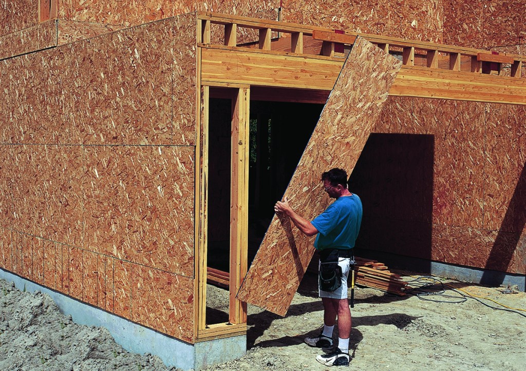

If a wall has only a few small openings, bracing it is easy. But large openings such as garage doors can complicate the problem. That’s why APA developed a code-recognized wall bracing method called the “portal frame,” which is commonly used to frame garage doors, but which you can also use as bracing at other door or window openings. In a portal frame, the header extends past the opening and is tied to its wall with overlapping plywood or OSB to stiffen the joint. The panels are attached to the wall studs and to the header with closely spaced nails, and the sill is bolted to the foundation.
Portal frames are easy to build on site, using common, familiar materials. They are easy to inspect for quality control, and they resist loads that may otherwise be neglected.

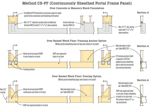

Click to enlarge
The continuously sheathed portal frame is allowed only if the builder has sheathed the entire braced wall line with plywood or OSB. But this method can be anchored to a wood floor frame using either overlapping sheathing or a properly detailed steel connector, allowing portal frames over basements and crawlspaces, or even on upper stories of multistory buildings. Wall-to-header attachment details are the same as for the portal frame with hold-downs (PFH; scroll down to see separate illustration, below), as drawn.
Tim Healey

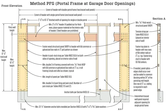

The building code allows three different types of portal frame: the CS-PF, or “continuously sheathed portal frame” (see illustration above), the PFG, or “portal frame garage” (see illustration, below), and the PFH, or “portal frame with hold-downs” (see illustration, further below). The anchoring methods at the base differ, but most other requirements are similar with only minor differences in fastening and WSP sheathing thickness.

Method PFG is commonly used to supply wall bracing at garage door openings. Supporting walls may be as narrow as 2 feet in length, depending on door-opening height, and each portal frame earns credit for braced panel length of 1.5 times its actual length. Any sheathing joint must be placed within 24 inches of the portal leg height, nailed to a common piece of blocking.

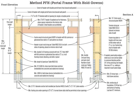

Built using correctly installed hold-downs of the code-specified capacity, the PFH can supply credit for greater bracing than a PFG. Supporting walls may be as narrow as 16 inches in length, and the assembly earns credit equivalent to a 48-inch ordinary braced wall panel. As with all portal frames, nail spacing specifications must be strictly followed.

As you consider bracing, one question is whether your building is continuously sheathed with wood structural panels. In the building code, this is bracing method “CS-WSP,” and it provides the greatest bracing capacity for either wind or seismic loads. With this method, you may also use the continuously sheathed portal frame (CS-PF), in which case the wall supporting your header could be as narrow as 16 inches, depending on wall height.
Unlike method PFG or method PFH, which have to be anchored to a concrete foundation, method CS-PF can be attached to a wood floor frame at the wall base. You can do that either on the first floor level (over a basement or crawlspace foundation), or even on the uppermost stories of a taller building. You can tie the base of the CS-PF to the wood floor framing either using an approved metal connector, or with properly nailed overlapping plywood. This makes the CS-PF suitable for second-story situations such as the sliding door for a deck, a large bay window, or just a wall with so many window openings that it’s hard to find enough sections of sheathed wall of the required minimum length to brace the structure adequately.

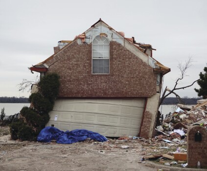

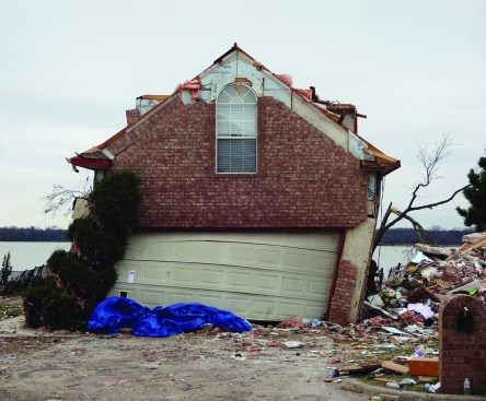

In what has become a classic failure mode, the upper corners of this garage have rotated, unable to withstand the lateral force of strong winds (note the bad location of the panel joint at the upper right hand corner).

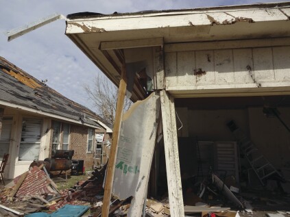

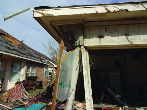

Another example shows the same pattern, as well as the failure of a garage door. In both cases, properly designed and installed portal frames would have likely improved the performance of the homes.
Why Poral Frames Matter
The photos above come from APA investigations of tornado damage. To an engineer, these failures are not surprising: Conventionally-built stud walls this narrow just can’t provide sufficient shear capacity to withstand the force of the expected wind on the side wall of the building. Properly constructed portal frames at these openings likely would have improved their performance.
The materials used in these examples aren’t as strong as plywood or OSB either. But on the back walls of these garages, where there are few openings (or no openings), that’s less important, because 8 feet of sheathed wall is enough to resist that shear. That’s why the rear walls of the garages didn’t experience the same failure as the front.
In these examples, even though these structures experienced very high wind speeds, extending the header all the way out over the flanking walls and tying the header to the walls to make a portal frame would have likely minimized the damage to the structure.

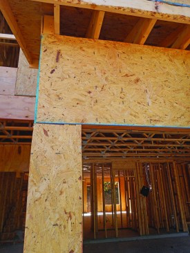

Breaking the structural panel joint below the header reduces the elbow’s resistance to rotation.

In the first photo, the sheathing joint occurs at the wall-to-header framing joint. This defeats the purpose of the portal frame; the joint between the wall and the header has to be rigid in order for the assembly to work. At the top corner of an opening, it’s important to carry the sheathing material all the way up the wall and across the header, to the top of the wall. (This same condition can be observed in the damaged garage where the joint has rotated in response to the lateral pressure of wind.)
If you need to have a joint in the sheathing, that joint should occur within 2 feet of the middle of the wall, as shown in the drawings . The wall in second photo above has a joint just one foot above the foundation—a mistake that weakens the assembly.

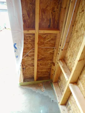

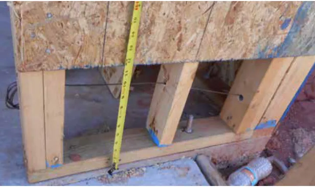

Locating anchor bolts away from the ends of the wall weakens the wall base’s resistance to overturning forces.

Anchoring details also matter. Each portal frame needs two anchor bolts, and they should be as close to the edges of the wall panel as it’s practical to place them (not both on one side, as seen in photo above). The anchor bolts should have 2-inch square plate washers and nuts, not round washers as shown in the photo here.
