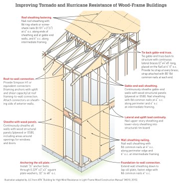

To survive high winds, a house needs a continuous load path; wind forces on the roof and walls have to be transmitted through those structures into the foundation below (see Improving Tornado and Hurricane Resistance of Wood-Frame Buildings, page 41). “A chain is only as strong as its weakest link,” Uher says. “So you have to have your sheathing attached to your roof supports properly, your roof supports attached to your wall properly, your wall properly framed and sheathed and nailed to transfer the loads between the walls and the floor. You have to have your floors connected together properly, your floors connected to your foundation properly, and then your foundation has to be properly sized. And wherever the weakest link is, that’s where the failure will occur. That doesn’t mean everything else is strong enough; it simply means that the load has found the weakest link in the chain.”
Photos in the APA report show examples of failure at all these connection points—even in homes at the storm’s edge, where damage to surrounding structures and vegetation was not extreme. In many cases, better construction could have saved homes.

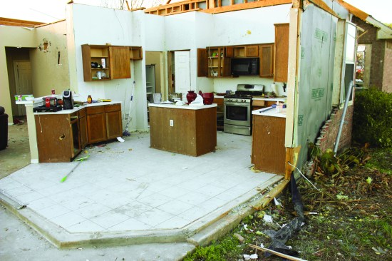

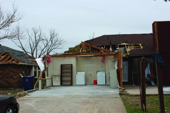

This kitchen wall was not fastened down with anchor bolts, but only with powder-actuated nails.
Wall Anchoring Failure
APA’s 2015 design guide, “Building for High Wind Resistance in Light Frame Wood Construction,” recommends that wall sills be attached to foundations using anchor bolts spaced at 32 inches to 48 inches o.c., connected with nuts over 3-inch washers. The guide calls for walls to be fully sheathed with wood structural panels (OSB or plywood), attached with 8d nails at 6 inches o.c. in the field and at 4 inches o.c. on the edges (including at the sill plate).

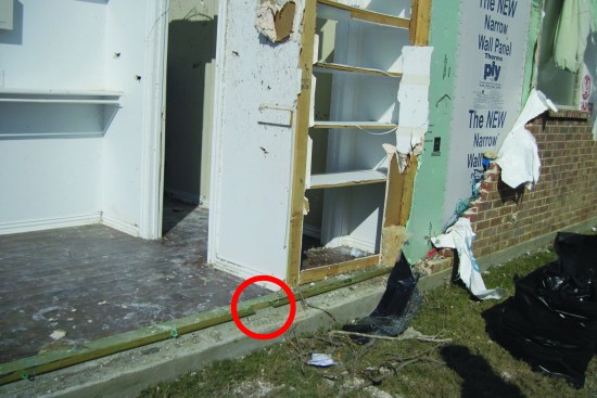

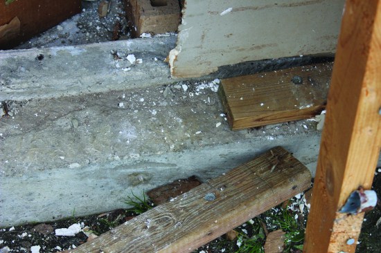

Nails used to fasten another detached wall plate do not appear to have penetrated the concrete when the plate was installed.

The 3-inch washers, Uher explains, help to prevent cross-grain bending of the sill plate, as well as preventing the sill plate from lifting off the foundation. In Texas, however, the APA team found many examples where anchor bolts weren’t even used—just powder-actuated nails (which didn’t always penetrate the concrete).
But even where sill plates were firmly attached to the foundation, says Uher, carpenters often neglected to nail the wall sheathing to the plate. That step is important, Uher says: “It really finalizes that connection.”

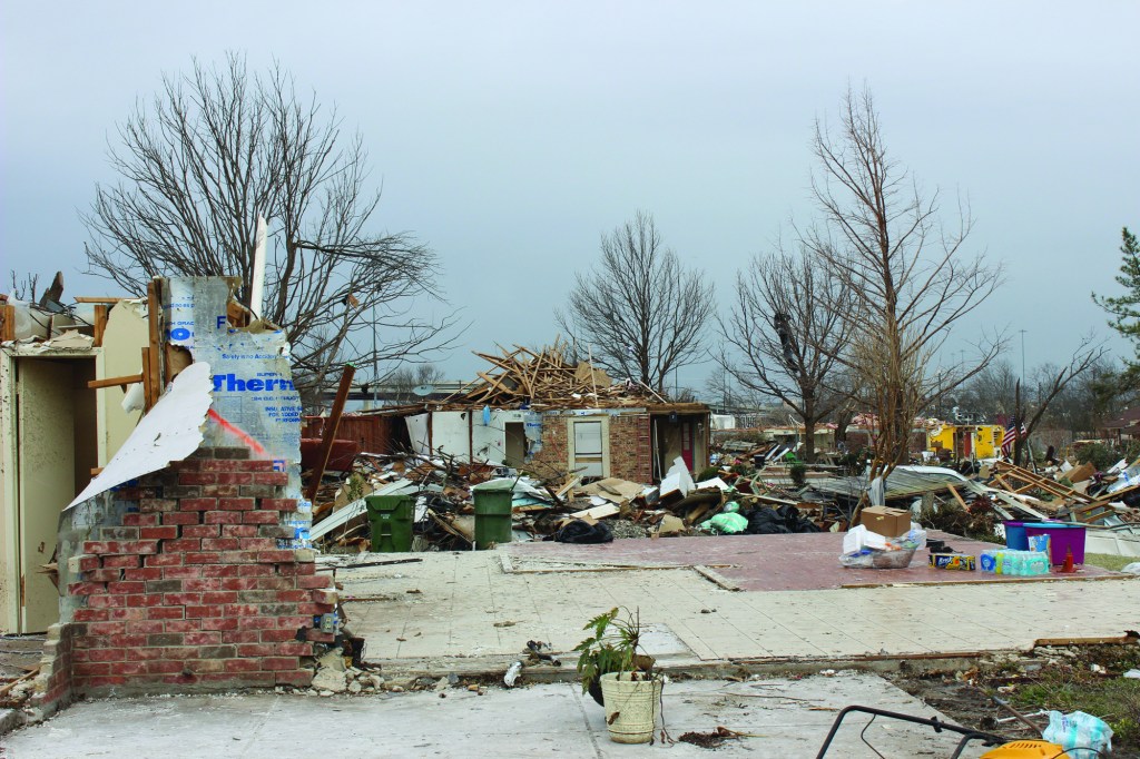

Failure of brick veneer exposed to relatively moderate wind speeds was common on the fringes of the tornado’s track.

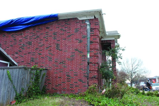

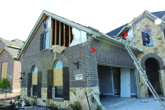

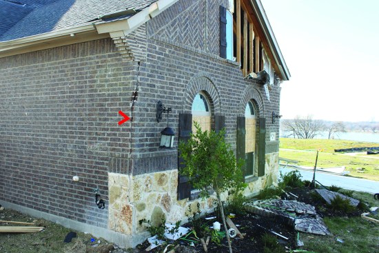

Vertical cracking in the brick at the corners of buildings was a typical failure—the result of lateral displacement, or “drift,” of stud walls built without sufficient bracing.
The images above show big cracks at wall corners. “We saw this repeated over and over again in Texas,” says Uher. “We think that it is due to lateral displacement. Brick is really brittle, and the lack of flexibility of brick can be a problem in these high wind speeds.” Structural wall bracing is important to maintain stiffness so that inflexible components such as brick cladding, doors, and windows will not be damaged by “drift” of the wall structure.

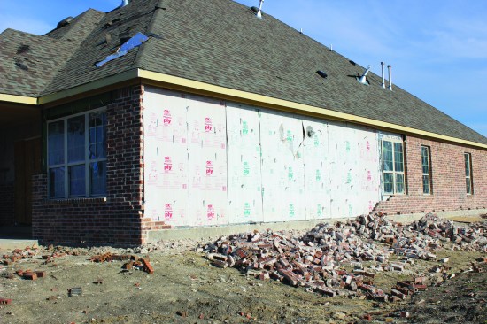

In one case, brick veneer and foil-faced foam sheathing were both blown off the gable wall—possibly after the wind breached the garage door.

Attachment of the brick cladding to the framed wall can also be a factor. The destructive wind action “was likely suction,” says Uher. “There were brick ties installed on the sheathing, but they were never installed into the brick. So somebody knew the code, and knew to put the brick ties on, but then they didn’t embed them into the mortar.”
APA recommends fully sheathing walls with wood structural panels (plywood or OSB), as backup protection for the building and contents in case cladding is lost. APA’s “Building for High Wind Resistance” guide notes, “The minute the siding is blown off the wall, the remainder of the wall left behind must be able to protect the contents of the structure from the wind and rain by itself.”

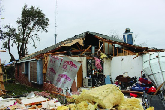

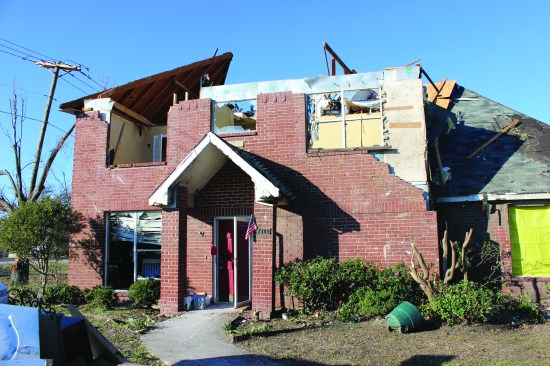

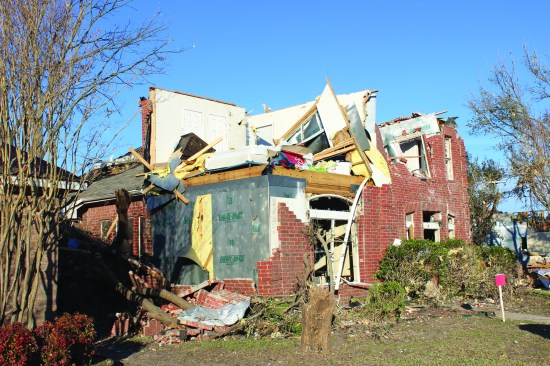

In the Garland-Rowlett tornado, homes suffered complete loss of the roof structure because wall plates weren’t tied to walls with well-nailed structural sheathing, or roof members weren’t securely fastened to wall plates.

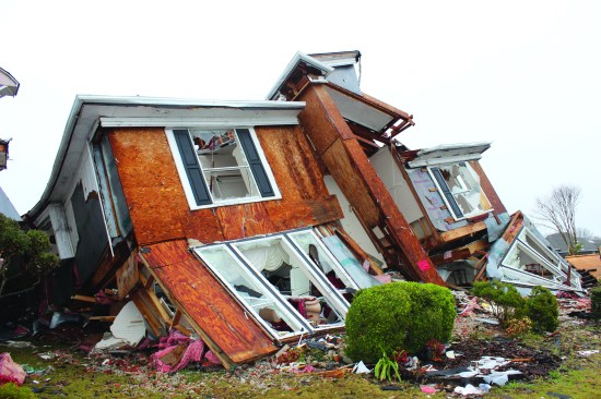

In other cases, inadequate connections between upper and lower stories resulted in the destruction of upper stories.

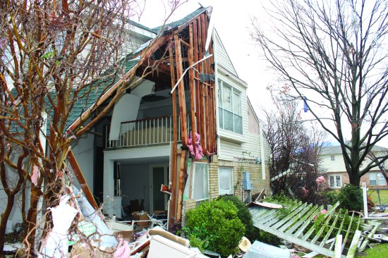

In one case (above), the wall for a two-story open space with a cathedral ceiling was framed as two walls, with a mid-height wall plate creating a “hinge” halfway up the wall. “Walls such as this should be designed using balloon framing or some other means of laterally bracing the wall,” says APA.

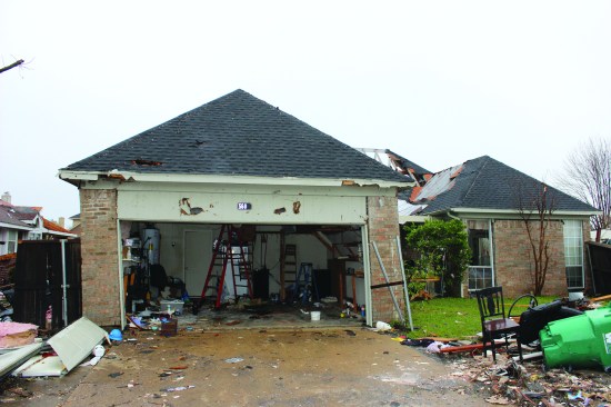

This garage door opening shows a classic racking failure that is also commonly seen in earthquakes.

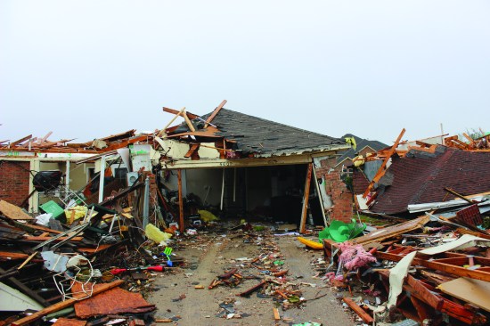

Similar racking of this garage door frame, plus catastrophic failure of the adjacent walls and roof—likely a result of the sudden pressurization of the building when the garage door was lost.
One code-allowed solution is to use a “portal frame” as prescribed in the International Residential Code (IRC), with a continuous header across the large opening, and heavily nailed wood structural panels tying the wall framing to the header—plus metal anchors tying the wall base to the foundation. (For more, see “The Portal Frame Option,” Aug/17)
But the garage door itself can also be a weak point. “Failure of a garage door pressurizes the inside of the house,” explains Uher. “Once the garage doors go, the wind is now not only on the outside of your house, but inside. You have suction on the roof, plus pressure from underneath. The pressures double, essentially—and then it’s typically a sudden failure of the roof.” One weak link can be the connection of the wall to the roof. “If that fails,” Uher says, “it allows both your walls to fall out and your roof to blow off.”
