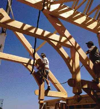

We’ve built trusses for rooms ranging from 16 by 20 feet all the way up to a 102-by-120-foot church sanctuary. Most of our jobs are closer to the small end; a 20-foot-wide by 30-foot-long room is typical.
Depending on budget, we may use fewer trusses spaced farther apart or more trusses closer together. Heavy trusses can generally be spaced up to 16 feet apart as long as they are joined with purlins at 4 feet on-center. In that case, the T&G ceiling boards would run parallel to the trusses, across the purlins. With closely spaced trusses, we run the ceiling boards perpendicular — rather than parallel — to the trusses.
Framing the walls in preparation for the trusses is straightforward. In a typical job, the GC builds standard 2×6 exterior walls to the designated height for supporting the truss bottom chord. Under each truss layout location, a post of ganged 2x6s carries the point load to the foundation below. On a wood-framed floor, the joist cavity below the post must also be blocked solid.
The “mini wall” can be built either before or after the trusses are set. If it’s done before, the builder leaves a 1/16-inch gap on either side so the truss can easily slide into position. If the trusses are made from seasoned or kiln-dried wood, the angled top plate of the mini wall can be flush with the top surface of the upper chord (rafter). If the timbers are green, I advise setting the angled plate about 3/8 inch lower for hardwood trusses and 3/16 inch lower for softwood.
We use Simpson ST6236 straps to tie the trusses to the sidewalls. After the trusses are in place, the purlins are dropped in place. If the purlin ends are dovetailed, they simply slide into their slots; if they have tenons on the ends, the trusses have to be spread slightly so that the purlins can be positioned. We use opposing come-alongs to spread the trusses. The purlins that die into the gable walls are set last.
Once the purlins are positioned and racked square, we nail diagonal 2x4s across the top to hold things true. Then we set the knee braces, which fit between the truss bottom chords and the ganged 2×6 posts. Because we like to join the braces to the posts with a pegged tenon, we give the general contractor a measurement down from the top plate as a “no nail” zone. That way we can drill and chisel the mortise without trashing our tools.
