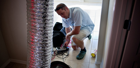

Earlier this year, the Building Performance Institute (BPI) introduced an entry level credential for Infiltration and Duct Leakage (IDL). According to BPI, this credential is going gangbusters. The reason: The 2012 and 2015 versions of the International Energy Conservation Code (IECC) have significantly stepped up requirements for limiting building air leakage and duct leakage. And while duct leakage testing was previously required under the 2009 code, gone now is the visual inspection option for verifying building air leakage. Blower door testing must be performed to verify air leakage limits. Training to achieve IDL Certification can teach you how to use a blower door and duct blower.
