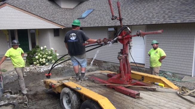

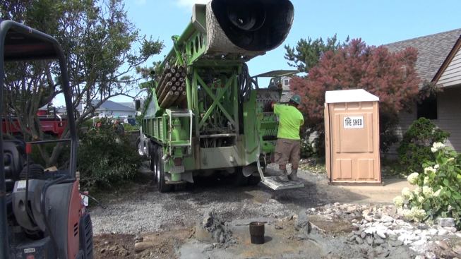

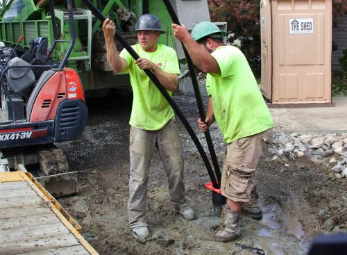

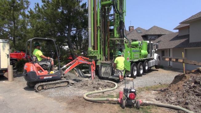

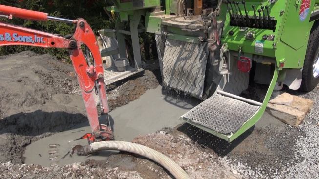

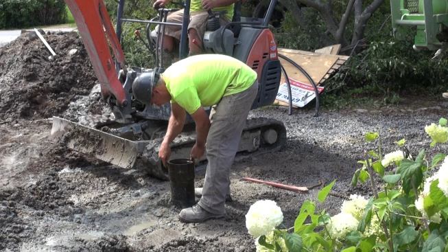

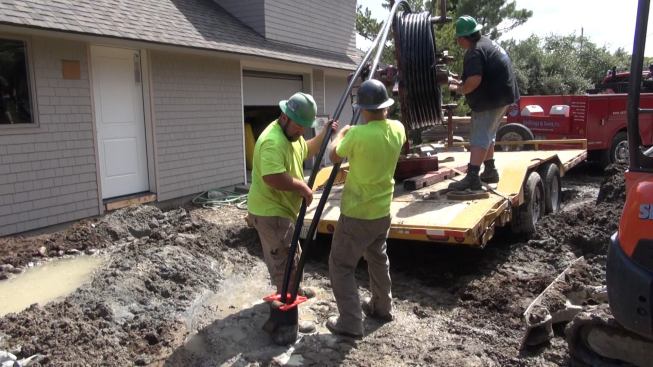

Coastal Connection will be following Thurman’s job in coming weeks. For a look at the drilling of the three wells for the ground loop, see the slideshow.
