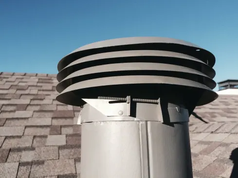

Both the original furnace and the new furnace were connected to Type-B vent to exhaust combustion gases up and out of the house. This commonly used metal vent has a double-wall construction with an insulating layer of air that allows it to be installed with tight clearances to combustible materials. Type-B vents are made by a variety of companies, each of which uses proprietary mechanical twist-and-lock connection joints between segments. These connections allow you to assemble separate lengths into a continuous vent quickly without using fasteners. Each company also makes a termination hood or vent cap that covers the vent after it exits through the roof. Exposed to the elements, the vent cap on this house’s furnace vent had been badly damaged during the hail storm, so the insurance company listed the cap for replacement in its scope of work.

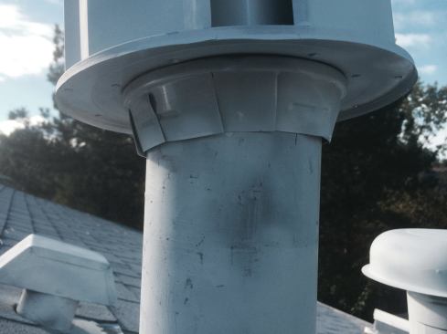

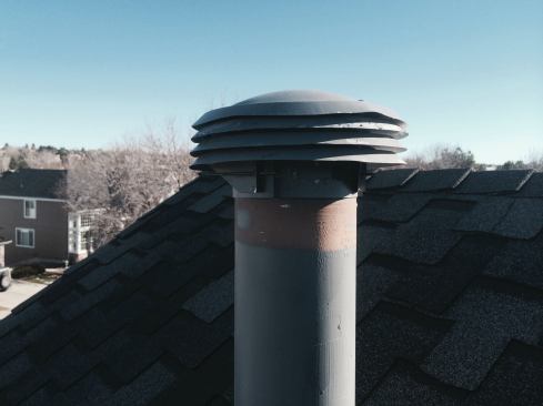

Matching a new roof cap to the specific manufacturer of an existing vent pipe is almost impossible on older homes because of the differences in the locking joints. So roofing contractors typically replace a damaged hood with a universal model that doesn’t connect with a twist connection but rather just slides over the end of the vent. To function properly, these replacement caps must be installed at the proper height above the end of the vent before being tightened in place with the integral clamp.
On this particular job, the cap had been pushed down too far over the vent, ultimately blocking off the top of the vent. With the vent blocked, the hot exhaust gases from the furnace could no longer escape, introducing carbon monoxide into the home. Then as these gases began to cool in the sections of vent that passed through the cold attic and outside air above the roof, moisture vapor in the gas condensed into liquid water inside the vent. This explained the moisture that the HVAC technician found in the vent, a red flag that was misread. The roof replacement had created a problem with the furnace venting, and as a result, the family was suffering from carbon monoxide poisoning.
Raising the cap and securing it at the proper level solved the problem of the condensation, which stopped the “leak.” But more importantly, it removed the source of carbon monoxide entering the home, and the family’s health improved immediately.

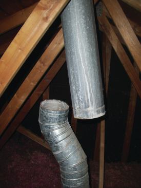

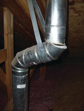

Besides installing the roof cap too low, another common mistake is accidentally turning the whole vent when removing a cap, instead of turning just the cap. Once the joints between the sections of pipe are no longer interlocked, the sections can disconnect inside the building—and reconnecting them is often impossible from the top of the roof. A sure sign of a disconnected joint is B-vent that moves horizontally in all directions on the roof instead of being rigid.

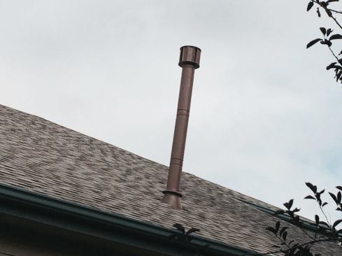

It is also common to see B-vent pipe that extends unusually high above the roof surface because of a nearby air inlet (like an evaporative cooler) or the adjacent sidewall of an upper floor. (Generally, vents must be at least 8 feet away from a wall or extend above it). In these cases, braces extending from the pipe down to the roof must be installed to provide lateral restraint. Without these braces, the vent is subject to movement and possible disconnection caused by wind. I’ve had to fail many roof replacement jobs where these braces were not reinstalled.
