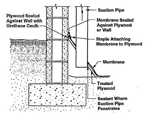

In new construction, there are easy solutions (see “Radon Venting—Do It During Construction or Add a Zero,” Energy Vanguard, 7/10/13). In existing homes it’s a little more complicated. The techniques that have been out there for a long time still rely on subslab depressurization (see “Radon Reduction Techniques for Existing Detached Houses,” EPA 10/93; PDF) This is obviously harder to accomplish once the slab has been poured. If no slab exists, a heavy plastic membrane can be installed over a dirt basement or crawlspace, and soil gases ventilated from under the membrane to the exterior. This is no small trick to do effectively, which makes it a relatively expensive procedure compared to air sealing by itself.
