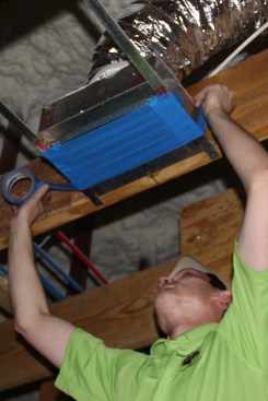

Technician Adam Hovis temporarily masks an energy recovery ventilator (ERV) outlet in preparation for a blower-door test.

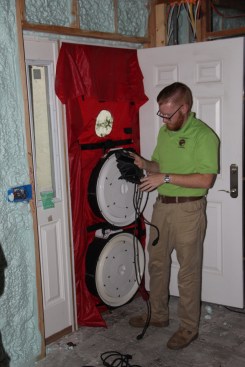

Technician Jack Hogan zeros the electronic manometer before the blower-door test.

I tell my builders that I want to be at the house with my blower-door rig as soon as we have an envelope to test. Ideally, we like to have the attic insulated with spray foam on the underside of the roof sheathing, so our ductwork can be in the conditioned space. And we want to test the home’s airtightness as soon as the roof is sprayed but before the walls are insulated—and before there’s any drywall loaded into the house to block our access to the walls.
At this point, we’re not trying to get a number for anybody’s checklist. We just want to find the leaks. So we tape up all the known holes: missing door knobs, dryer vents, bath vents, fireplaces, and the like. Then we crank up the blower door. When you depressurize the house to 100 pascals, you can hear the leaks—they howl.
It’s hard to get the pressure cranked down that low if the house is full of holes. But we’ve learned that air-sealing is iterative. The big leaks hide the small ones. So first you find and fix the big leaks, and then you go back through, with the higher air pressure working in your favor. Now the fans can do more, and the smaller leaks will start to reach out and touch you.

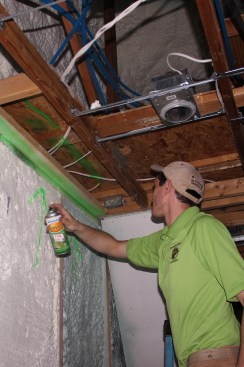

We like to run our test while the foam contractor is still on site. We flag issues using spray paint, and the foam guys come back in to hit the low spots and point-seal the leaks. Then we may take a second (and even a third) run through with a different color paint.

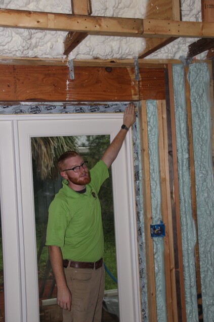

Hogan points out an air leak near the patio door.
Hovis marks a gap in the foam insulation for correction by the foam crew.

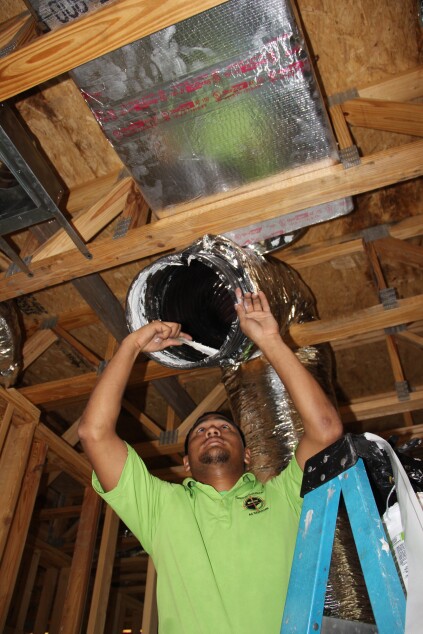

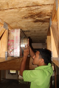

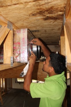

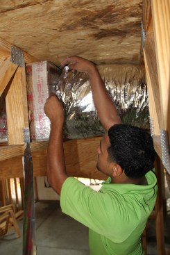

Installer Luis Ventura inserts a tap collar for a flex-duct connection to a duct board box.
Then he tape-seals the collar to the box.

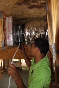

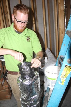

He butters the inner liner of the flex duct with mastic.

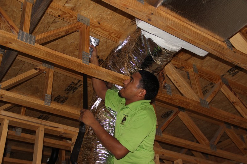

Then he slips the duct liner over the collar, and tightens a cable tie over the joint using a tensioner.
Finally, he tapes the flex duct outer liner to the box.

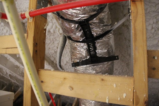

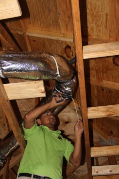

Ventura attaches a Hart and Cooley “Smart Flow Elbow” to ensure good airflow through a curved section of flex duct.
People may not care a lot, because they don’t spend much time in there doing laundry. But you’ve sacrificed air that is needed elsewhere, and created a comfort issue and sometimes even a noise issue in the laundry room. It’s better to use a 3-inch duct, not a 4-inch one, so that you can keep that chilled air backed up in the system for where it’s needed—like in the family room, the kitchen, or the southwest bedroom.

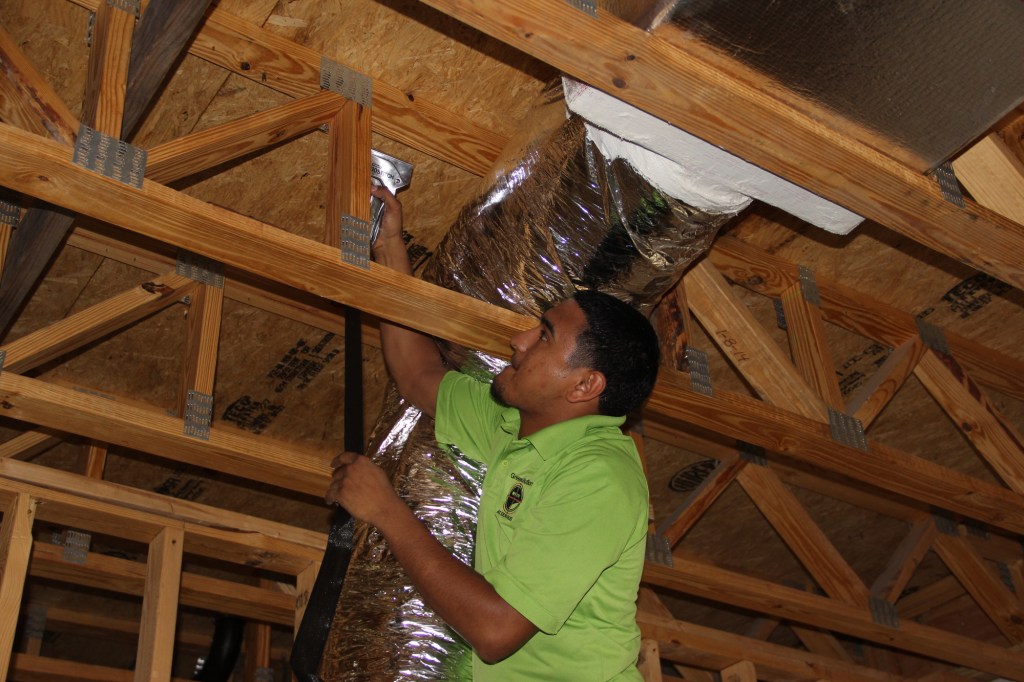

Like everyone else in our market, we use a box and flex-duct distribution system, because there isn’t the budget to run hard metal duct in a house. And flex duct works fine—as long as you install it correctly. But as with the roof insulation, quality control is what determines whether the duct system works the way it was designed to work.
So our installers are trained to fully stretch the duct out before they connect it, so that the steel wire coil in the duct doesn’t crumple inward and create friction in the air path. They know to support it properly, and to seal it carefully at every connection. We are also the only company I know of in our market using Smart Elbows from Hart and Cooley. This product is a plastic brace that supports and stiffens flex duct when it has to go around a bend, enforcing the proper radius and keeping the duct from folding in on itself.
Besides enforcing a smooth bend, the Smart Elbow helps to hold ducts away from obstructions.

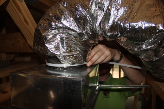

Hogan butters an inner liner with mastic.
He wraps a cable tie around the connection ...

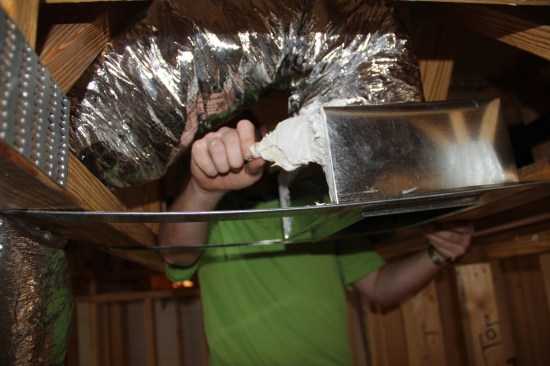

... and butters the seams of a register boot with mastic to ensure airtightness.

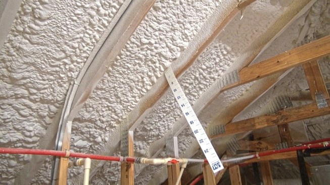

A preapplied paper ruler helps foam installers and inspectors verify application thickness.

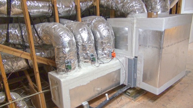

In this high-end system in an insulated attic, three zone supply ducts coming out of a distribution box are equipped with motor-controlled dampers.

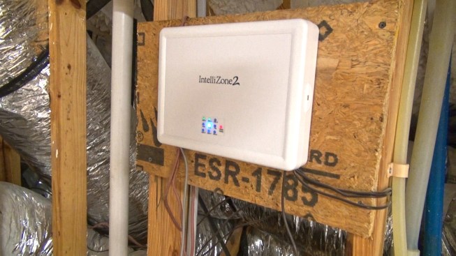

Illuminated LEDs on the control device indicate which zones are active.
