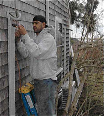

There’s also the issue of how to hide the refrigerant lines that run from the indoor to the outdoor unit. Antolick uses a product called Slim Duct. It’s basically a white vinyl channel that houses the lines. Depending on the type and color of the siding, the housing can look obvious, but it’s better than copper pipe. Duncklee uses white downspouts, to match those on the rest of the house. (Inside the house, the issues are the same as running plumbing pipe: Both lines run through closets and basements, where they won’t be seen.)

A worker joins two lengths of the tubing that will carry condensate away from the house.
