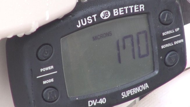

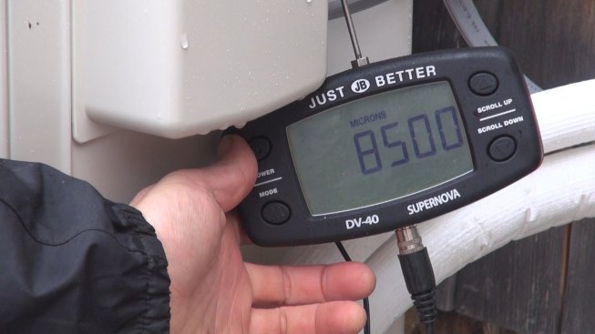

Willett helped develop the installation spec that Mitsubishi’s U.S. installers follow. “The most important part of that is what we call the vacuuming process,” Willett said. “Once we connect the lines, we use a triple evacuation, which is a process of pulling a vacuum, introducing nitrogen, pulling a vacuum a little bit deeper, reintroducing the nitrogen, and then pulling a vacuum as deep as 500 microns or less. That process eliminates all moisture, any air, any noncompressed gases from the copper lines before we introduce the refrigerant.”

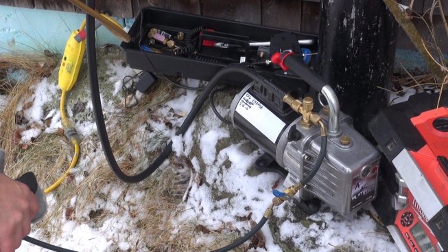

“After the N2 pressure test,” Mueller went on, “we follow Mitsubishi’s specifications for a triple-evacuation procedure, breaking the vacuum only with dry nitrogen between steps. The final evacuation needs to be able to pull a vac down to below 500 microns, and we often shoot for much lower if we can. This is important not only because it may expose pinhole leaks in the lineset, but also because getting all the moisture and contaminants out of the lineset before charging it with refrigerant is critical to maximizing performance and system longevity.”

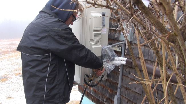

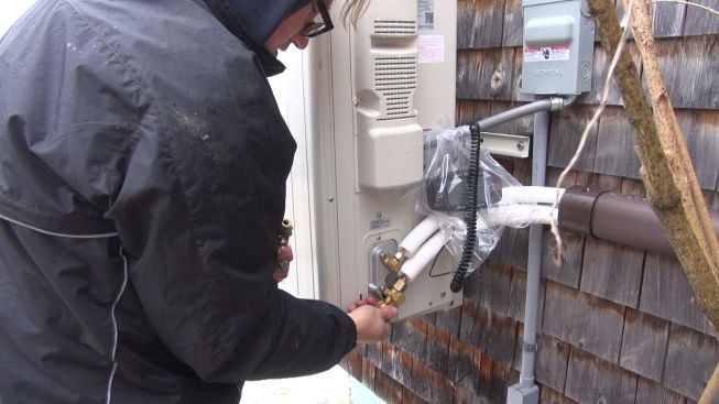

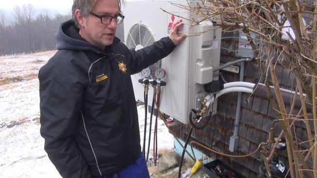

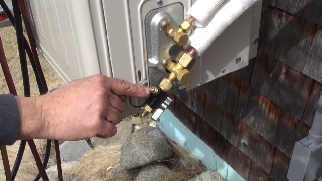

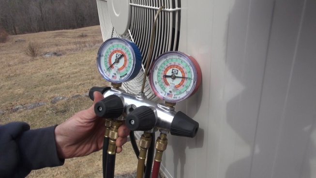

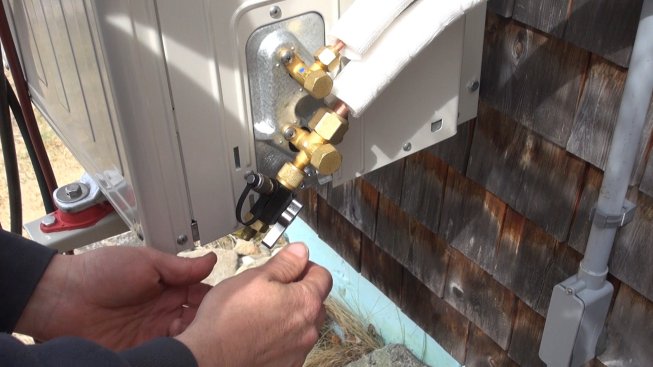

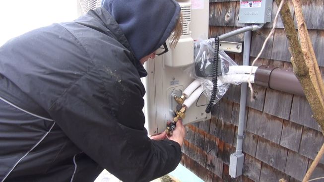

For a closer look, JLC visited a job site in rural Maine, where ReVision Energy techs Dave Ragsdale and Chris Blaisdell were wrapping up a Mitsubishi mini-split installation on an existing homestead [see slideshow]. “We have the refrigerant lines installed, and the indoor and outdoor unit have been connected,” Ragsdale said. “But before we can release the refrigerant into the lines from the outdoor unit, where it’s stored, we have to make sure that the lines will hold pressure and that it’s clean — that it doesn’t have any moisture in it at all. So the first step is to put 600 pounds of nitrogen in it. The reason to use such high pressure is because the working pressure of the unit is 450 psi at its highest. You obviously want to exceed that a little bit. And you can’t put that kind of pressure on the compressor, but you can put that pressure on the indoor coil and the line set itself.”
After pressurizing the system, Ragsdale left the pressure on overnight. The following morning he was satisfied that the system hadn’t leaked, so he evacuated and flushed the lines three times, following Mitsubishi’s protocol. Cold, rainy weather on that day made the process a little more difficult, Ragsdale explained: “When you apply a vacuum, you’re lowering the boiling point of the water in the lines, so you boil off moisture at much lower temperatures. But when it’s cold, it’s still hard to do that. In bad weather, it’s a little unpleasant and it takes a little longer.”
