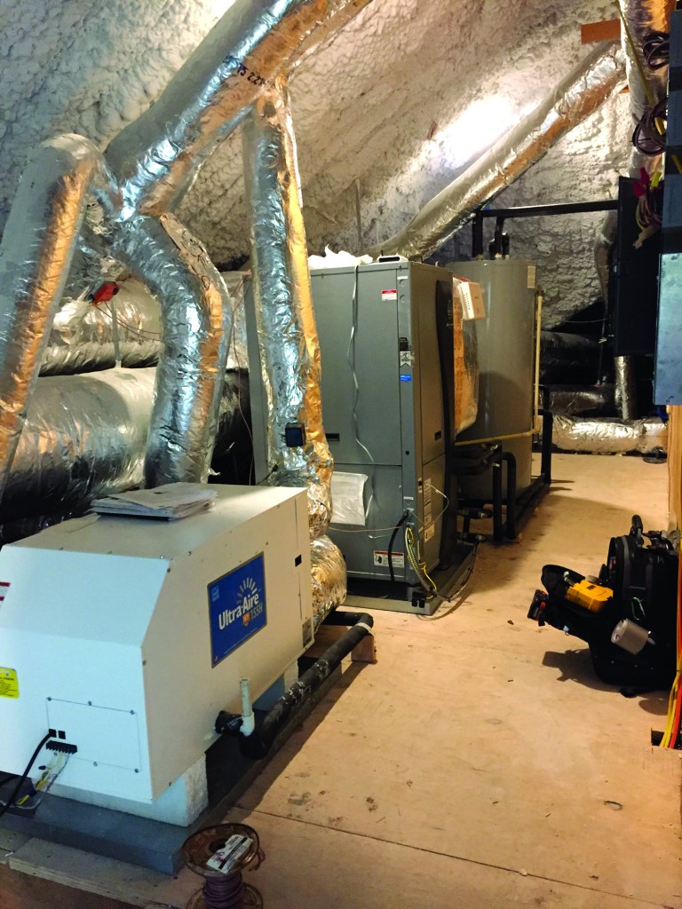

Above, an Ultra-Aire 155H dehumidifier sits next to the air handler of a 6-ton geothermal heat pump, part of a wholehouse climate-control system designed by Austin-based Positive Energy. The unit can remove as much as 155 pints of water at 7 pints per kWh and can effectively dehumidify air as cool as 56°F, according to Ultra-Aire specifications.

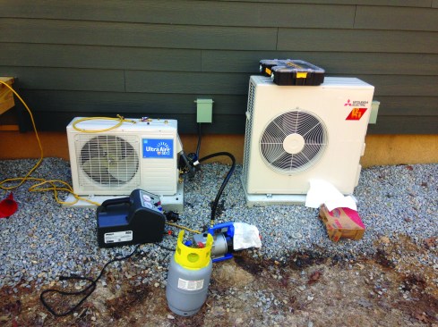

The Ultra-Aire SD12 split-system dehumidifier’s indoor coil.
And the outdoor coil. Both were installed at the home of David Treleven, who has since started working for Ultra-Aire maker Therma-Stor. The unit gives Treleven’s Passive House dry air without adding excess heat to the living space.

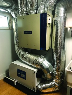

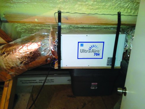

North Carolina builder Tom Dugan installed this Ultra-Aire 70H in his own home. The unit is rated at 70 pints per day and 5 pints per kWh. Dugan tied the dehumidifier into his already installed fan-powered air-mixing duct, which sends air from the home’s highest point down to the ground level.

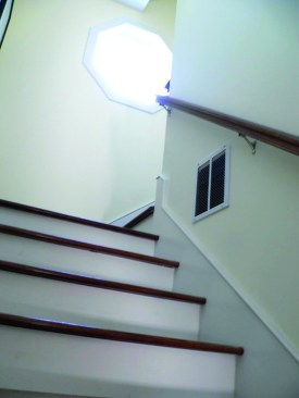

An always-on air-mixing fan pushes the dried air down to a basement stairwell register.

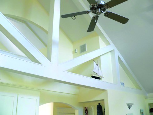

A grille at the peak of Dugan’s top-story living room draws air into the dehumidifier whenever the dehumidistat activates it.

But you don’t have to get that fancy. One step above the “dehumidifier in a closet” is the solution implemented by North Carolina builder Tom Dugan for his own home. Dugan’s house is cooled with a ducted mini-split, but he knew that hot, humid air would tend to accumulate at the open-plan building’s peak in the upstairs living room. So when he built the house, his HVAC contractor lined one stud bay in the home’s elevator shaft with metal duct material and installed a fan to pull air from the home’s peak down to the entry stairwell at ground level. Later, Dugan tied a dehumidifier into the air-mixing system, with a dehumidistat at the upper story’s peak. A simple meter on Dugan’s desk tells him the relative humidity in the living space. “We’ve had some really foggy cool mornings this spring,” Dugan told JLC in April. “It’s sitting right at 100% dew point and it’s 60°F outside, and right now my indoor humidity is 45%. I say, OK. I like that.”
