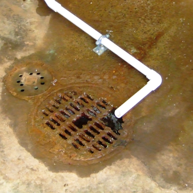

Acidic concentrate directed into a basement floor drain has eaten away the drain's brass grille. Under the floor, the condensate could be attacking cast-iron drain pipes or reinforced concrete.

Draining the condensate into house drains can damage the plumbing in older homes, explains home inspector Richard Aiello of I-Spy Home Inspections in Winthrop, Massachusetts. Even if cast-iron drains inside the house have been replaced with PVC plastic that the acid can’t harm, he points out, “often there are there still old cast-iron drain lines in the basement, and the drain line that runs from the trap or the clean-out to the street is cast-iron, and all the pipes that are in the ground outside under the street are old cast-iron pipes.” Furnace and boiler condensate can corrode those pipes. And if the fluid sits in a pipe or a trap and evaporates, it becomes even more concentrated — and more corrosive.
Plumbing codes everywhere address that issue. Before you can drain any corrosive liquid into the house drains, you have to neutralize it. The market has responded by creating an assortment of “condensate neutralizers” like the units Neutra-Safe sells — basically, acid-resistant plastic tubes filled with a mineral, typically limestone (calcium carbonate), that reacts with the nitrates in the effluent flowing through the tube and reduces the fluid’s acidity to milder levels. Below, Steamboat Springs, Colorado, plumbing and heating contractor Nathan Marshall demonstrates the simple process of attaching a neutralizer to the mechanical room wall and coupling it to the drain line (YouTube link: “Condensate Neutralizer Installation”).
