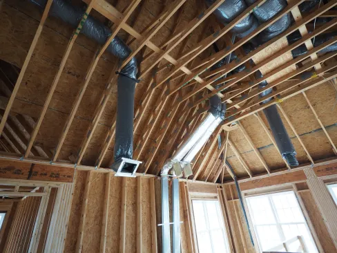

To make room, we’ve used two general approaches: The first is to select shallow ducts that leave lots of room for insulation behind them. The second is to use round ducts, which allow us to install adequate insulation over most of the area.
Rather than being run as one large rectangular duct, this line was split into two smaller round sections of flex duct that allowed ample closed-cell spray foam to be installed around them.
Split ’em up. A complex but sensible method is to split ducts up into multiple smaller sections so they fit better. We sometimes have rooms like a bathroom or closets situated on the opposite side of an attic from the HVAC equipment and have been directed to run ductwork over a cathedral ceiling to get there. Instead of a single 6×12 trunk duct that almost completely fills a 2×8 rafter bay, we can branch off early and put in four 5-inch round ducts. These are much easier to insulate above and around.
Round ducts. Even after a single round duct in a rafter bay is in place, we can usually insulate above and around it with spray foam or fibrous insulation. This simplifies scheduling and even allows more thickness of insulation above it compared with a larger rectangular duct. A competent designer needs to calculate the size of the new ducts, but that’s usually straightforward. Since, as noted, a single round duct usually doesn’t get in the way of installing insulation, it’s an optimal solution from a scheduling standpoint.
The flex duct on the left filled the whole cavity, leaving no room for condensation-controlling insulation above the duct and little room to install any insulation in the bay. The author’s HVAC partner switched it out for a section of metal duct (right). That made it possible to apply closed-cell spray foam between the duct and the sheathing and to fill the cavity, which provided condensation control on the duct.
We’ve found that flex duct can also make things even easier when we can use large enough sections; flex duct’s pre-applied insulation makes easy work for all involved.

Let ’em hang. Another method we often use is to leave the ducts out of the cavities until insulation is placed. Our HVAC folks are usually open to the idea of leaving ducts hanging down and connecting them later. Sometimes, our carpenters attach the three or four pre-positioned straps after insulation without requiring the duct people to make an additional trip to the jobsite.
Doug Horgan
At left in the photo above, a section of flex duct and boot has pre-attached straps for final installation after insulation. At right, two rigid metal ducts are similarly set up with straps that will be used to attach the duct after the cavities have been insulated
We can also avoid a special trip from the HVAC folks when we leave ducts disconnected in an accessible space and connect them later. Or the HVAC crew can make up some sections of hard pipe for us to place while we are insulating. Leaving ducts partially connected and hanging from the final straps makes it clear what will need to happen later. We haven’t had issues with the insulation folks not understanding and accidentally overfilling bays or anything like that. We do depend on our full-time supervision to manage these steps, but it’s simple enough that I would think it could work even without that.
