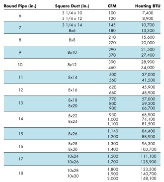

Duct Sizing
The size of supply and return registers (grilles), airflow capacity per room, and the size and layout of ductwork should all be determined by using ACCA Manual D (preferably, by using current computer software approved by the ACCA). Approximate sizing can be determined using the table below.

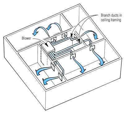

Supply Duct Layout
Common duct configurations include trunk-and-branch, radial, and perimeter loop (below).
Some systems may lay out most conveniently with a combination of these patterns.

While it is convenient to run supply ducts from a central plenum, the air must be at sufficient velocity to reach outside walls. Comfort will be compromised if the air drops prematurely or is directed downward by ceiling height variations.
However, outlets must throw air far enough to reach the wall opposite the register. Ceiling diffusers in the center of the room may be able to reach all walls of the room with a lower initial air velocity, in some cases providing better comfort and quieter operation.

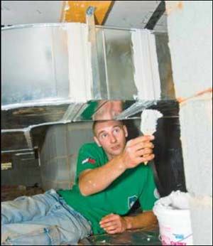

Sealing Duct Joints
The figure below calls out critical air-leakage points that must be sealed. Make sure surfaces are clean and dry before applying tape: Use cleaner/degreaser if dirt or oil is present.
In addition to sealing duct joints, seal register boxes to the wall or floor with caulk or mastic and any penetrations in the air handler or plenums.
Metal Duct Joints. Mechanically fasten, clean, and seal all metal-to-metal connections.
  • Use at least three equally spaced #8 screws to fasten round ducts that are up to 12 in. diameter, and five screws for ducts over 12 in. diameter.
  • Use at least one screw per side for square or rectangular ducts.
  • Crimp joints should have an overlap of at least 11/2 in.
  • Seal openings greater than 1/16 in. with mastic and mesh or butyl adhesive tape. Mastic alone, or UL 181A-listed duct-sealing tape, can be used for gaps smaller than 1/16 in.
  • Seal collar connections between ducts and boxes or plenums thoroughly with mastic or tape.
