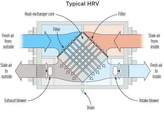

Meeting the standard calls for mechanical ventilation. In our climate, that means a heat-recovery ventilator (HRV), which pulls in fresh outdoor air while exhausting stale air from indoors. The streams pass, without mixing, through opposite sides of a heat-exchanger core, where up to 70 percent of the heat in the outgoing air is transferred to the incoming air. During the winter in this part of Alaska, outdoor air is very dry, so running the HRV also reduces indoor humidity.

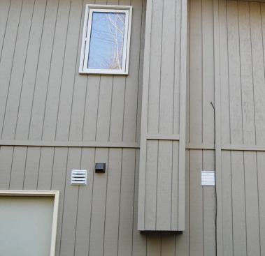

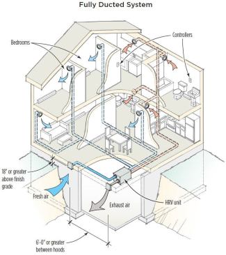

An HRV is connected to two pairs of ducts. The pair on the unconditioned side of the unit go to the exterior, with fresh air entering the building through one duct and stale air exiting through the other. The conditioned-side ducts are connected to indoor supply and exhaust registers throughout the house.
Exhaust and supply ducts. If a home has forced-air heat, the HRV unit’s warm-side ducts can feed in to the existing distribution system. But because most of the homes in our area have hydronic baseboard heat, we usually install fully ducted systems, in which every room in the house is connected to a dedicated duct. Habitable rooms, like bedrooms, living rooms, playrooms, and the like, each get a supply duct. Rooms where pollution is generated — kitchens, bathrooms, and laundry rooms — get exhaust ducts. Basements and unvented crawlspaces receive both supply and exhaust, while pantries and closets require no ventilation.

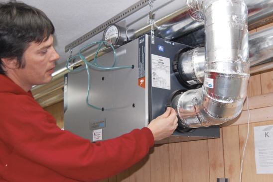

Finding a suitable place to install a retrofitted HRV can be a challenge. An HRV requires power, so it should be close to a 110-volt receptacle. We prefer to share a circuit that sees frequent use. That way, the homeowners will notice right away if the breaker trips. The unit must also be accessible for servicing and for periodic cleaning of the internal filters. To reduce energy loss and prevent freezing, it should be located in an area that stays above 50°F.
The HRV’s core produces a small amount of condensate that drains out through a fitting on the bottom of the housing. The installer connects the fitting to a drain hose that carries the condensate away. The IRC requires that this condensate be directed to “an approved place of disposal.” A floor drain, laundry sink, standpipe, or other open drain is our first choice. If that’s not possible, many inspectors will allow you to run condensate into a footing drain or French drain.
Utility room, garage, crawlspace. A utility room or laundry is an ideal location for an HRV — both are accessible conditioned space with power and a drain readily available. Closets can be an excellent option in new construction, but they’re less desirable for retrofits because they lack the necessary plumbing and electrical connections.
An attached garage can be a good place to install an HRV, provided it is at least partially conditioned. But extra care must be taken to completely seal the ductwork so that no auto exhaust or chemical fumes find their way into the house through the HRV. The 2009 IRC requires that both ducts in the garage and any ducts that penetrate the wall separating the garage from the dwelling must be made from 26-gauge or thicker sheet metal. Flex duct is not allowed, because it could burn through in a fire and allow smoke to enter the home.
We frequently install HRVs in unvented conditioned crawlspaces. The crawlspaces in this area are typically quite deep and provide easy access to joist bays and the stud bays in partition walls where we like to run our risers. By code, any equipment in an attic or crawlspace must be within 20 feet of the access point and have a level work area in front of it that is no less than 30 inches deep and wide. If the equipment is hung from the floor above, there must be at least 6 inches of clearance between the equipment and the ground.

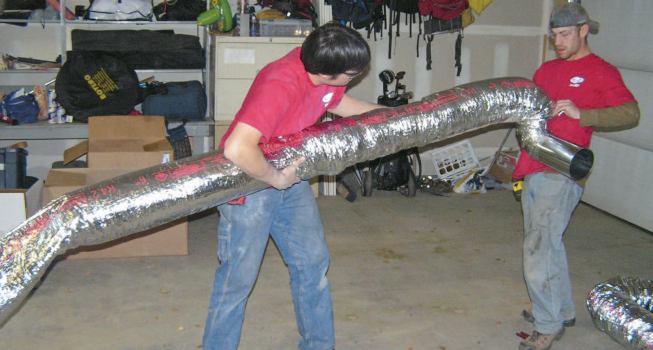

Easy on the flex duct. Flex duct impedes airflow, so we use smooth metal duct for the warm-side ducts wherever we can. However, difficult transitions in retrofit work sometimes force us to use short sections of noninsulated flex duct. Using a short section of flex duct between the metal ductwork and the HRV itself can also be a good way to dampen vibration.
Warm-side ducts need not be insulated except where they pass through unconditioned space. Cold-side ducts, on the other hand, must be insulated to save energy and prevent condensation in and on the ductwork. We typically use insulated flex duct for cold-side ducts and compensate for its effect on airflow by keeping the cold-side runs as short as possible. If the HRV is in the garage — where flex duct isn’t permitted — we use smooth metal duct covered by an insulating jacket.
