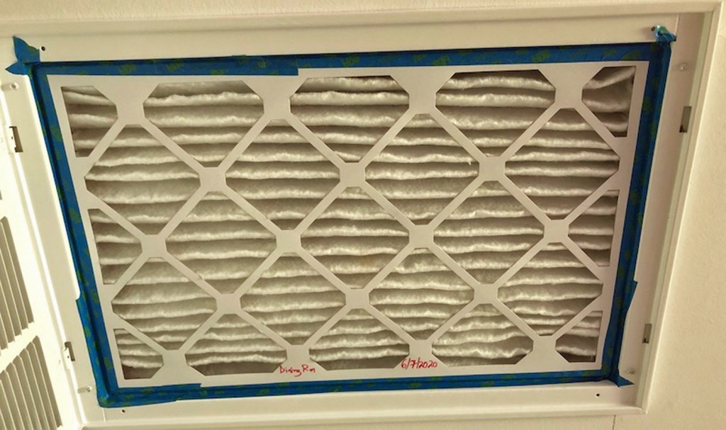

This 16x25 MERV-13 filter in a ceiling filter grille keeps the resistance low and the indoor air quality high.

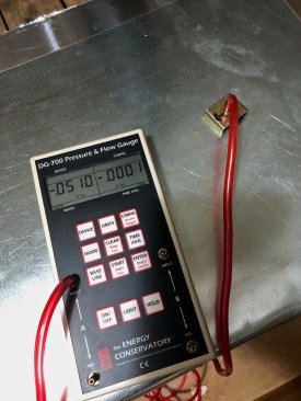

Filter pressure drop. This measurement is also done with a manometer, but you measure the pressure difference across the filter only. The Air Conditioning Contractors of America (ACCA) recommends 0.1 i.w.c. or less, but many high-MERV filters have much higher pressure drops. A study in California found that systems where a 1-inch fiberglass filter was replaced with a 1-inch pleated filter averaged 0.28 i.w.c. of pressure drop. For a system that needs to stay below 0.5 i.w.c., that can be a problem because the filter by itself is using up half of the pressure to move the air through the duct system.
The pressure drop (0.0510 i.w.c.) across the filter shown on the previous page is about half the maximum pressure drop recommended by the ACCA (0.1 i.w.c.).

I like to size each of the filter grilles for 400 to 500 cfm of airflow. That makes the required filter size, using the rule of thumb above, 2 to 2.5 square feet. Common filter sizes with that face area are 12×24 and 14×25. I like to go even bigger when possible and use 16×25 or 20×20 filters.
Remember, 2 square feet per ton is the smallest filter you want to use if you’re going for really good filtration with low pressure drop. Using a larger filter reduces the face velocity and pressure drop even more. I put three 16×25 filters in my house, each filtering about 300 cfm. That works out to about 3.7 square feet per ton and a face velocity of about 100 feet per minute.

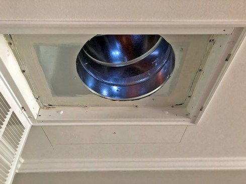

One mistake I made with my house was not detailing what happens on the reverse side of the filter. The installers put the filter grilles in the ceiling and then screwed a piece of sheet metal directly to the back. The 14-inch round return duct then was attached at the center of that sheet metal backing. The problem with this configuration is that there’s almost no space between the 2-inch-thick filter and the sheet metal backing. The result is unnecessary turbulence and a higher pressure drop.
A shallow return (above) filter grille box results in a higher pressure drop across the filter. Replacing it with a deeper box (right) behind the filter succeeded in reducing the filter pressure drop by 30%.
When I added a bigger box behind the filter grilles, I was able to reduce the pressure drop by about 30% (see photos, above). With this arrangement, my filter pressure drops are all less than 0.06 i.w.c. And remember, this is with MERV-13 filters!
