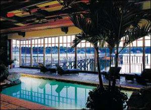

The results of such persistent research pay off. At least that's what West Palm Beach, Fla., architect Sam Rosenberg found when he took on the renovation of a 10,000-square-foot home in Manhasset, N.Y. A former seaplane hangar, the home is perched on the edge of a granite seawall, with a tall A-frame roof that faces the ocean and encloses a multi-use great room with a fitness area and swimming pool.
Rosenberg says that his first design called for enclosing the 50-foot-wide by 10-foot-tall opening beneath the A-frame with a custom-built glass and wood-framed wall. But the cost was too high even for this home's wealthy owners. Instead, he found a movable sunroom made by Roll-A-Cover International in Bethany, Conn., that had been on the market for three years. This product has 6-foot-wide sections that slide open from the center and stack on top of one another at either end of the opening. Not only did Rosenberg save a lot of money, but he believes the quality of the end product is better than what he could have had built on site. "Because the frame is made from aluminum, it has very little bulk to block the view. You can look out from the fitness room, across the pool, to the ocean view in winter." And in summer, the homeowners can turn the space into an outdoor room. When severe storms blow in from the Atlantic, the stacked sections can be strapped together and the sill bolted down with pegs that fit into sleeves embedded in the concrete deck.
Even on a high-end project, budget is a deciding factor. The architect saved a lot of money on this Long Island house by using the Roll-A-Cover product on the end of the house facing the ocean rather than custom-building a sunroom. According to the manufacturer, a system like this will cost $90 to $100 per square foot of floor area beneath the horizontal glazing.
