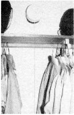

What looks like a closet light is actually a through-the-wall fresh air
inlet. The pull cord opens the vent as needed for intake control.
What looks like a closet light is actually a through-the-wall fresh air inlet. The pull cord opens the vent as needed for intake control.
Through-the-wall vents (sold by American Aldes, 4537 Northgate Ct., Sarasota, FL 34234; 813/351-3441 and Therma-Stor Products Group, PO Box 8050, Madison, WI 53708; 800/533-7533) offer the simplest, lowest- cost solution. These have adjustable openings designed to admit from 5 to 20 cfm quietly and without drafts. Some have humidity sensors that increase the airflow opening as indoor humidity rises. In most cases, through-the-wall vents offer the most cost-effective fresh air intake.

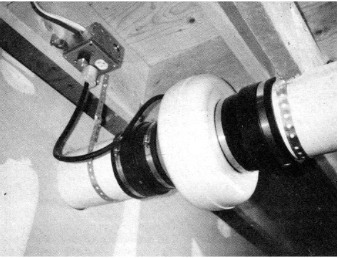

This single-port in-line fan, made by Fantech, is quiet, fairly inexpensive, and powerful enough to exhaust most three-bedroom, two-bathroom houses. The rubber boots on either side dampen the fan noise; the fan is light enough that simple metal straps easily support it from the joists.
In these systems, the single fan is hung from joists in the basement, crawl space, or (as a last resort) attic. The fan is fed by a single duct into which are channeled stale air ducts from the kitchen, all baths, the laundry, and any other odor or moisture producing rooms. The fan pulls exhaust air from these rooms and ejects it through a wall terminal equipped with a backdraft damper (a good 6-inch damper is made by Jenn- Air, 3035 Shadeland Ave., Indianapolis, IN 46226-0901; 317/545- 2271). I avoid attic locations whenever possible, because the chimney effect sends warm house air up the ducts, and also because frost may form in the frigid attic ductwork.
This single remote fan replaces any individual bath fans, but does not replace the kitchen range hood, which is still needed. Its principal advantage over the range hood or upgraded bath fan is that the remote mounting results in a quieter system, and one fan can serve multiple bathrooms. If the fan is adequately oversized, it can also handle a bath or laundry added later. The only additional cost would be for ductwork and a grille.
These systems, along with throughthe- wall vents or other fresh-air intake, can provide integrated, controlled whole-house ventilation for moderately sized houses — say, 1,500 to 3,500 square feet. They require sound planning and some running around to collect materials and components. But since the materials are fairly inexpensive as long as the ductwork is not too complex, the installed cost is usually lower than the third option, a multiport exhaust fan package complete from the manufacturer.

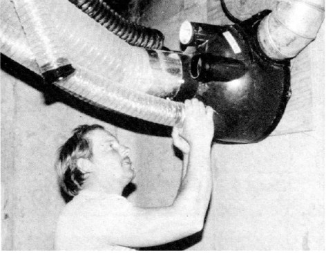

An Aldes multiport fan lagged to concrete. Large flexible ducting completes the kitchen run; the smaller ones come from baths. The galvanized duct is the exhaust to outdoors. Such systems, which can exhaust several rooms, can also be suspended by wire in either attic or basement installations.
Central, Multiport Systems These fan systems can be mounted in the basement, crawl space, or attic. The multiple stale air connections typically include a 6-inch connection for the kitchen and 3-inch or 4-inch ones for the baths and laundry. Most have twospeed fans and integrally mounted controls. Often the low speed is continuous or timer-controlled, and the high speed is an occupant-selected boost to clear the kitchen or bath. American Aldes, Fantech, and Therma- Stor Products all sell complete systems, including fans, controls, some ductwork, grilles, and wall jacks.
The fans alone are $200 to $300; complete systems start at around $500 (materials only). You pay more for one of these systems, but if you want to save the time of rounding up separate components, want to have the assurance of manufacturer support, or need to vent more than three or four spaces, it may be your best option.

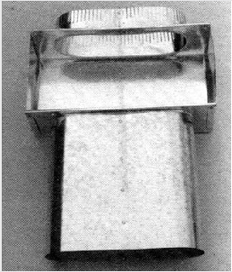

I recently came across a product that looks promising: galvanized oval ductwork made by Southwark (16th St. and Washington Ave., Philadelphia, PA 19146; 800/523- 1052). It comes in what the company calls 5-inch, 6-inch, and 7-inch sizes; these are basically what you’d get if you slightly flattened round ductwork of those same dimensions to fit them into a 2x4 wall. This flattening somewhat reduces the cross section and flow capacity.
This stackhead with collar, made by Southwark, allows you to vent
stacked baths with a single duct run.
This stackhead with collar, made by Southwark, allows you to vent stacked baths with a single duct run.
The company also makes fittings that make putting a ductwork system together easier. Their No. 150 stackhead with collar, for instance, enables you to easily vent two stacked baths with one riser. For faster assembly, the ductwork comes in 100-inch lengths (as opposed to the 30-inch lengths common in rectangular ductwork).
There are two basic options to mounting the fan: You can attach it to plywood lagged to a concrete wall; or you can suspend it from framing, with ductwork runs on either side. I usually do the latter. The important thing is to isolate the fan’s vibration from the building’s structure and the ductwork.
Rubber boots such as those shown help reduce vibration and noise when attaching PVC pipe to fan housings. They are available from major suppliers, and come in sizes that let you step up or down from one duct diameter to another. They attach with standard hose clamps.
Transmitted fan noise can be a problem in very short duct runs. In these situations I like to use 4 to 6 feet of insulated flexible duct — called “flex duct” — on either side of the fan. This really quiets a system down. Be careful to hang flex duct so that it doesn’t have any kinks, which drastically reduce airflow.
If you use flex duct, you might want to opt for a fan that has hanging brackets attached, as shown in the photograph; this will make it easier to hang the fan. But you can still use one of the round, in-line centrifugal fans (such as a Rosenberg or Fantech), attaching the fan to the joists with plastic or rubber straps.

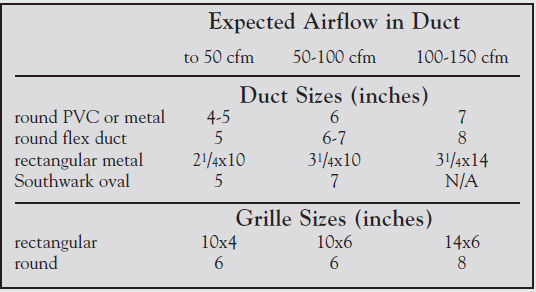

Sizing Ductwork
Size the ductwork according to the airflow it will carry. The table below shows my rules of thumb for ductwork as well as stale air grilles.
If you have trouble deciding between two sizes, use the larger one, as it will permit higher airflow. If your duct runs are long (over 40 feet or so), have more than two turns in them, or number more than three, it might be worthwhile to hire an engineer or systems designer to make sure everything is sized correctly
