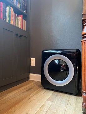

In terms of function, air cleaners are simple machines and typically have just two key elements: a fan and a filter. Like a miniature forced-air furnace without any heating (or cooling), they simply pull air into a housing and push it back out through a filter to capture some level of particulate—nothing more. The level of filtration varies by unit but like any range hood or bath fan, these small units can filter the air in a localized area only. The limitation on the volume they clean or “scrub” is a function of their size (filter surface area with fan strength) and location (the air they can access).
A wide variety of small filter fans have inundated the consumer market.
Most of these "air cleaners" have too small a filter area and too little airflow to effectively clean indoor air except in small, localized areas.
The typical interior of a home allows for communication of air from one room to the next through hallways and under and around closed doors, and from one floor to another. But despite these pathways, most existing homes have relatively little air circulation without the use of central air handlers and distribution ductwork. As a result, these tiny, localized air scrubbers have limited reach, and unlike with a Corsi-Rosenthal Box, which has a larger filter surface area and decent airflow, you need multiple units to handle multiple rooms.

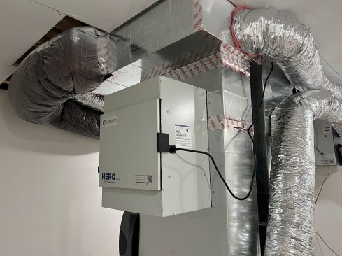

There are two methods for installing a Hero with forced-air duct systems, and we’ve used them both, for different mechanical room sizes. The fast and simple way involves cutting two rectangular openings on the side of the vertical return duct before it turns and enters the air handler. The back of the Hero has two corresponding ports, the top inlet and the bottom outlet, which have heavy-gauge-metal tabs that fold out and wrap into the rectangular openings you cut—pretty elementary metal work that requires only a pair of good snips, gloves, and, if you’re fancy, a nice set of hand seamers to dress up and reinforce the openings. Gasket material is provided for sealing the back of the unit to the ductwork, and the folded metal is backed up with screws to secure the installation. Fantech recommends this installation method along with having the fan on the air handler set to run continuously to maximize filtration and to eliminate the possibility of the air short cycling. We find this approach works great for small mechanical rooms that can’t accommodate the additional ductwork required for our preferred installation method, which provides more separation between intake and discharge.
When an existing air handler is used, the simplest way to mount the Fantech HS300 is on the side of the vertical return duct before it turns and enters the air handler (above). Alternatively, knockouts in the filter’s housing allow the unit to be mounted farther from the air handler using 8-inch flexible ducts, as shown at right. This not only gets it out of the way but also helps limit sound transfer.
This second, preferred method makes use of a couple of 8-inch round knockouts—one at the top and one at the bottom of the unit—to connect the Hero to the return via collars and ductwork. This gives us flexibility to locate the unit farther from the air handler and potentially more out of the way, as well as limiting sound transfer from the already very quiet fan. By pulling the 8-inch inlet farther up the return trunk and discharging the filtered air through a separate 8-inch line into the return just before it enters the air handler, we believe we are eliminating any potential for short cycling even if the occupant turns off the continuous operation setting on the air-handler fan. There’s little discernible noise from the Hero’s fan thanks to the robust gaskets and heavy rubber insulation on the filter and fan access door, but the inside of the unit obviously is open to the air duct, so the low-level sound from the fan does travel into the ducts and communicate throughout the house. Locating the appliance remotely rather than hanging it from the return duct prevents the sound vibration from transferring into the duct, and installing flex duct from the Hero further reduces the sound.

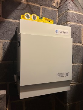

In addition to the methods above that use the existing ductwork and air handler, a “stand alone system” option in the Fantech instructions allows the unit to be mounted in a basement or attic with dedicated 8-inch supply and return ducts to serve localized areas.
The Fantech Hero HS300 offers “3 stage filtration,” which includes a carbon prefilter that reportedly captures 90% of particles between 3 to 10 microns, as well as a HEPA filter to capture 99.97% of particles .3 microns and larger.
The unit can be installed as a stand‑alone unit in an attic or basement with 8-inch supply and return ducts to serve the main living space.
If mounted in an attic, the unit must run continuously to prevent condensation in the ductwork at temperatures below freezing. Reportedly maintenance free and “permanently lubricated,” the motors are guaranteed for seven years, and the remaining components for five years. Recommendations are to change the prefilter every three to six months and the HEPA filter every two to five years. We typically leave homeowners with a replacement prefilter on install and suggest they order new replacements for both filters when they need to install the prefilter we supplied. Available for about $450 online, these Fantech HS300 Hero whole-house HEPA filtration units are more expensive than a Corsi-Rosenthal box but much quieter and far more aesthetically pleasing. I believe that with the integration with the ductwork in our clients’ homes, they are an extremely effective solution to filtration, and we’re making them as standard in our homes as ERVs and dedicated dehumidifiers.
