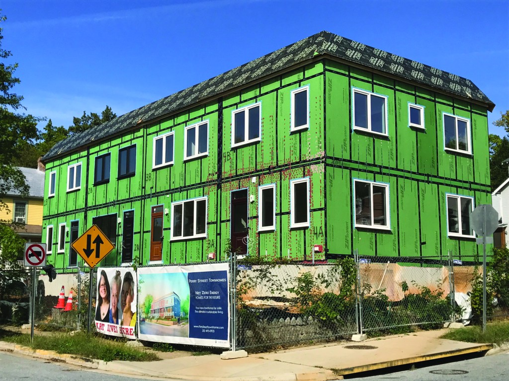

This high-performance townhouse project, although precertified as a Passive House building, didn’t comply with Maryland’s prescriptive energy code.

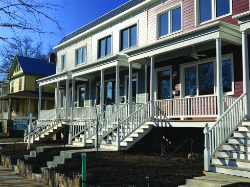

Some of the windows, chosen for a winter solar heating contribution, exceeded the state’s maximum Solar Heat Gain Coefficient (SHGC).
THE FREEDOM TO BEAT CODE
So far, Gary Boyer said, he has been asked only once to help a builder use the ERI option—for the townhome project shown on page 29, built by developers Jessica Pitts and John Miller of Flywheel Development, based in Washington, D.C. “They built these super-cool modular net-zero row houses,” said Boyer. “The walls were like R-50—it was way over the top. But REScheck was penalizing them because the windows didn’t meet what it wanted. So I had to model it for them with REM/Rate.”
Pitts and Miller described the problem to JLC in a phone call. The building, it turns out, was precertified as a Passive House and designed using the Passive House Planning Package (PHPP) to meet the stringent airtightness and energy-conservation specifications of the Passive House program. Clearly, the building exceeded code.
“But we had a challenge around the Solar Heat Gain Coefficient (SHGC) factor for the windows,” Miller explained. “Our south-facing glass is designed to be oriented in such a way that it does admit light in the winter to help warm the house. That’s what the Passive House Planning Package expected us to do, so we went with that because we needed that solar heat gain in the wintertime for heating. And it was not code compliant because it didn’t meet the minimum SHGC factor for the code.”
In the design, most of the south-facing glass is sheltered under front porch roofs that will block summer sun, but allow low-angle winter sun in—a smart passive-solar technique. But REScheck couldn’t capture that benefit, and the prescriptive pathway in the code wouldn’t allow the trade-off.
Maryland has an industrial and modular building program that regulates plan review and inspections of modular projects, Miller said, and Flywheel is using a modular manufacturer that works directly with a third-party plan reviewer. “They needed to see something in their package that checked the right box, and we couldn’t check that box,” Miller said. “So we needed the REM/Rate model.”
