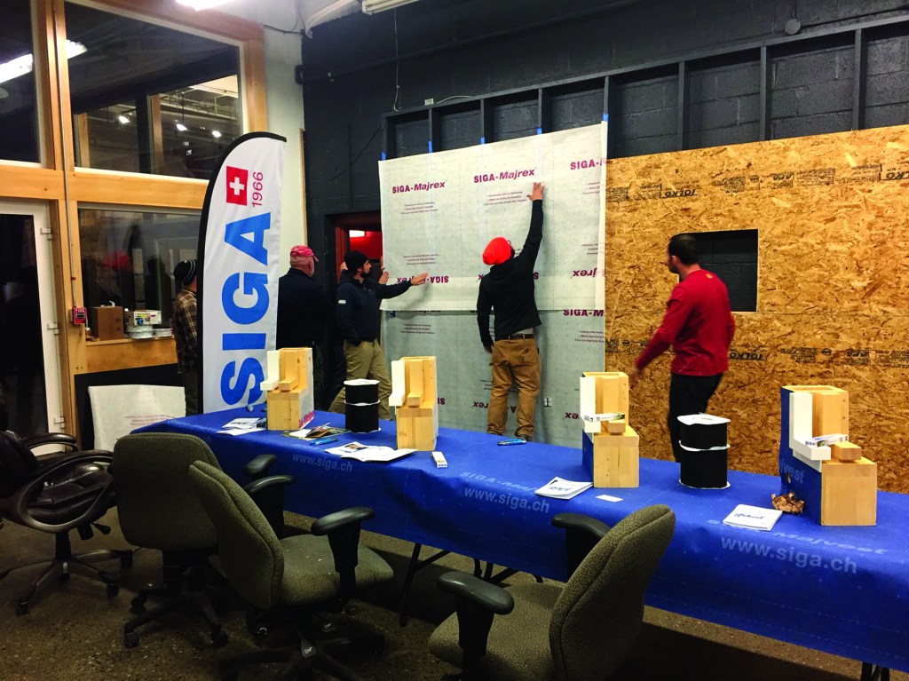

Siga sales manager Keith Bidwell conducts a training for contractors at Performance Building Supply, in Portland, Maine.
Ted Cushman Siga sales manager Keith Bidwell conducts a training for contractors at Performance Building Supply, in Portland, Maine.

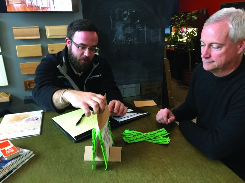

At a meeting with JLC, Bidwell explains Siga’s kitchen-table demonstration of the Majrex membrane’s directional drying properties.
Ted Cushman At a meeting with JLC, Bidwell explains Siga’s kitchen-table demonstration of the Majrex membrane’s directional drying properties.

Based on “dry-cup” and “wet-cup” ASTM testing, the less-permeable face of Majrex is rated at just 0.16 (“dry”) to 1.3 perms (“wet”); that’s the side you install facing the conditioned space. The more permeable face opens up from 0.17 (“dry”) to as much as 3.8 perms (“wet”); that side is placed facing into the fiber-insulated wall or roof assembly. So all else being equal, moisture can move out of the wall or roof into the conditioned space three times faster than it can move in the opposite direction, into the walls or roof. Siga rep Keith Bidwell showed JLC a simple demonstration (above): If you seal wet wood into two envelopes made of Majrex, one with the vapor-open side in, and one with the vapor-open side out, only one piece of wood will dry out.

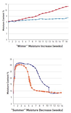

Controlled conditions. European building-science researchers  studied variable-permeability membranes in the lab, using  mock-ups of an insulated roof with a vapor-closed roofing  material. During simulated “winter” conditions (top), the  mock-up with the directional permeability membrane  (blue) gained less moisture than the one with a two-way  humidity-responsive membrane (red). But the less vapor-open  directional-permeability mock-up also took several weeks  longer to dry out during simulated “summer” (bottom).

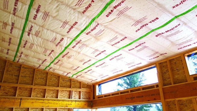

Early adopters are starting to try out Siga Majrex in projects such as these cathedral ceilings.
Collective Carpentry Early adopters are starting to try out Siga Majrex in projects such as these cathedral ceilings.
These were constructed for high-performance homes in British Columbia and Maine.
Kim Weaver These were constructed for high-performance homes in British Columbia and Maine.
Early adopters. Siga’s existing line of weather-resistive barriers and sealing tapes has a strong presence in North America, but Majrex has a long way to go to build a track record. Still, the technology already has a toe-hold. Collective Carpentry, a Passive House panelizer and custom builder in British Columbia, recently tried the product out on one of the company’s rare truss roof projects. Homeowners Kirt and Kim Weaver chose Siga Majrex for a custom home project in Topsham, Maine.

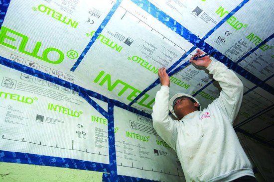

The ideal use for Siga Majrex, the company claims, is the underside of a flat roof in a cold climate with vapor-tight roofing above—the same application where New York architect James Wagman specified Intello variable-permeability membrane.
Nate Dorr The ideal use for Siga Majrex, the company claims, is the underside of a flat roof in a cold climate with vapor-tight roofing above—the same application where New York architect James Wagman specified Intello variable-permeability membrane.
