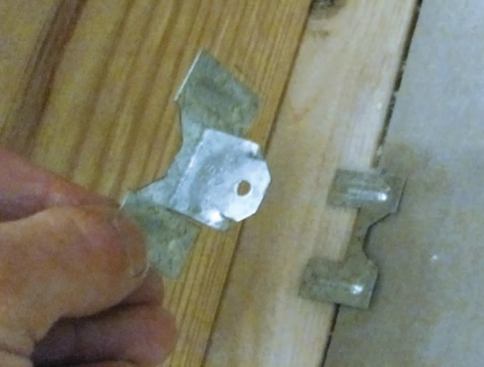

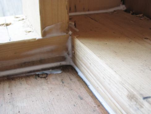

With two-stud corners and backerless wall intersections, we used drywall clips instead of nailers to support drywall corners. Both the hangers and I were surprised at how easy the clips were to use. Their purpose is threefold: First, they reduce lumber usage; second, without a nailer in the way, areas above the top plates and behind wall tees and corners are easier to insulate; and third, they help prevent drywall cracks in the corners where wood movement can otherwise introduce stresses. Cracks aren’t just unsightly; they also can contribute to air leakage through the wall assembly.
The blueboard and skim-coat plaster serve as the primary barrier to air movement through the walls and ceiling. When hanging the sheets, we ran a bead of acrylic caulk at all top and bottom plates, at wall ends, and around all openings, fixtures, and electrical boxes. At drywall clip corners, we simply caulked the vertical seams after installing the board — good insurance should the plaster crack in the corners despite the clips.

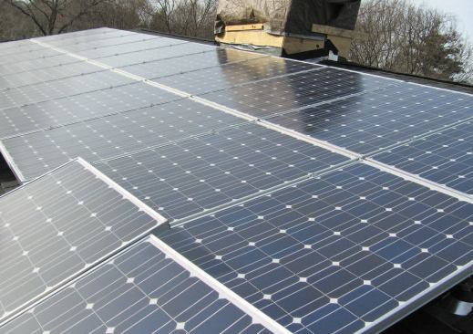

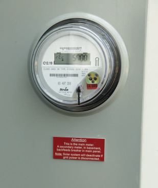

Solar power. On the roof, a 7-kilowatt photovoltaic array of 230-watt OnEnergy panels (800/237-4277, sharpusa.com) helps offset electrical usage, with excess power generation being fed back into the grid.
