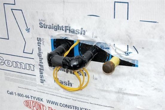

The first line of defense against those kinds of problems is a tight outside envelope. Most of our homes are stick-framed structures on slab-on-grade foundations, sheathed with OSB and wrapped in a 3/4-inch layer of polyiso board. Outside that, we add a primary air barrier of Tyvek Commercial Wrap, which I like because it’s tougher than most residential housewraps. It’s also less permeable, with a perm rating of about 15, compared with 59 for the residential version of Tyvek. We lap the material where necessary, and tape any seams with Tyvek tape.

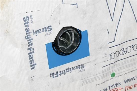

Penetrations for things like pipes, wires, and dryer vents are a common source of both air leaks and bulk water leaks if they’re not sealed correctly. We use QuickFlash flashing panels in such areas (quickflashproducts.com); these plastic panels have flexible rubber seals and come in a wide variety of configurations.

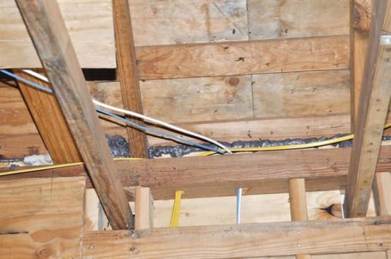

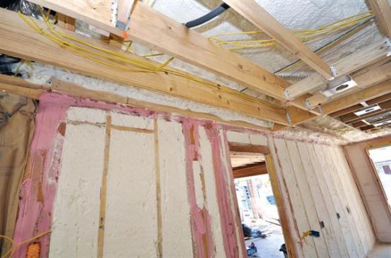

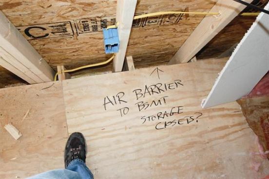

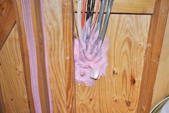

In remodeling projects, it’s not uncommon to find framing problems that allow unconditioned air to pour directly into the living space. These can usually be sealed off with some combination of plywood, sheet foam, and canned spray foam. After taking care of these trouble spots, we seal any middle-sized holes where pipes and wires pass through the framing. Our favorite material for this is a black-colored polyurethane foam called “koi foam” (used in our area for adhering ornamental stones to the liners of koi ponds). We like it because it doesn’t degrade from UV exposure.
We also take time to apply targeted amounts of canned foam to penetrations even in areas that will later be insulated with spray foam, such as around the eaves. Our insulation sub ordinarily doesn’t spray these areas until after the siding is in place, so “prefoaming” any potential leaks to the outside prevents the spray foam from poking through the exterior finish.

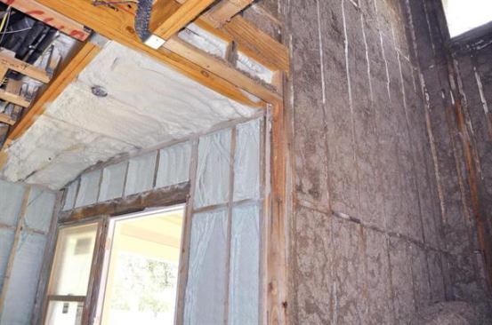

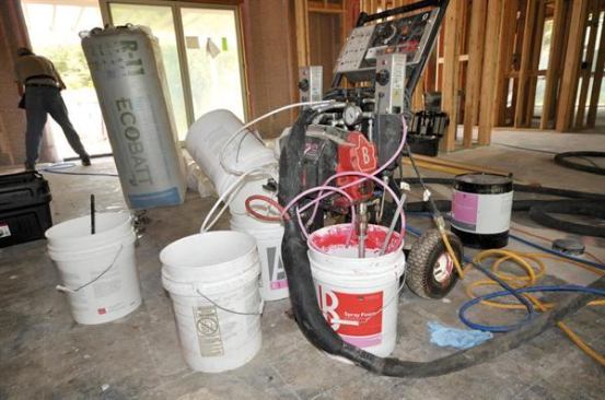

A conventionally insulated attic — with a drywall ceiling buried in insulation — represents a huge zone of potential leakage, especially if there are light cans, wires, and ceiling fans to contend with. Rather than trying to seal these on a piecemeal basis, we foam the entire roof deck and eaves from the inside to bring the whole attic inside the home’s thermal envelope. To minimize heat buildup in the resulting “hot roof,” we cover the outside of the deck with 2 inches of polyiso board, a continuous layer of Ice & Water Shield, and a vented standing-seam metal roof on diagonal furring strips.
In addition to sealing leaks around the eaves — which can be difficult to deal with otherwise — this approach prevents indirect leaks by locating all the hvac ducts in conditioned space. Although our hvac guy seals our ductwork and performs a duct-blaster test, there’s no way to avoid some leakage. Even a fairly tight system might leak 50 to 100 cfm into an unconditioned attic, placing the rest of the house under negative pressure and inducing humid outside air to find its way in — a potential problem that goes away when the ducts are moved inside. Keeping the ductwork out of a blazing-hot attic also minimizes heat transfer and may make it possible to use a smaller AC unit.
We only use open-cell for insulating roof decks. That way, any water that might find its way through the roofing will eventually soak or drip through the foam and let the homeowner know there’s a problem. Insulating a roof deck with impermeable closed-cell foam is asking for trouble, in my opinion, since a small leak could go undetected for months or years, allowing rot to develop.

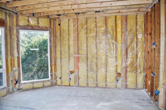

Cracks between adjoining framing members or framing members and sheathing are another major source of air leaks. The crack between the bottom plate and slab or floor sheathing is the most obvious of these, and most builders now use flexible plastic sill sealer in this area. That’s better than nothing, but for a reliable air seal, the joint should also be caulked all the way around the building.

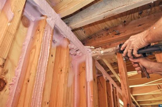

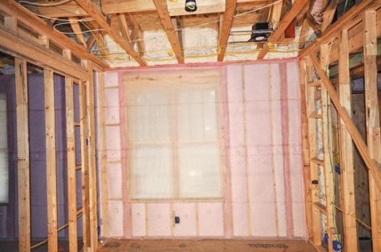

Our preferred wall system for new construction uses 2x6 walls with advanced framing insulated with Owens-Corning’s EnergyComplete blown-in fiberglass, which is designed to combine the air-sealing ability of foam with the low cost of fiberglass. The air-sealing component is provided by a fast-curing, flexible latex foam that can quickly be sprayed over the edges of ganged studs or double plates to form a thin, easily compressed layer that doesn’t interfere with the drywall. It’s also used to air-seal butt joints between sheets of plywood or OSB sheathing, or between framing and sheathing.
After methodically spraying potential air leaks with the latex foam, our insulation sub nets and blows the wall cavities. Combined with 3/4 inch of exterior rigid foam, that gives us an R-23 wall, which is well beyond the code-minimum 2x4 wall with R-13 batts.
Because the wall between the garage and living space lacks the layer of housewrap on the exterior walls, we air-seal and insulate this critical area by foaming the wall cavities, rather than using netted fiberglass. But spray foam has one limitation when used as a cavity fill: Because it’s trimmed flush with the edges of the framing, it doesn’t address leaks between framing members, which must be sealed some other way.
The easiest way to do this, we’ve found, is to have our fiberglass sub spray the framing in this area with EnergyComplete sealant before the spray-foam sub fills the cavities. This is an approach that Owens-Corning probably isn’t too enthusiastic about. The sealant can only be applied by OC-trained applicators, and the company developed the system to compete with spray foam, not to enhance it. Officially, OC won’t recommend using its latex foam with anything but its own brand of fiberglass. But since he’s blowing glass into the rest of the walls, our sub doesn’t mind sealing this limited foamed area as well, and field experience has shown us that our “off-label” approach is very effective.

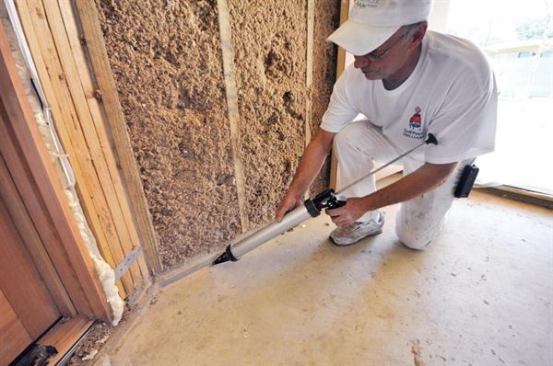

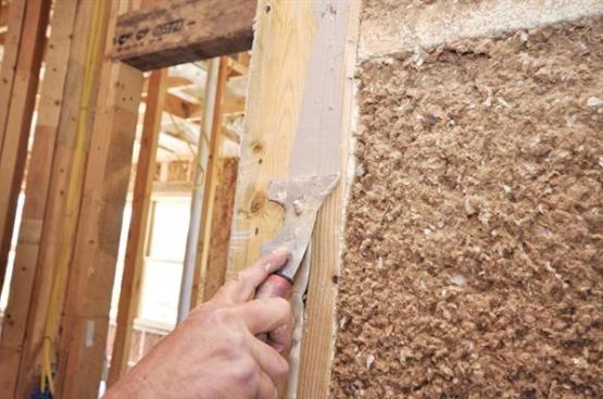

If we’re working with 2x4 framing — as is often the case in remodeling projects — we insulate the walls with open-cell foam throughout. We also work with one architect who often specs 2x4 walls insulated and air-sealed with an inch of closed-cell foam followed by 2 1/2 inches of spray cellulose.
In either case, there’s no fiberglass applicator on the job, so we have to seal cracks between framing members manually. We do this with a highly flexible commercial-grade caulk called Dymonic, made by Tremco (tremcosealants.com). After squeezing out a bead of caulk with a sausage gun, we immediately tool it flat with a painter’s tool so the drywall or trim will lie flat over it. Depending on the size of the house, it can take two workers two or three days to go over all the framing this way. My carpenters were initially responsible for this part of the job, but I’ve recently trained my painting sub to take it over, freeing up the carpenters for more demanding work.
