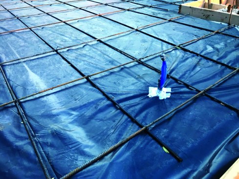

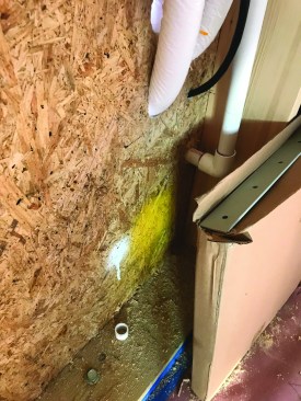

The air barrier starts below ground level, under the building. Our first line of defense is 10-mil poly, which we apply directly over the under-slab insulation. We’ve found that the 10-mil thickness withstands traffic better than the code-required 6-mil and prevents damage that would require us to go back and make repairs. During the installation of the 10-mil poly, all the seams are lapped and taped to ensure an airtight installation. When it’s available, we prefer to use one continuous piece of poly.
While it’s not too likely that we will develop air leaks through the slab penetrations, we instruct our subs that each individual stub through the slab be taped to the 10-mil poly below the slab. This means each line that penetrates the slab does so alone and is not mated with a handful of other pipes—clusters of pipes are nearly impossible to air seal. By separating the stubs by just a couple of inches, however, we are able to properly seal them.

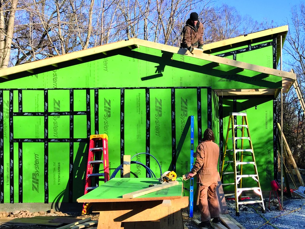

Once we are ready to frame a home, we have a crew meeting about our goals for the next steps of the project and the methods we will use, and we ask for objections or ideas. We do this on every project; it brings every crew member, no matter how green or seasoned, fully into the process. At this time, we assign one crew member to be in charge of all air-sealing, which will take place over multiple days and include various materials. This ensures we never run into “I thought that was someone else’s job.”
The Aarow Building crew leaves window and door openings sheathed for the duration of the framing.
When the frame is  complete, they’ll come back, fill in doors they left open for access, and run their initial blower-door test. Note the white spray  paint above the door. All temporary nailers are painted white for easy identification so they can be filled prior to the test.

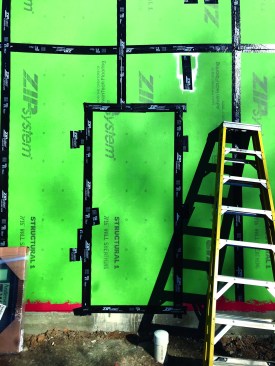

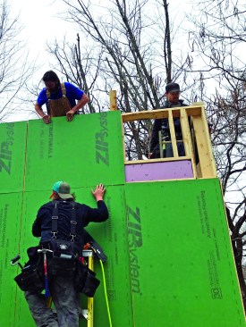

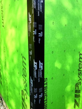

Now that the walls are standing, we start installing the sheathing. Our homes receive full sheathing using Huber’s Zip System. The seams are then taped according to the manufacturer specs. As with the liquid sealants, one crew member is responsible for all taping and rolling, which means everyone else can move on to other tasks. First, we tape all of the horizontal seams of the sheathing on the project and then all the verticals. This creates a shingled effect on all tape joints that will help to shed water from the tape and down the wall, without making a penetration into the envelope.
Corners are areas where Aarow Building ramps up the taping detail. On inside and outside corners, the crew uses three pieces of tape.
First, a single piece that bridges the joint between the meeting panels, and then, a strip on each side of the first  piece. Huber makes a 6-inch tape that could work, but it is a special-order item for the author.
The only aspect of the Huber instructions from which we deviate is the inside and outside corner taping—we use three pieces of tape instead of the recommended one. We install one piece on the corner, bridging both sides, and roll it. Then we install a strip on each edge of the first piece, as insurance. Make sure to roll the first piece before installing the others; otherwise, air can easily become trapped behind all three layers. We started using this practice because it was difficult to run tape in a straight line in corners, and the three pieces ensure full coverage. Huber makes a 6-inch tape that would work perfectly for this; however, our supply house doesn’t stock it and we find it easier to have a method that doesn’t require special-order items that can delay the schedule or be overlooked because they’re not on site.
For this home, we didn’t remove the window or door sheathing during framing, so we could test the envelope before installing the windows. We taped and rolled those openings as if they didn’t exist at this stage.

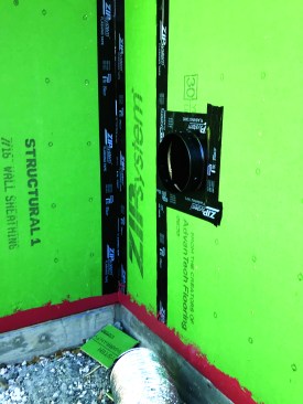

After all the walls are up, we return to the slab-to-wall connection. On this project, we used FastFlash, a liquid flashing product from Prosoco; I also think the fluid-applied sealer from Huber is a superb product. We chalk a line 1 inch down from the top of the slab as a guide, to avoid applying the product too far down for the siding to properly conceal it. Then we apply the Prosoco FastFlash, bridging from the Zip sheathing down to the foundation (see “Air Seal at Base of Wall,” above).
Flashing the base of the wall requires more attention to detail than anything else discussed so far. It’s messy, you’re often in the mud, and the area is low and hard to see. But it is an important spot. Of all the air leaks, those low and high on the wall draw in the most air due to stack pressure. If you’re going to invest your time on air-sealing, those are the areas to concentrate on.
The wall-to-slab connection is also difficult to detail because the slab concrete is never completely flat or straight. Hence, it requires a lot of added effort to create a solid seal. Keep in mind that leaks here will be impossible to repair after construction is complete, so getting them right the first time is critical.

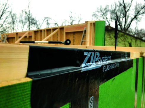

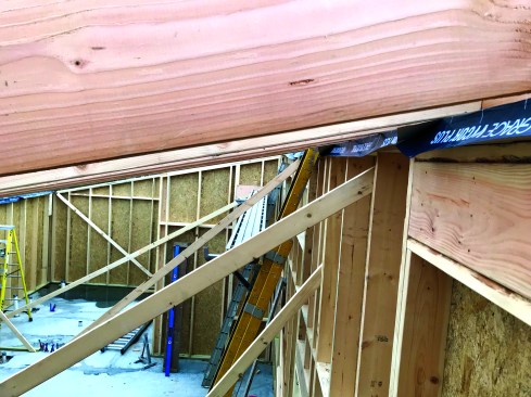

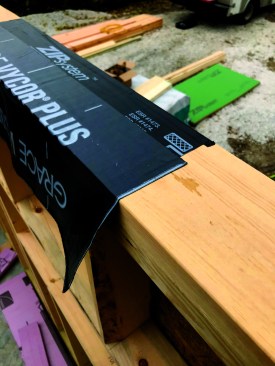

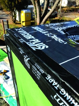

On this home, the ceiling drywall is part of the air barrier, so we needed to make the transition from the Zip System sheathing to the drywall at the top of the wall. For this transition, we use two different tapes: Zip seam tape and 9-inch Grace Vycor Plus with a split backing. We first tape from the wall sheathing onto the top plate. Depending on the wall height, this may take two runs of the Zip tape.
Continuous air barrier. Air leaks at the top of the wall are sealed with a combination of Zip Tape and Grace Vycor Plus. First, the sheathing is taped to the top plate.
Strips of 9-inch Vycor Plus lap over this tape.
The Vycor Plus strips extend inside. There, they will be taped to strips of OSB that will be installed at the perimeter of the ceiling, forming the air barrier for the lid.
Then we install the Grace Vycor. We leave half of the backing on the tape and let it hang into the building so we can connect to it after we’ve installed the ceiling joists or rafters.

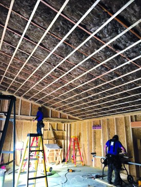

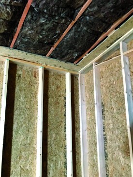

After completing the taping, we finish framing the structure and even install the roof sheathing. We strap the interior ceiling with 1×3 pine to create a channel for wiring. This strapping also helps flatten the ceilings.
Around the exterior walls, we stop the strapping short, and we fill in with ripped 8-inch-by-8-foot strips of AdvanTech subflooring. We now take the Grace tape that we had left hanging, and we roll it onto the top side of the AdvanTech and nail it to the bottom of the rafters, providing continuity in the transition from wall to roof. The combination of the AdvanTech and the strapping gives us an even plane on which to install drywall. It also allows the drywall ceiling to be fastened 16 inches on-center when we are framing 24 inches on-center. The tighter fastening schedule helps to prevent sag in the drywall over time.
At ceiling penetrations, we install blocks of AdvanTech in plane with the strapping. We drill through the blocks for any lines that pass through the ceiling, giving us a good surface to seal to.
Ceiling strapping helps flatten the ceiling - a particularly important detail on this sloped ceiling, which will be raked by daylight from clearstory windows.
Ceiling strapping helps flatten the ceiling – a particularly important detail on this sloped ceiling, which will be raked by daylight from clearstory windows.
At the perimeter of the ceiling, the crew installed strips of OSB. The Vycor installed across the top plates adheres to the top of this OSB and drywall is secured to the bottom to complete the air barrier across the lid.

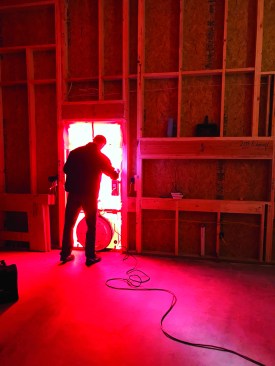

Verifying Framing Tightness
As a standard practice, our company executes multiple blower-door tests during the sequence of construction, to progressively identify air leaks as we proceed. We own a blower door, and as a builder of high-performance homes, we believe the blower door is just as important a tool as any of our saws.
Blower-door testing before insulation allows the crew to easily identify leaks in the shell before they get buried.
We performed the first blower-door test on this home once we were done with the sheathing and had installed drywall on the ceiling. This test was done before the door and window rough openings had been cut. We filled in the doors we needed for access, as well as the attic hatch, with Zip System sheathing, taping it in place. This allowed us to test the integrity of the primary air barrier—the taped sheathing and drywall lid. The result was 0.31 ACH50 Pa, roughly one-tenth of the allowable leakage by code in our market. It is equivalent to a cumulative hole less than the size of a business card across the entire envelope. Not a bad start.

The way we find errors in the air barrier is with the blower-door testing. If the numbers on the blower-door test seem off, we can inspect with the blower door running. Every member of the crew and all of our subtrades have the opportunity to go back and correct a seal along any section of the wall or any penetration. This first test also gives us the ability to compare numbers with the next blower-door test that we perform, after the window installation. That gives us a metric for judging how well we installed the windows and an indication of any possible problems that we should correct.
Set procedures like approving penetrations by trades and assigning one crew member to take responsibility for all air-sealing have made the process of achieving a tight envelope as simple and cost effective as possible, while setting us on the path towards an extremely energy-efficient home.
The next blower-door numbers, after the doors and windows were installed, tested out at 0.91. This number was a bit higher, but that’s to be expected after cutting in all the openings. We hope this number will improve slightly. But one thing is sure: We will learn what works, and what doesn’t, and can adjust accordingly on out next build.
