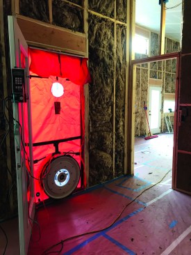

Testing before and after windows. A first blower-door test tests the building envelope alone. Sheathing is installed with taped seams, but the openings for the windows are not cut out. This test lets the author identify and address any air leaks in the shell.

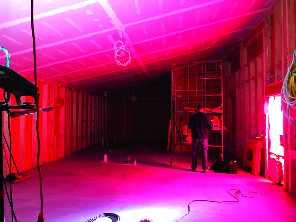

When we do a blower-door test before the windows are installed, we’re able to test the airtightness of the building envelope alone. This initial test gives us the opportunity to check for errors or air leaks before introducing additional opportunities for leaks in the form of the windows. Testing prior to window installation allows us to first quantify and address any leakage in the shell itself. Once we get the shell as tight as we can, we are then able to quantify with a second blower-door test any leakage that might be caused by the installation of the windows. This second test also allows us to compare different window packages over different projects and possibly compare the effectiveness of different installation methods. Knowledge in the building industry is everything, and blower-door testing is the way to provide knowledge about air-sealing.
A second test is performed after the house is insulated and the windows and doors have been installed. Comparing the numbers from the two tests quantifies how much air leakage is due to the windows, separate from the shell.
