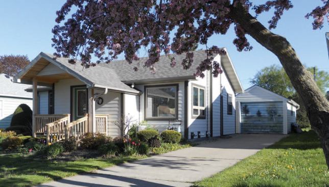

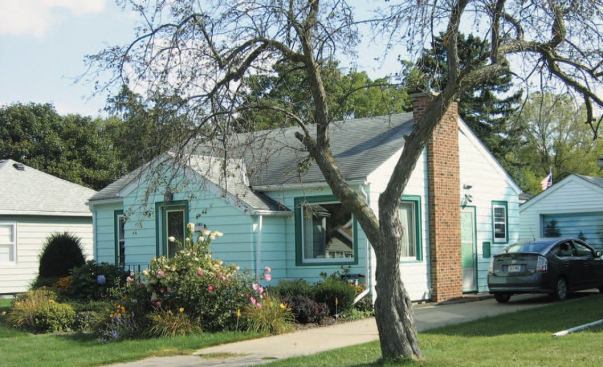

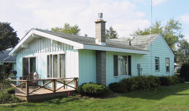

I'm a building energy consultant in central Wisconsin. I recently had a chance to perform a major energy retrofit on a modest ranch-style house just south of Lacrosse, Wis. It was a simple two-bedroom home that was probably built shortly after World War II. Such homes are quite common around here; I've heard them called "farmer's widow" houses because they're too small for a typical family. The original house covered just 700 square feet, and a 1970s-era addition off the back provided an additional 500 square feet. The basement, used mostly for storage, added another 950 square feet of conditioned space.
Like many houses of its time, this one was leaky and very lightly insulated, making it expensive to heat and uncomfortably drafty. But it was located in a pleasant established neighborhood where no new building lots were available. While tearing down the existing structure and building a new one on the same site would have been a reasonable option, the homeowner instead chose to invest in an extensive retrofit designed to make the house even more energy-efficient than comparable new homes, with increased comfort and improved interior air quality as added benefits.

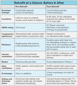

Baseline tests. To establish an "energy baseline" for the house, I performed a blower-door test, scouted for thermal leaks with an IR camera, and cut some exploratory holes to assess the sheathing and insulation. I also analyzed the combustion performance of the existing atmospherically vented hot-water heater and the condensing furnace, and measured the indoor radon level.
I then ran the numbers through REM/Rate energy modeling software, which I routinely use as a consultant with Focus on Energy, Wisconsin's statewide energy efficiency program. On the Home Energy Rating System (HERS) scale, the existing structure clocked in at 125. That's well short of the nominal 100 rating expected of a new house built to comply with the 2006 IRC, but considering that much of the house contained little or no insulation, it wasn't all that bad.

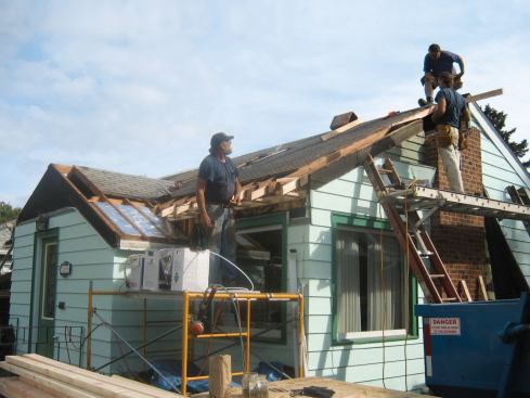

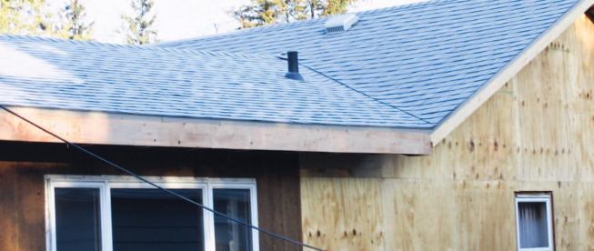

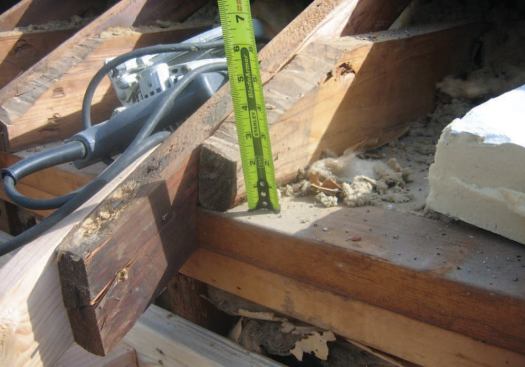

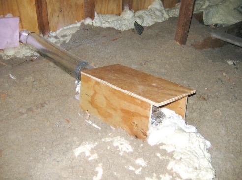

Eaves extensions and foam. Most of the attic was deep enough for us to blow in an R-60 layer of loose-fill cellulose, but the low-sloped 2x4 rafters left little room for insulation at the eaves. To provide sufficient R-value here, eliminate a major source of air infiltration, and supply a protective roof overhang, we pulled off the lower part of the plywood roof sheathing, extended the framing at the eaves, and sprayed the area over the plate and some distance into the attic with Versa-Foam 1.8-pound polyurethane foam, which we ordered directly from the manufacturer. In limited areas where the foam expanded outward beyond the plane of the framing, we cut away the excess foam with a sharp toolbox handsaw. The gable-end overhangs now tie in neatly with the eaves of the rear addition, doing away with what had been an awkward transition. At the front of the house, where the tops of the windows were high on the wall, we scaled back the overhang a bit to keep from shading the interior too much.

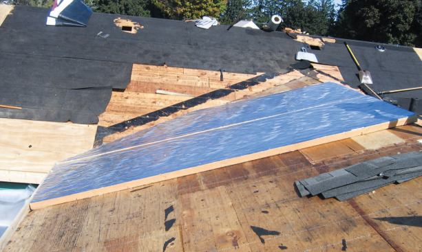

One problem spot was a short section of roof above a small entry vestibule to the right of the front door. There was no ceiling in the closet below, leaving no room for cellulose. Instead, we cut away the roof sheathing and carefully fitted several pieces of 3-inch foil-faced polyiso board between the rafters, filling gaps between the rafters and foam board with a little spray foam where necessary.

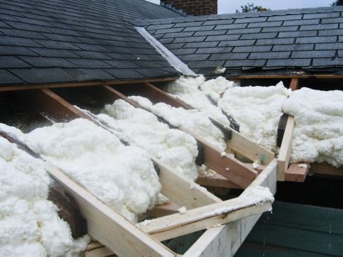

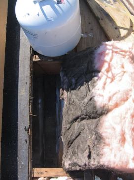

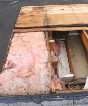

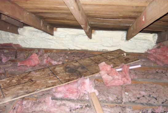

Drafty fiberglass batts. After stripping the old roof, we discovered beneath the sheathing of the cathedral-roofed addition some classic signs of an insulation system that wasn't working too well. Warm, moist interior air had clearly been moving freely through the insulation for years, cooling and condensing against the plywood roof sheathing and leaving some sections of the batt insulation looking like dust-clogged air filters. Although there was little evidence of decay, the plywood was discolored and the nails fastening it to the rafters were badly rusted.
Rather than tear off all of the sheathing and remove the batts, I decided to remove the sheathing only in areas where our blower-door tests had confirmed the presence of leaking air. We cut away a strip running the length of the ridge and foamed the peak from above, blocking air that had been making its way through the cedar paneling. (A poly vapor barrier stapled to the underside of the rafters when the addition was built effectively slowed air movement through the field, but did nothing at the roof peak and edges.) We used additional foam and some sheets of beadboard to air-seal the transition between the framing of the original house and the roof of the addition.

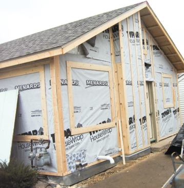

Exterior foam. Through a local commercial builder, I got a great deal on about a hundred 4-foot-by-13-foot sheets of foil-faced polyiso board left over from a large job. With the air leaks in the roof taken care of, we laid the sheets of foam board directly on top of the plywood, butting them against a new subfascia sized to cover the edges of the foam and the plywood sheathing that would go on over it.
Walls

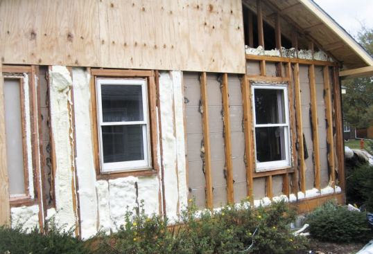

The original walls were a hodgepodge of different materials, starting with a layer of fibrous sheathing (locally known as "buffalo board") over the studs. Over that, there was a layer of lap siding, followed by aluminum siding. The addition had T-111 siding nailed directly to the studs. Our insulation strategy called for stripping the walls to the stud cavities, putting up new sheathing and dense-packing the stud cavities with cellulose, then applying a continuous layer of the same polyiso board we'd used on the addition roof.

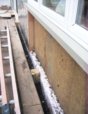

Cavity insulation and perimeter foam. We stripped off the old material in manageable stages, keeping a close eye on the weather. While the sheathing was off, we took photographs of each wall to document the location of the framing, in hopes that this would make life easier for some future remodeler (and for ourselves). As we nailed up the new 7/16-inch plywood, we predrilled a 2 1/8-inch hole over each stud cavity. That saved a lot of time and effort for the insulation contractor who later filled the walls with dense-pack cellulose, and also assured us that all of the cavities were filled. While the walls were open, we also applied some spray foam around the top and bottom plates, where both the blower-door test and the infrared images had indicated a lot of air leakage. To eliminate any possibility that high indoor vapor pressure in the bathroom could drive moisture into the framing cavities, we completely filled the stud cavities of that short section of exterior wall with spray foam.

We insulated the perimeter of the foundation with two layers of 1 1/2-inch XPS, digging by hand to a depth of 18 inches or so and packing the soil back around the foam. The exposed foam was later covered with a protective layer of galvanized coil stock (which doesn't dent as easily as aluminum).

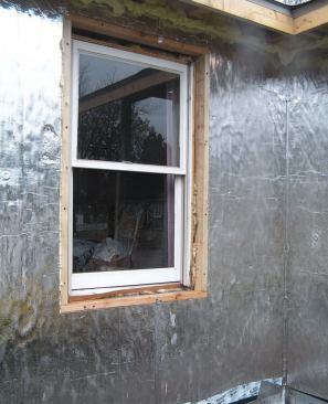

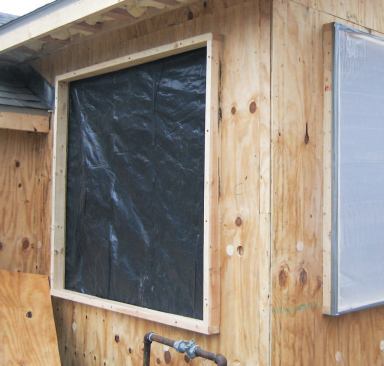

After we'd applied the new sheathing, we built out the window framing to finish flush with the surface of the polyiso board, which we fastened with 5-inch Torx-head screws and 2-inch galvanized washers. We'd used heavier Phillips-head screws on the roof, but we found that they were almost impossible to drive into the walls without the user's weight bearing down on the drive bit. To make sure of hitting a stud every time, we predrilled all the screw holes.

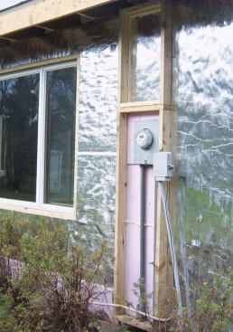

While hanging the exterior insulation, we had to get creative in a few areas. We couldn't fit a layer of the polyiso board behind the electric meter, for example, and didn't want to go to the time and expense of having the power company move it. Instead, we insulated behind the meter with a single layer of 1 1/2-inch XPS and boxed around it from the bottom plate to the eaves, which made for a cleaner-looking transition than boxing just around the meter itself. After completing the insulation and sheathing, we applied a layer of housewrap to act as a drainage plane and screwed vertical strapping over the studs to provide a nailing base for new rain-screen siding.
The original fireplace was no longer operable, and after we replaced the atmospherically vented gas water heater, the masonry chimney was no longer needed. To eliminate it as a major source for exfiltration, we cut it off at the roofline, capped it, and enclosed it in an insulated chase that lay completely under the overhang. This was easier on the budget than taking apart and disposing of the entire chimney, and it even added a small amount of thermal mass inside the new thermal envelope. Looking ahead, the insulated space within the old chimney will make a convenient chase for running wiring or plumbing for a roof-mounted PV or solar-thermal array.

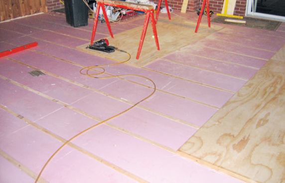

Addition Slab

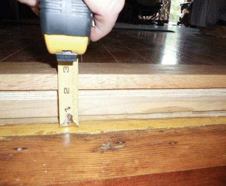

The concrete slab floor in the addition had been covered with carpeting. When we peeled it up we found no signs of mold or moisture, and a cup test confirmed that moisture wasn't a problem. We fastened nominal 2x2 sleepers to the concrete and fitted cut-to-size sheets of 1 1/2-inch XPS between them. We then put down an oak finish floor, raising the level of the original floor by nearly 3 inches. Fortunately there was room to accommodate this with a gently sloped threshold.

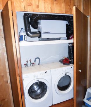

We replaced the old, inefficient (and unsafe) water heater with a Takagi T-K3 sealed-combustion demand heater. The new RenewAire EV 130 ERV was installed on a conveniently located shelf in the closet that houses the clothes washer and dryer. It draws supply air through a vent high in a sidewall and exhausts the outgoing air through a run of rigid duct that exits low in the wall, thus avoiding penetrations into the attic. The loud old bath fan was replaced with a Panasonic WhisperLite and the old, nonfunctional range hood replaced with one that works.

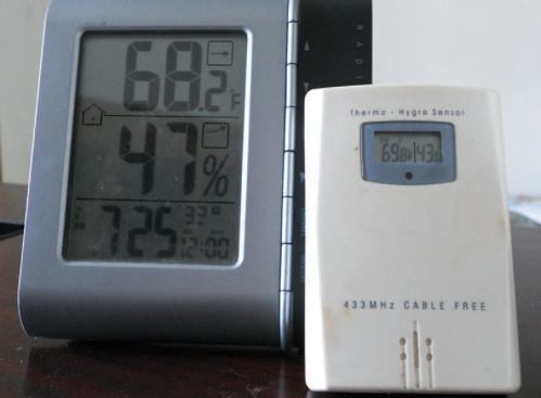

Keeping an eye on temperature and humidity. To get a handle on any changes in indoor air quality, we also installed an inexpensive wireless thermometer/hygrometer from Radio Shack. The model we chose accepts up to three remotely located transmitters (which are purchased separately from the receiver), allowing us to put one in the basement, one in an upstairs bedroom, and a third outdoors.

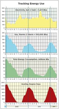

A post-retrofit blower-door test confirmed that the house was much tighter: The pre-project figure of 2,100 CFM50 (about 8 ACH) had fallen to just 700 CFM50 (about 2.6 ACH). But because we were interested in qualifying the project under the Affordable Comfort Institute's Thousand Home Challenge program - which aims to document one thousand deep-energy retrofits that meet its stringent criteria - we collected monthly figures on post-retrofit gas and electricity consumption (details on ACI's Thousand Home Challenge is available at thousand homechallenge.com). For comparison, we also collected energy-use figures for the year before the project began.
Unexpected result. As Figure 11 shows, overall energy as measured in MMBtu - a unit that makes it possible to express gas and electric use as a single number - declined sharply. That's consistent with the improved insulation and tighter building envelope, and it's quite close to the pre-project projection based on the REM/Rate energy modeling program.۩But even a small house is a complex system, and changes in one area can have unexpected results in another. Soon after the completion of the initial phase, the indoor humidity began to rise as a result of reduced air leakage and a relatively high water table around the original basement. That problem will be dealt with permanently during Phase 2 of the project, along with the minimal headroom, absence of insulation, and elevated radon level. For now, though, the indoor humidity is being kept under control with a dehumidifier. As a result, post-retrofit electricity consumption has remained about what it was before the work began, offsetting the gains made by changing incandescent lights to CFLs and installing new energy-efficient appliances.

Will the homeowner ever get the return on that substantial investment? The answer in this case is almost certainly no. But there were other good reasons to do the work. The appearance of the home is much improved, and future maintenance costs will be less. Most important, though, the living space is now warmer, more comfortable, and healthier. The current homeowner expects to remain there for the rest of her life, and sees the $300-per-month net cost of the improvements (based on a 15-year mortgage at 4 percent) as money well-spent.
