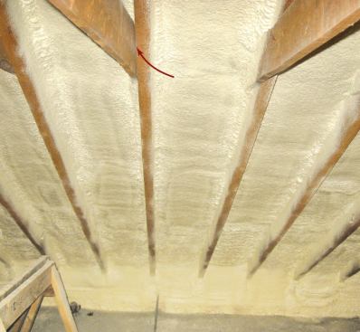

This correctly applied closed-cell foam has been sprayed directly against the underside of the roof deck. To eliminate air leaks at the eaves, the foam has been extended beyond the top plate to form a seal against the attic floor. One minor omission: An additional shot of foam to each of the cracks between rafters and collar ties (arrow) would have prevented any possible air movement through that interface.

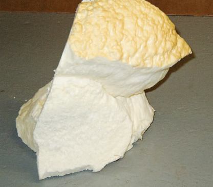

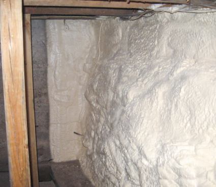

Off-ratio foam. Unlike most building materials – which come off the delivery truck needing only to be cut to size and fastened in place – spray foam is actually manufactured as it’s used, in a mobile “factory” at the job site. It’s this monolithic, formed-in-place quality that allows spray foam to far outperform prefabricated foam board in applications where gap-filling ability is required.
Defective B-rich foam, like that shown here, is characteristically soft and sticky and has a distinctive chemical odor. The material has not bonded to the sheathing beneath and can easily be pulled from the framing cavities by hand.
Ideally, the contractor’s pumping equipment combines the A-side and B-side chemicals that make up the foam in a near-perfect 50/50 ratio. But partially clogged or incorrectly adjusted equipment can produce foam that’s hard and brittle or sticky and soft, depending on the component imbalance.
The best way to ensure a proper mix is to use ratio-monitoring equipment, which will set off an alarm or turn off the pump when the mix ratio exceeds the manufacturer’s tolerance range. Unfortunately, the equipment is so expensive few installers use it.
A lower-tech method of tracking the foam ratio is to periodically weigh the A and B drums – but by the time this is done, the material in place may already be off-ratio. Going off-ratio is typically a gradual process, and an experienced technician can usually spot it happening early in its development. New contractors, however, usually have to see bad installed foam to learn the lesson. There’s also a tendency to cover up bad material once the equipment problem has been addressed, which can lead to complications later when the bad material is exposed to environmental stresses.

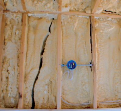

Errors in application. Even if foam is properly mixed with undamaged chemicals, success still isn’t guaranteed. Improper application or failure to allow for environmental conditions can lead to a variety of “after the gun” defects.

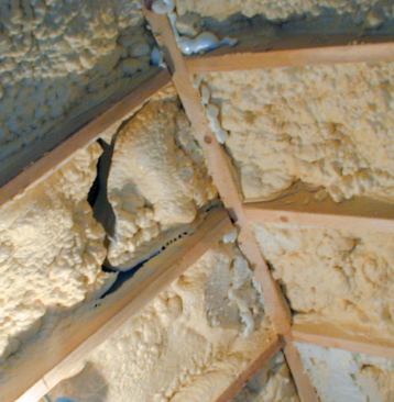

Closed-cell foam gives off a lot of heat as it cures. That’s not a problem as long as the foam is applied in relatively thin layers – or “lifts” – that allow excess heat to dissipate between layers. But if an inexperienced or careless operator piles up too much foam at one time, the heat can’t escape. Once the temperature rises beyond a critical level, the resulting foam can shrink excessively after it cures.

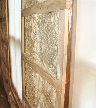

Closed-cell foam applied in lifts that are too thick is subject to overheating, which can lead to subsequent shrinkage and cracking — a problem that may not become evident until months after the applicator has packed up and left. The lighter-colored areas of foam mark the location of cracks that had been filled in an earlier attempt at repairing the still-ongoing shrinkage.
Cracks in the foam sprayed against the roof sheathing precisely matched melted areas of frost on the roof exterior in cold weather. Because such cracks may extend all the way to the sheathing, humid indoor air that moves through them may condense on the cold underside of the sheathing, promoting mold growth or rot.

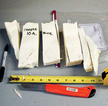

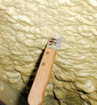

A cheap kitchen knife — with graduated inch markings added to the blade with a permanent marker — is a handy tool for cutting samples and confirming material thickness.
Overheating can also result in blowholes, hidden voids, or internal scorching, and even cause fire to break out (see “Massachusetts Fire Officials Urge Caution with Spray Foam,” JLC Report, 10/11). To minimize these kinds of problems, most high-end manufacturers of closed-cell foams offer summer and winter formulations of their products, and some even have spring/fall formulations for the swing seasons.

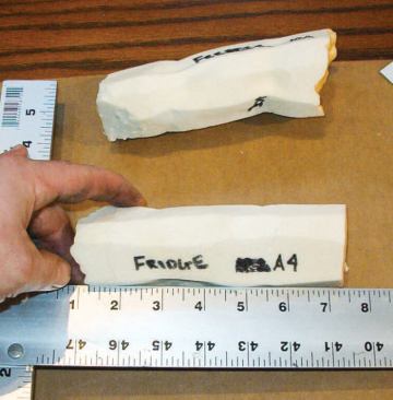

A simple way to verify that the foam installer is using the right materials is to check the labels on the drums. Parts A and B should be from the same manufacturer and should be identified as components of the same foam “system,” if the manufacturer has multiple foam products. It’s also a good idea to systematically check samples of the foam as the job progresses. This doesn’t have to be a difficult or complicated procedure. Basically, it involves cutting out a chunk of foam about 6 inches square – tapered slightly inward for ease of removal – at the end of each work day. The sample should be bonded to the substrate to the point that it must be broken out of the hole. Foam that separates easily from the sheathing without leaving a layer of material stuck to the surface was likely applied to a substrate that was wet or too cold.
Compare the first test piece with the sales samples the manufacturer’s salesman hands out, and use it as a benchmark for the subsequent test shots. Mark each with the date and the area of the building it represents, measure its dimensions, and write that information directly on the sample. Don’t forget to have the installer patch the hole with more foam the following day.
For projects in climate zones 3 and lower, wait until the recommended cure time for the foam – typically 24 hours – has elapsed, then put the labeled and bagged sample in a refrigerator overnight to assess its reaction to thermal shock. In climate zones 4 and above, double the minimum cure time, then put the sample in the freezer overnight. The next day, remove it, check its dimensions, and compare any shrinkage with the acceptable range listed on the manufacturer’s product data sheet.

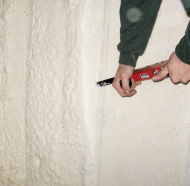

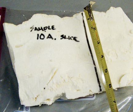

Another useful quality-assurance technique is to use a sharp knife to cut several shallow lengthwise slits down the center of a few randomly selected framing bays after the foam has finished curing. If there are any tensile stresses in the not-yet-shrunken foam, slitting the material will relieve them, in some cases causing the foam to separate at the cut line with a dramatic “pop.” In less severe cases, the cracks may gradually open up over the course of several days. Foam that doesn’t open up within a day or two is likely to be permanently stable.
The slitting technique can sometimes be used to salvage foam that’s generally adequate in quality but shows minor density-related shrinkage. It involves systematically slitting all affected material, waiting until the cracks have stopped opening, and filling them with additional foam. In either case, any slits that do not open up need not be sealed.

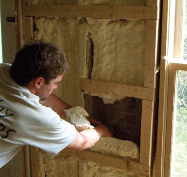

Fixing defective foam isn’t always so simple, of course. Badly off-ratio foam or foam with serious shrinkage problems may need to be completely removed and replaced. Regularly checking on foam quality greatly increases your chances of catching any problems before they’re sealed behind the wall or ceiling finish, at which point they become much more expensive to repair. Equally important, it lets the foam contractor know that you’re serious about the quality of the product.

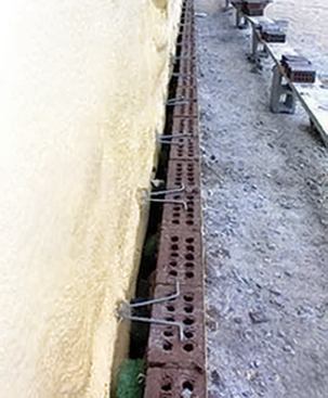

Foam below-grade. Fully cured closed-cell foam is almost impervious to water, which means it can be applied directly to below-grade masonry walls. If wire mesh or some other suitable material is mechanically fastened to the masonry base – eliminating the need for a physical bond between the masonry and foam – closed-cell foam can even be successfully applied to a damp or wet substrate, though adequate drainage must be provided.
Open-cell foam, on the other hand, absorbs water readily and should never be used on below-grade masonry that is damp or subject to seasonal wetting or moisture intrusion. Nor should it be installed in a roof structure that is not yet weathertight. Whether this type of foam dries out over time depends on the conditions. If, for instance, it is in a leaky roof cavity between plywood and a polyethylene vapor retarder that was installed a day after the foam, it may never dry out, especially if the roof is unvented.
