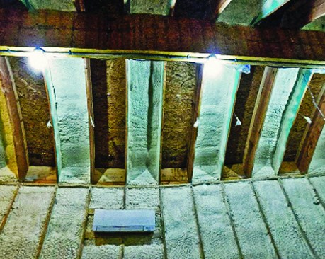

Excellent drying. The least vapor-permeable components in this assembly are the asphalt roofing shingles (Class II; little to no drying) and the closed-cell spray foam (Class II). Moisture-sensitive OSB structural sheathing is between them. However, the vent chute, even without stack-effect-driven air movement, has a vapor permeance of 300 perms (just diffusion). This assembly has excellent drying potential for the OSB to the exterior. And for all of the components to the interior of the closed-cell spray foam, there is excellent drying potential to the interior. Click to enlarge
Tim Healey Excellent drying. The least vapor-permeable components in this assembly are the asphalt roofing shingles (Class II; little to no drying) and the closed-cell spray foam (Class II). Moisture-sensitive OSB structural sheathing is between them. However, the vent chute, even without stack-effect-driven air movement, has a vapor permeance of 300 perms (just diffusion). This assembly has excellent drying potential for the OSB to the exterior. And for all of the components to the interior of the closed-cell spray foam, there is excellent drying potential to the interior. Click to enlarge

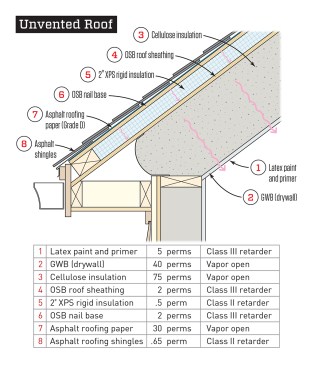

Limited drying. The least vapor-permeable components of this assembly are the asphalt roofing shingles (Class II) and the XPS rigid insulation (Class II). If the nail-base sheathing between them should ever get wet, it will not dry to the exterior at all and will have limited drying to the interior. The structural sheathing will have little to no drying potential to the exterior but good drying potential to the interior. With an interior Class III vapor retarder and only 2 inches of rigid insulation on the exterior, this assembly, as drawn, would be limited to warmer climate zones. Click to enlarge
Tim Healey Limited drying. The least vapor-permeable components of this assembly are the asphalt roofing shingles (Class II) and the XPS rigid insulation (Class II). If the nail-base sheathing between them should ever get wet, it will not dry to the exterior at all and will have limited drying to the interior. The structural sheathing will have little to no drying potential to the exterior but good drying potential to the interior. With an interior Class III vapor retarder and only 2 inches of rigid insulation on the exterior, this assembly, as drawn, would be limited to warmer climate zones. Click to enlarge

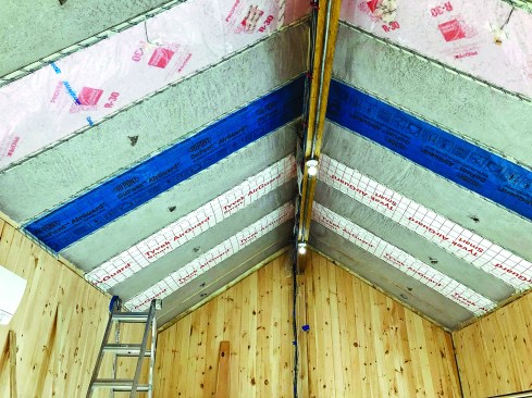

  2. If you use air-permeable cavity insulation (batts, blow-in or sprayed cellulose or fiberglass), you must install enough rigid insulation on top of the roof sheathing to provide condensation control (Table R806.5 sets up the R-value ratios by climate that define how thick this rigid insulation needs to be).
  3. If you choose a “hybrid” insulation system, the air-impermeable insulation must be against the roof sheathing, and the R-value ratio of air-impermeable to air-permeable insulations must follow Table R806.5 for condensation control.
  4. You can do a “Perfect Roof” with rigid foam only above the sheathing and with open framing cavities. (The term “Perfect Roof” was coined by Joe Lstiburek, who has also worked out important details for this assembly in snow regions. See the Building Science Corp. (BSC) article “Joseph Haydn Does the Perfect Wall” for more information.) If you put all your R-value topside of the roof sheathing, that topside insulation can give you enough condensation control (per 2015 IRC Table 806.5) to leave the roof assembly empty and completely open to drying to the interior.

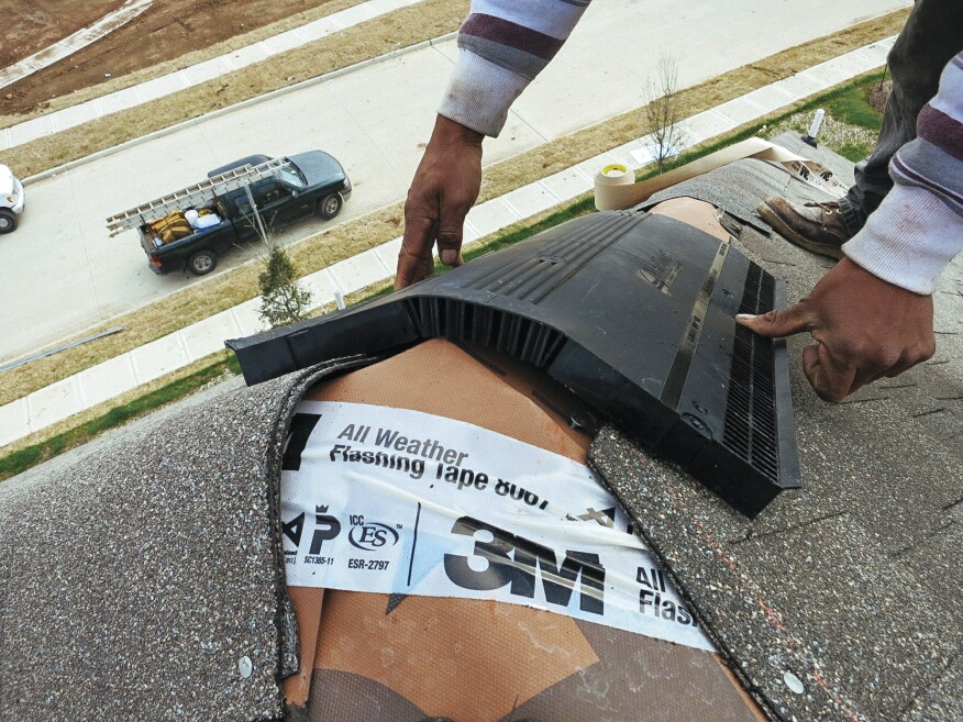

Based on SIP roof failures with moisture concentrating at the ridge (see BSC’s “Complex Three Dimensional Airflow Networks”), Lstiburek came up with a way to vent moisture in unvented roof assemblies when the roof assemblies are packed with air-permeable insulation: using vapor-diffusion ports at the ridge of sloped roofs.

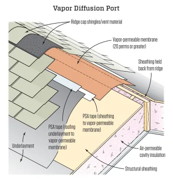

With the support of a host of other parties (including Building America, Dörken, DuPont, NAIMA, NuWool, K. Hovnanian, and David Weekley Homes), Lstiburek and BSC have done the field research to fully develop vapor diffusion ports for unvented roofs. This work is now reflected in the 2018 model codes, at least for climate zones 1 to 3. Per section R806.5.5.2, you can use air-permeable insulations in unvented roof assemblies in these climates so long as:
  1. You include vapor diffusion ports located within the highest 12 inches of the sloped roof.
  2. The ports comprise an area equal to or greater than 1:600 of the ceiling area.
  3. The vapor-permeable membrane over the ports has a vapor permeance equal to or greater than 20 perms.
  4. The vapor diffusion port is part of a continuous air barrier in the unvented roof assembly.
  5. The vapor diffusion port still protects the roof from blowing rain and snow.
In climate zones 1 to 3, installing vapor diffusion ports allows you to use air-permeable insulation only in an unvented roof. The ports must be installed to maintain the air barrier on the lid of the building and to keep out blowing rain and snow. (Illustration: Tim Healey / Building Science Corporation)

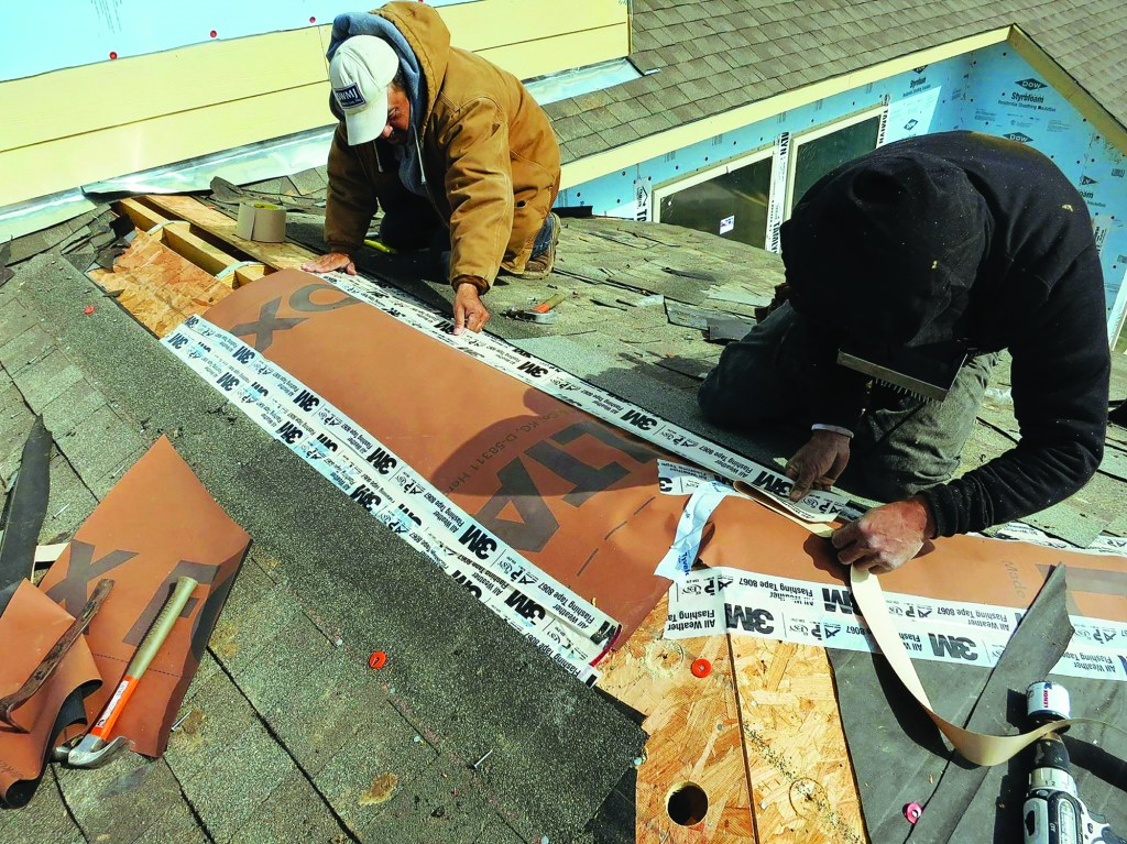

Vapor diffusion ports are located at the top of the roof and designed to relieve water vapor. They can be retrofit on an existing roof by converting an existing ridge vent, but you will need to cover the roof opening with a vapor-open air barrier, and block off any soffit vents or other vents lower on the roof. (Photo courtesy Building Science Corporation)
This all gets trickier in cold climates, so BSC has been conducting field research to determine just how the details of a vapor diffusion port will need to change for cold climates. Some of the strategies and considerations the BSC team is working on for cold climates include greater vapor permeance of the diffusion membrane; greater square area of the ports; the impact of different air-permeable cavity insulations; the impact of higher interior wintertime relative humidities. The photos at left show the BSC test hut where BSC is currently conducting much of this research.
When I asked Joe Lstiburek and Kohta Ueno of BSC when cold-climate vapor diffusion ports would be ready for building-code primetime, they both said it needs at least another year or two of data before any IRC code change proposals, but changes to the IBC may come earlier.
