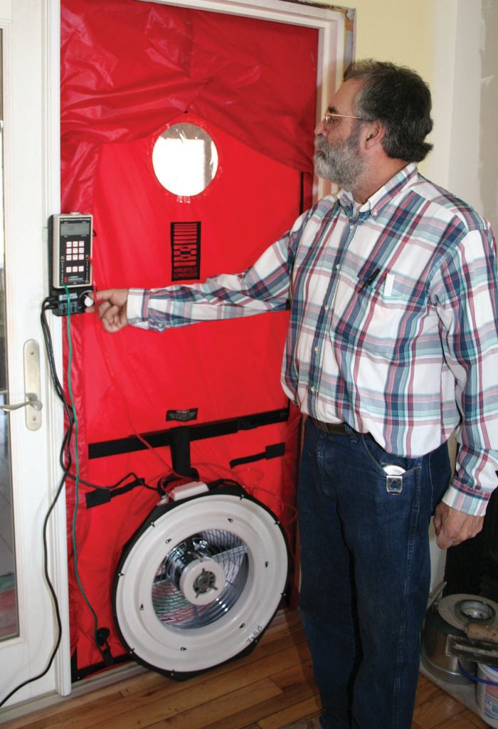

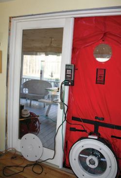

First developed in the 1970s as a research tool, a typical blower door consists of a powerful variable-speed fan mounted in an adjustable panel temporarily set up in a doorway. The fan moves air through the building in a controlled fashion, while a pressure gauge — connected to the fan and to the outdoors by small-diameter pressure tubes — measures the rate of airflow required to maintain the building at a certain pressure. The blower creates exaggerated air leaks, which can then be found with the help of tools like smoke puffers or infrared cameras, or even just by feeling with the face or the back of the hand.

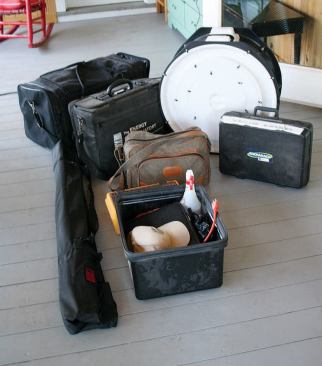

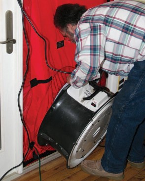

Blower doors for residential work now weigh less than 50 pounds and can be easily carried in a small trunk. A basic kit costs between $2,500 and $3,500 and can be set up, used, and repacked in a half-hour.
Equipment needed for comprehensive blower-door testing can be packed into a few easily-transported cases.

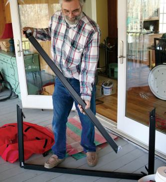

The blower door consists of an adjustable aluminum frame and a nylon panel.

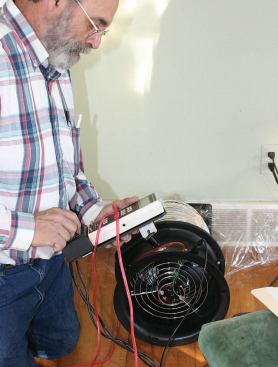

The panel is fitted with a powerful variable-speed fan.

To measure airflow, a closed-up house is depressurized with the blower-door fan to a constant pressure differential as compared with outside conditions, typically 50 pascals (Pa). A pressure gauge attached to the blower-door assembly measures the rate of airflow required to maintain that pressure differential in cfm (cubic feet per minute).

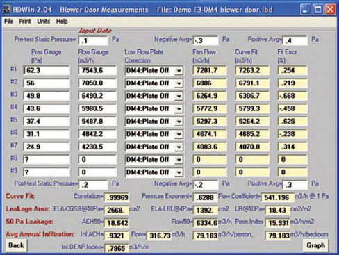

Blower-door testing can generate a detailed summary of a buildings airflow characteristics. Leakage can be expressed either as an equivalent hole size — called effective leakage area, or ELA — or as a ratio of leakage to shell area, or leakage ratio (LR), a useful unit for comparing the tightness of different building shells.
Sometimes several readings are taken at different pressures, then averaged and adjusted for temperature using a simple computer program. This provides the most accurate picture of airflow, including leakage ratios, correlation coefficients, and effective leakage area.
Most of the time, though, this detailed output isn’t needed, and all we want to know is how much the building leaks at the specified reference pressure of 50 Pa. So-called single-point testing is popular with crews who do retrofit work, because once the door is set up, it takes only about a minute to measure the effectiveness of their air-sealing strategies.

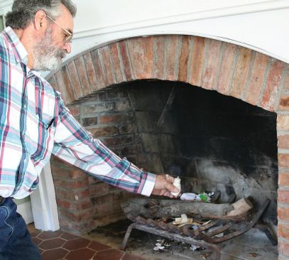

In a depressurized house, air will rush in through any available opening, so combustion appliances need to be shut down during a blower-door test to prevent backdrafting. Here, a smoke puffer indicates that the chimney flue is leaky even with its damper fully closed.

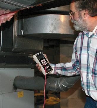

A digital manometer is used to measure the oilfired furnace's draft, or ability to vent combustion gases.
Checking for backdrafting. An analysis of a house’s airflow should include a check of all combustion equipment. Any device that uses indoor air for combustion must have an adequate air supply. The greatest occupant safety hazard — backdrafting — tends to be the result of excessive negative pressure caused by air-moving appliances. This works the same way as the blower door: A fan moves air out of a space, which produces a pressure difference relative to the outside. This fan can be one that is intended to remove air from the building — like a bathroom exhaust fan, range hood, clothes dryer, or central vacuum system — or it can be a fan that moves air within the building, such as a furnace fan. It can also be a combination of several fans or an exhaust force other than a fan, such as the heat-driven force of a chimney. If the negative pressure in a combustion appliance’s space is greater than the chimney draft (often only 3 to 5 Pa), the airflow in the flue will be reversed and flue gases will be dumped inside.
Although backdrafting tends to be more common in tight houses, it is also affected by the specific appliances involved and where they are located. Compartmentalization created by interior doors can contribute to the problem as well.
To check for the likelihood of backdrafting, I place the house in a worst-case condition, turn on the air-moving equipment, and either measure the resulting indoor-outdoor pressure or fire up the combustion device. Many testing protocols (such as the Building Performance Institute’s) specify a maximum allowed depressurization. If this maximum is exceeded, or if the appliance does not establish draft under the worst-case condition, some action must be taken to either improve the draft or reduce the depressurization so that flue gases are reliably exhausted outside.

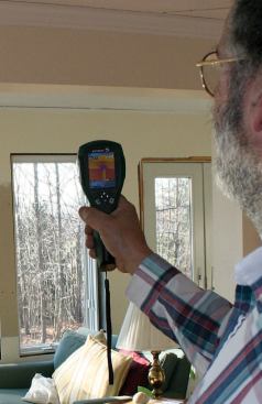

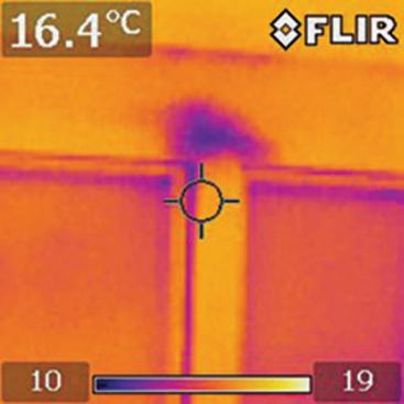

In addition to measuring total airflow, a blower-door test is useful for identifying specific leaks, since it can force the leaks to become more apparent. Larger leaks directly into the living space can be felt with the back of the hand from inside the house when the house is depressurized, typically to between 20 and 30 Pa. A smoke bottle or pencil is handy for finding smaller leaks and leaks from unconditioned spaces. Sometimes it’s more effective to reverse the airflow and pressurize the house. In general, airflow toward a person can be felt; airflow away is more easily found with smoke.
An infrared camera can be a handy tool during a blower-door test.
Air leaks around windows and doors typically appear as blue "fingers" on the IR screen, while blue patches indicate conductive losses from problems like thermal bridging, insulation voids, and moisture damage.
This demonstration can have a powerful impact on customers. When told that their main problem is not windows and doors but plumbing penetrations and attic bypasses, customers are often skeptical, but they become convinced when they actually feel the air pushing out from under their kitchen sink. Even people who understand almost nothing about their home’s thermal performance can easily tell the difference between small and large leaks when they feel them with their own hands or see them with their own eyes .
To get a sense of where the major leaks are, I depressurize the house with the blower door. I close the interior doors most of the way (one at a time) and feel for airflow around the doors. If major leaks exist on the other side of the door, I can feel the airflow at the door. If little or no flow is felt, the area behind the door is reasonably tight. This way, I can tell whether further investigation of an area is needed without even entering the room.
Crews who do retrofit work often leave the blower running for extended periods while they work, allowing instant diagnosis and feedback. Instead of sealing every hole that looks like it may leak, specific locations can be checked, sealed only if necessary, and rechecked to verify success.
It’s always more efficient to air-seal while the blower door is running than to conduct a blower-door test and then come back later. Attempting to itemize leaks in advance wastes time, since each leak has to be described on paper, understood by the crew, and found a second time. Many leaks take less time to seal than they require for access. In addition, crews without blower doors have no way to verify that their first attempt at sealing a given area has been successful (often it hasn’t been), nor can they determine whether a leak found by an auditor has already been sealed by other work done in the building (often it has).
Because crews measure results as they go along, blower-door–directed air-sealing makes it possible to determine how much effect a particular measure has had, or how much reduction has been accomplished in a given period of time. Workers become more productive because they can focus on areas where the best results are likely to be obtained. By establishing simple rules of thumb for cost-effectiveness, crews can determine when to stop retrofit work and move on to the next building, rather than continuing work with diminishing returns. In fact, a common worry for those who consider using blower doors is that too much time will be spent sealing leaks that are not important. But usually the opposite happens: Crews discover that some leaks they would have thought deserving of treatment are not, and they don’t waste time on them.
