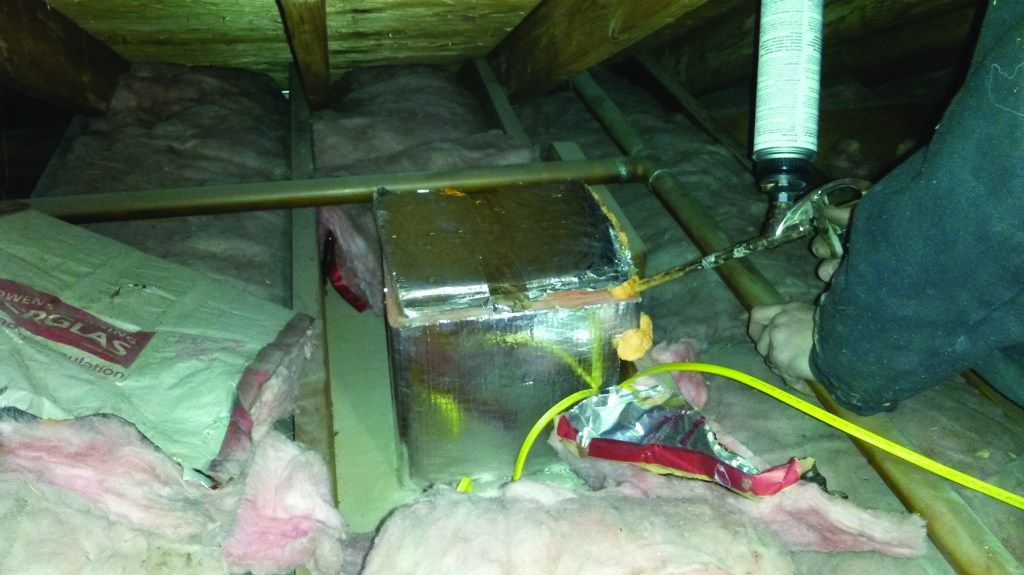

Many older can lights of this type are not rated for contact with insulation. In that case, the repair involves building a sealed box of rigid foil-faced insulation around the fixture, making sure the box is large enough to provide the required air space.

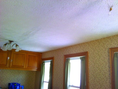

A water stain caused by an ice dam is clearly visible on the ceiling.

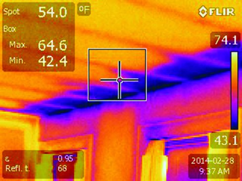

The infrared image reveals the cause: heat loss through the ceiling and roof of the kitchen bump-out.

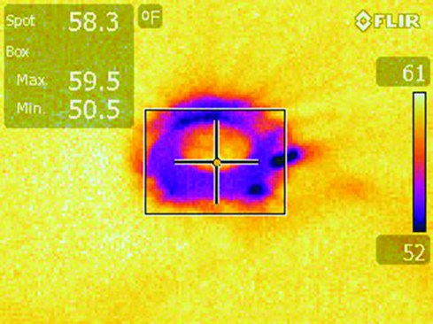

The photos on this page and the next show a few typical examples of situations that can be identified using a combination of blower door and infrared inspection: on this page, leaks in the ceiling of a kitchen bump-out and at the base of a wall in a bonus room above a garage, and on the following page, a leak in a recessed light fixture in a ceiling. For each example, I’ve paired a visible-light photo with an infrared image of the same location. The purple color in the infrared image shows the cold surface where the building is leaking. These photos were taken while the blower door was creating a negative pressure in the house, pulling cold air in through leaky spots.

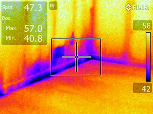

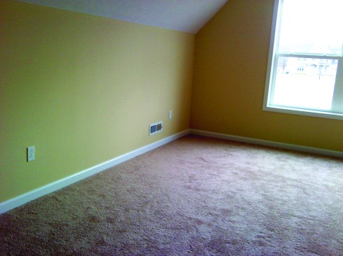

In the bonus room over a garage, a cold wall and floor brought comfort complaints.
The infrared camera revealed the cold air infiltration’s leak point.

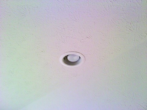

Recessed light fixtures in ceilings are a common source of heat loss in modern homes.
When a house is depressurized with a blower door, the infrared scan reveals tell-tale “fingering” as cold air gets pulled along the ceiling.

Next I set up the blower door and depressurize the house, then walk through again to identify the effects of air leakage. If areas that were cold have grown and spread, or gotten colder, I know that air infiltration is a factor. In this way, operating the blower door together with the infrared camera lets us identify deficiencies in the insulation, as well as a lack of air-sealing. In the case of recessed lights, air leakage shows up as what we call “fingering,” where wisps of cold air are being pulled in through the recessed light and across the drywall, as in the infrared image on the facing page.
