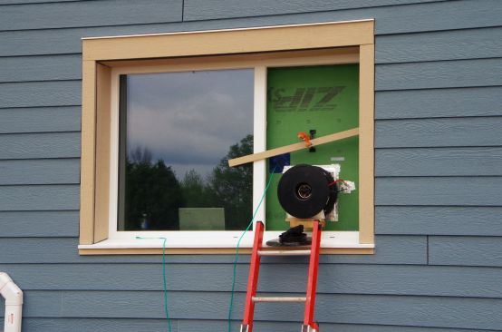

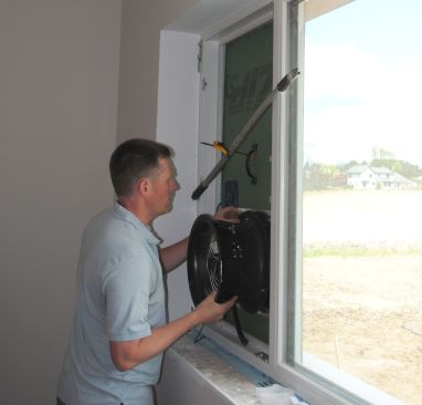

But for his first tests, with the door and window openings sheathed over and no doors or windows installed, Bowers had only one opening for placing his test fan: a basement window hole that was too small to hold a standard blower door. That’s when Bowers decided to use a Duct Blaster fan instead. “So for our first couple of tests, we taped the Duct Blaster to a sheet of rigid foam insulation over the basement window hole, and the foam board was foamed in place with the one-part fire-rated foam,” said Bowers.

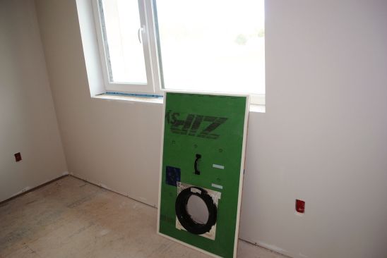

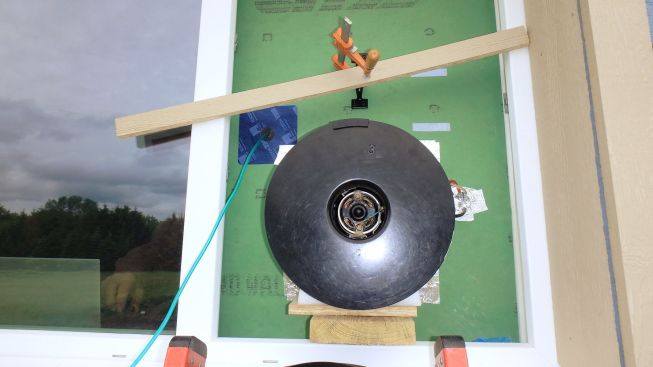

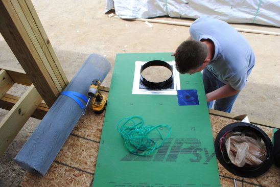

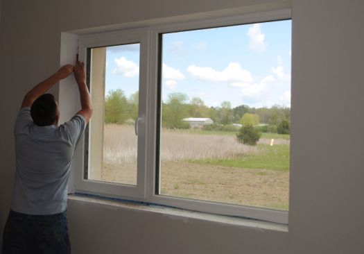

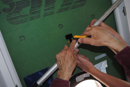

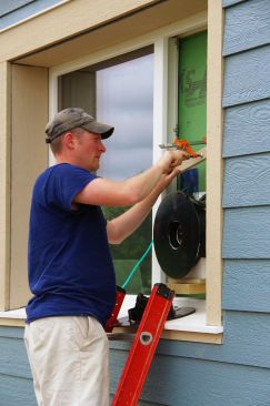

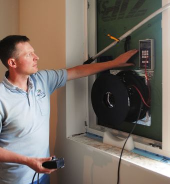

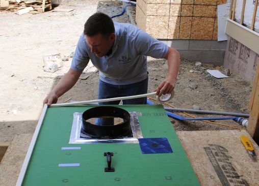

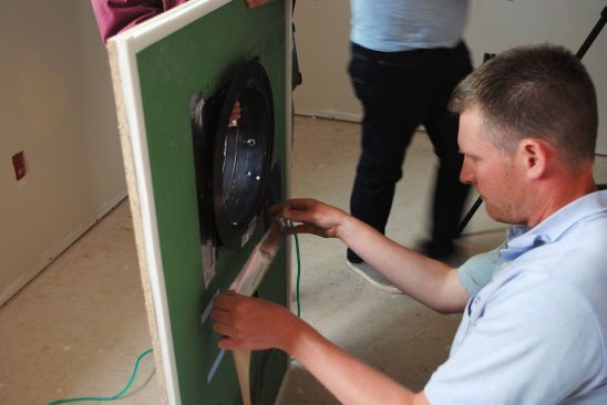

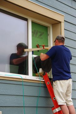

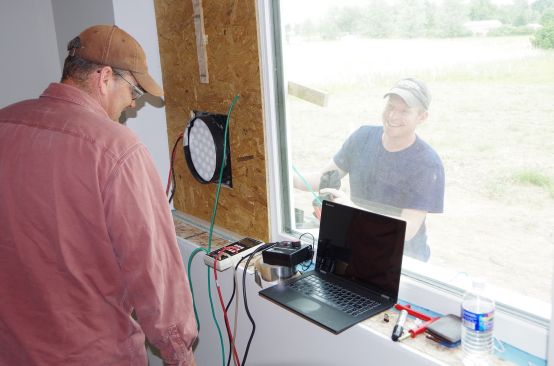

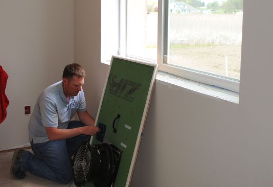

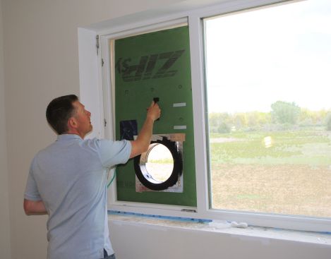

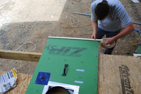

As the job progressed, Bowers installed a window in the basement opening, along with the rest of the home’s doors and windows. But the operating doors in the main walls were too large for a standard Minneapolis Blower Door’s telescoping framework. So Bowers stuck with the Duct Blaster, crafting a custom testing assembly from a scrap piece of Zip sheathing and some other handy materials. He made his Duct Blaster frame to fit a window unit that he had installed in six places, so that he would have a choice of test fan locations.

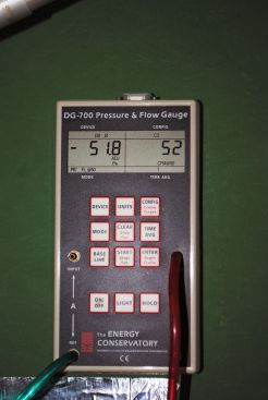

On his first test, Bowers was hoping to score well below 0.6 ACH50. But his results far exceeded those expectations. “The first test came back at .15 ACH50,” he said, “and to be honest with you, I thought it might be a mistake. I was concerned that we had set the test up wrong, because I had never done a blower-door test with a Duct Blaster. So I talked to Energy Conservatory, which supplied the device, just to be sure that everything was set up right. And they verified that the setup was correct.”

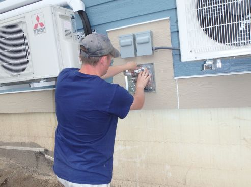

That first successful test didn’t leave Bowers with a punch list—everything seemed to be fine. He ran another test after installing windows and doors, and again after installing air ducts and lines through the envelope for the Zehnder energy-recovery ventilator and a pair of Mitsubishi heat pumps. “And it was funny,” said Bowers, “but—everything I had read said, ‘Your tightest blower door is going to be the first one that you do, when there are no holes in the system.’ But not us—the more holes we made, the tighter it got.” Bowers gives credit to the project general contractor, builder Tad Garbacik: “I would not have been able to achieve these results without him.”

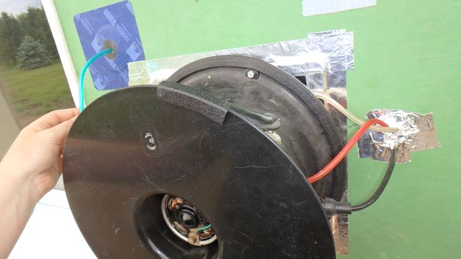

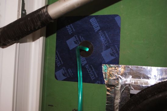

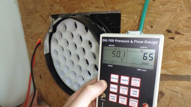

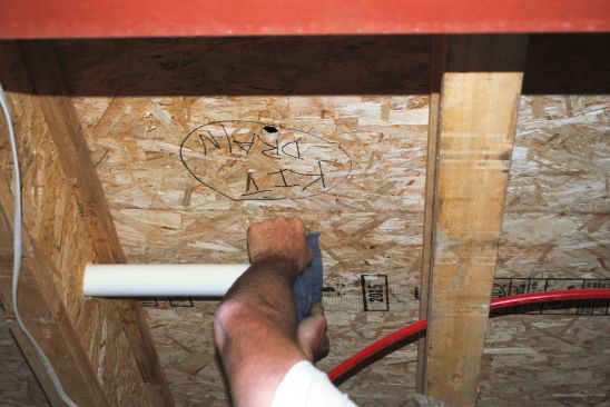

As the house nears completion, Bowers is continuing to test. In June, he ran another Duct Blaster test, as well as a standard blower-door test (using extra tape to fit the blower door into the building’s oversized door). At 50 pascals of pressure, airflows measured from 50 to 65 CFM—about 2 1⁄2 square inches of equivalent air leakage area, Bowers calculated. It’s hardly worth worrying about, but Bowers said there were a few things to keep an eye on: “We’ve got temporary holes for temporary power outside. We’ve got plumbing that hasn’t been finished yet. We’ve got windows that need to be opened and the frames need to be wiped clean because of construction dust.” Still, with results this good, Bowers is into the zone where the test apparatus itself may be responsible for most of the air leakage. “Making sure that the compression on the gasket was tight to the window, and everything was taped and sealed,” he said, “that’s where we actually spent most of our time.”
