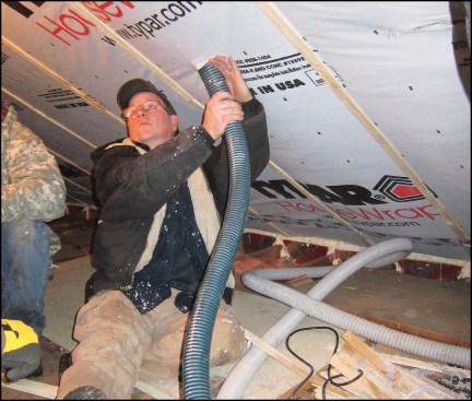

In existing construction, weatherizers typically dense-pack cellulose behind strapped housewrap.

In new construction, I recommend using Insulweb, a tough air-permeable polypropylene fabric, to hold the cellulose in place. Insulweb has several advantages. For one thing, it gives you unlimited air relief. We have difficulties sometimes when we’re blowing behind an air-barrier membrane such as Intello, because it doesn’t let the air out. So we end up cutting air-relief slits in the membrane, and then taping back over the slits afterwards. Insulweb eliminates this extra step.

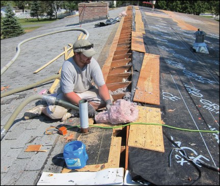

Where access from below is impractical, cellulose can be dense-packed into existing rafter bays from the roof ridge.
In new construction, the author recommends packing the material behind strapped Insulweb fabric.
In addition, Insulweb allows you to feel the density of the cellulose as you install it. At 3.5 lb./cu.ft., the cellulose has the feel of a firm mattress, while at 4 lb./cu.ft., the cellulose starts to feel hard to the touch. The translucent properties of Insulweb allow you to visually keep track of your progress as you work. In the density range that we’re talking about, if the material is too loose in the cavity, you’ll see layering lines in the cellulose—an indication that the density is not sufficient. Again, this is a situation where training and experience are necessary to ensure a good installation.

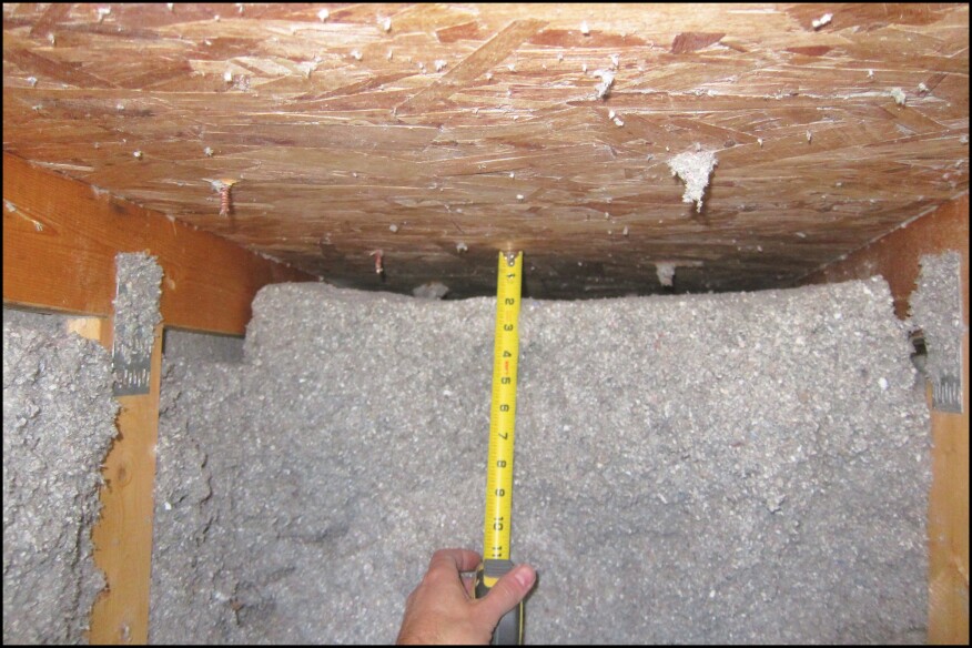

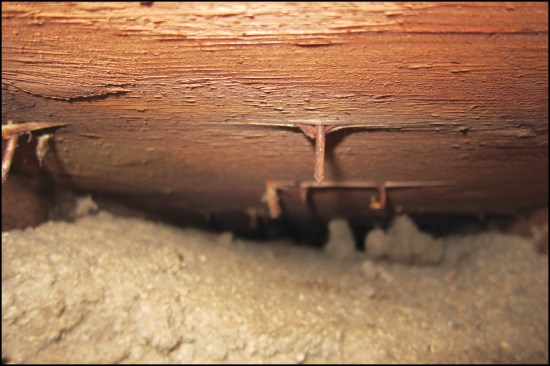

Later, when I was working for National Fiber, I was called in on about four complaints. In every case, the cellulose in the rafter cavities was insufficiently dense and had settled away from contact with the roof sheathing. Moisture infiltrated the cavity during winter, passing through the cellulose to the air space and condensing on the underside of the roof sheathing. In a couple of cases, we caught the problem early enough that there was no damage to the roof sheathing, and we could simply re-tube the cavities and pack the material to its proper self-supporting density. In the other cases, there was damage, and the sheathing needed to be replaced.
Here, cellulose that was installed at an insufficient density to be self-supporting has settled away from the roof sheathing. According to the author, this allows moisture migrating through the material to condense on the underside of roof sheathing. The sheathing shown above was not damaged, but …
… this sheathing had to be replaced.
Here’s what’s happening: In a correctly installed dense-pack, the cellulose stays in contact with the roof sheathing. This allows the material’s hygroscopic properties to come into play. Moisture migrating through the material that approaches the sheathing is reabsorbed into the drier cellulose and diffused away from the surface. In addition, the borate fire retardant in the cellulose inhibits fungal growth, protecting the sheathing.
