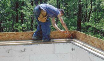

Over time, the test results have shown us where to concentrate our air-sealing efforts during framing. Fortunately, what’s required adds little time or effort to the standard workflow. Instead of ordinary sill sealer, we use a rubber (EPDM) gasket between the foundation and mudsill.
The 5 1/2-inch-wide gasket is designed to provide a positive seal under a heavy structural load; it also serves as a moisture barrier between the concrete and wood. After setting, stringing, and squaring the rim joists, we run a bead of construction adhesive over the joint between rim and mudsill. We’ve tried EPDM gaskets under the rim, but they tend to get in the way. Adhesive is less expensive and nearly as effective. It’s important to take this step before rolling the floor joists into position; otherwise, rim sealing becomes a long, hard slog. Glue-and-nail subfloor installation has become standard industry practice. However, not everyone glues the edge of the rim joist on the assumption that the walls hold the subfloor down at the edges. In fact, this is a common point of air entry, which we handle with a continuous bead of adhesive. We frame and sheathe the walls on the deck before standing them on a rubber gasket tacked around the perimeter of the deck. I buy my gaskets from Resource Conservation Technology (410/366-1146, www.conservationtechnology.com) and Denarco (269/435-8404). These companies carry a good selection of gaskets designed for sealing a variety of framing configurations.

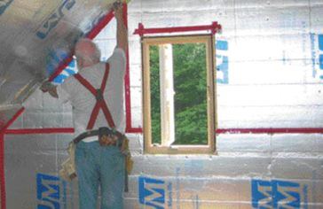

Because I’m convinced that air doesn’t move through plywood, I sidestep the whole housewrap debate. Instead, shortly before installing the siding, we tape all the horizontal seams and any other cuts in the sheathing that aren’t backed by framing. We use either DuPont Contractor Tape (DuPont Tyvek, 800/448-9835, www.tyvek.com) or 3M Builder’s Sealing Tape (3M, 888/364-3577, www.3m.com) or both.
