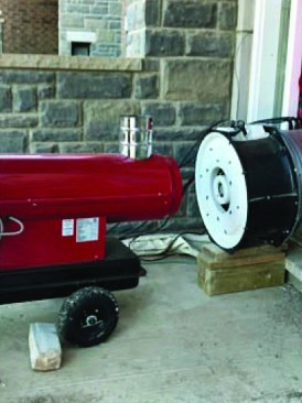

Gorde provided a detailed explanation of the AeroBarrier rig he uses (“a well-thought-out, self-sufficient trailer” that hauls all the apparatus required, including a generator, compressor, control module, and the “peristaltic,” or roller, pump used to deliver the sealing material), and of the process (namely the sealing off required, before starting to deliver AeroBarrier sealant, of holes and gaps you don’t want to seal, like vents and unfinished plumbing hook-ups, and the protection of “everything you don’t want to have to clean the sticky stuff off of”).
A portable heater blows directly into the blower-door fan—Gorde Cooke’s solution for extending the installation season for AeroBarrier in a cold climate.
Gorde Cooke
The “big aha” for me hearing Gorde’s insights from the field came when he got into the fine detail on seal time. AeroBarrier coagulates around the edges of building leaks when the air increases velocity as it escapes through a hole. Thus, the size of the hole is a key limiting factor. The sealant is carried in a manufactured fog (water vapor) and the amount of sealant that can be pumped into a building without the vapor condensing is also affected by the outside temperature and relative humidity, indoor relative humidity, and house pressure. These limits are monitored by the control module, and everything works swimmingly in the Toronto region until around October when the outdoor temperatures get cool enough that the system doesn’t have enough heat to keep that indoor air above the dew point when the blower door is blowing outdoor air inside to pressurize the building. Gorde’s ingenious way to extend the installation season in a cold climate is to use a salamander heater in the path of the blower door’s intake (see photo above).
It’s on this point that Gorde largely answered the question of when it’s best to seal: before insulation, when you can seal the framing shell, or after drywall? For much of the season in a northern climate, it’s best to seal after drywall (which is also after MEP rough-in and insulation and when the building can be heated). Sean Harris of AeroBarrier of Austin, Texas, was on hand in the audience to provide the flip-side experience: In a warm climate, it makes more sense to seal the framing shell before insulation and drywall—a chief reason being that it’s just a whole lot faster to prep the building because you don’t have to worry so much about protecting surfaces. (Definitely, a big part of Summer Camp is the caliber of the audience!)

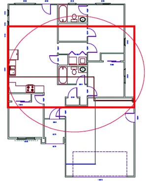

Hot-water-piping update. As a result of Gary Klein’s Summer Camp presentation, JLC is at work on an update to Gary’s JLC classic, “Efficient Hot-Water Piping” (Mar/13). Stay tuned for that in the near future. I won’t go into a lot of detail now, except to explain a useful concept for designing an efficient hot-water system that Gary refers to as “architectural compactness.” In a detailed study for the California Energy Commission aimed at developing code-change recommendations to improve the energy efficiency of hot-water systems, Gary’s team had to analyze the draw patterns (the frequency of occupants turning on their faucets and drawing hot water from the water heater).
The general idea is that every time you draw hot water into a pipe, hot water stays in the pipe and heat dissipates out of the system, whether or not the pipe is insulated (insulation reduces how fast heat dissipates, but if hot water just sits in the pipe, there is still a loss over time) and whether or not any hot water actually reaches the faucet. For the study, as a way of rating the hot-water efficiency of houses built in California, Gary’s team analyzed thousands of floor plans of completed homes and derived a ratio (expressed as a percentage) for each plan of the hot-water-system rectangles (the area encompassed by the hot-water heater and all fixtures drawing hot water) to the overall floor area of the building. The lower this number, the more efficient the hot-water system. A typical system (shown above center) has a ratio of 79%, and the plan with a single plumbing wall (above right), about 0.8%.
In Gary Klein’s study of hot-water-piping efficiency, he analyzed floor plans for “architectural compactness.” A typical plumbing layout ropes in 1,279 sq. ft.
Gary Klein

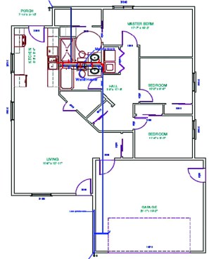

An excellent layout covers less than 10 sq. ft.
Gary Klein

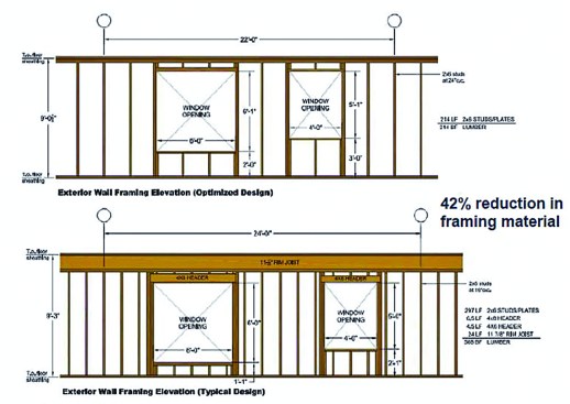

Even more advanced framing. Mike Steffen of Portland, Ore.- and Seattle-based Walsh Construction, a major Pacific Northwest (PNW) builder of large multifamily housing projects, provided a fascinating case study on seeking “radical simplicity” for lowering construction costs. In keeping with a true vision of housing affordability, the case-study project is built to near Passive House Standards, so that the living, not just the rent or mortgage, is affordable for occupants.
In the last few years, there has been an extreme escalation in the cost of multifamily housing in the PNW (and elsewhere), in part because the multifamily housing market is booming—subcontractor schedules are full and subs are increasing their margins, and the shortage of skilled labor has slowed production schedules. The result, Steffen reports, has been a 5% to 15% escalation in building costs annually for the last two years. These conditions have forced Walsh to pursue serious “cost discipline” for the 68% or so of a building’s costs that a builder “controls” (acknowledging that “cost control,” per se, is not really possible).
Walsh Construction’s efforts to optimize framing led to the wall framing system at top (compared here with typical northwestern wall framing, above) that achieves a 42% lumber reduction. Rather than a rim joist, 91/2-inch joists are hung from the top plate, saving lumber, eliminating a thermal bridge, and reducing labor for installing drywall on the interior.
Walsh Construction
This project needs its own article, but the gist is that Walsh has used the project to explore “cost-efficient design and construction” (CEDC) practices. These aim at optimizing building layouts and finding simple designs for the hidden elements that comprise 80% of a building (such as the structure, enclosure, hidden exit stairways, MEP systems, and the like) and making the most of the 20% of the building that is directly experienced by occupants (such as the building plan, public stairways, community rooms, public roof decks, and so on). Mike is keen on emphasizing that CEDC is not a race to the bottom, which is often what happens when developers seek affordable solutions but end up providing rather grim living experiences instead. Look for more from us on CEDC. The illustration above gives a taste of its practicality for all wood-framed buildings.
