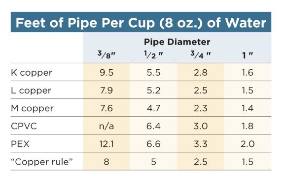

Minimizing the volume of water in the piping between the hot-water source and each fixture is one key to reducing waste in a hot-water system. To find the volume of water contained in piping runs of various diameters, divide the total length of each trunk, branch, or twig by the corresponding ft/cup value. For quick approximations, divide by the “copper rule” values in the bottom row. An efficient layout for copper will perform even better with CPVC or PEX.

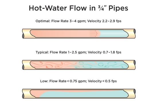

Flow rate affects how hot and cold water interact in the piping during hot-water delivery. A flow rate of 3 to 4 gpm creates a “plug flow” (top), which pushes cold water out of the pipe without much mixing, minimizing wasted water and time-to-tap. At low flow rates (bottom), a thin stream of hot water rides up on top of the cold water (or spirals around it) and cools quickly; up to twice the standing volume of water must flow through the pipe to achieve the desired temperature. At flow rates typical for many fixtures (center), hot and cold water mix reasonably well, but up to 1.5 times the standing volume of water in the pipe must flow through before hot water arrives.

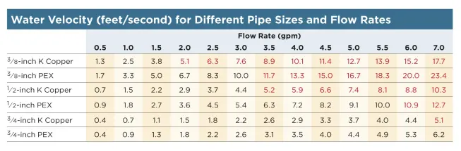

Pipe sizing is determined by the flow rate of each fixture in gallons per minute (gpm) and the maximum acceptable velocity (in feet per second) of the pipe used to serve it. Note that velocity increases as pipe diameter decreases. Numbers in red exceed the recommended maximum hot-water velocity of 5 ft/sec for copper, or 10 ft/sec for PEX and CPVC (not shown).
Keep in mind that hot-water pipes no longer have to carry a large volume of water. Most homes now have water-saving 2.5-gpm showerheads and 2.2-gpm faucets, while fixtures that conform to the EPA’s WaterSense program have even lower flow rates.

Velocity and flow rate. Some rural homes served by wells may have less than 35 psi of static water pressure, in which case friction loss is a real concern, and pipes must be sized to maintain pressure. But static water pressures of 40 psi to 80 psi are now required under most plumbing codes, making pressure drop less of an issue. In houses where system pressures are greater than about 50 psi, pipe sizing should be dictated by the maximum allowable velocity.
To avoid excessive noise, erosion, and water hammer, the Uniform Plumbing Code (UPC) limits water velocity to 5 ft/sec in copper pipe and 10 ft/sec in most types of plastic pipes. Since hot water behaves differently at different flow rates, the optimal water velocity in hot-water piping is between 3 ft/sec and 4 ft/sec.
The flow rate through a hot-water pipe depends mainly on the pipe’s interior diameter and the velocity of water moving through it. Decreasing the diameter of a pipe while maintaining a given flow rate increases the water’s velocity. You can see from the charts prepared by the Oak Ridge National Laboratories for different types and sizes of pipe that the velocity increases rapidly as the flow rate increases in a given diameter pipe. Many combinations of flow rate and diameter result in unacceptable pressure drops. Picking the right pipe diameter minimizes the loss of water, energy, and time spent waiting for hot water to be delivered to a fixture.

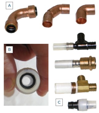

Fittings
Tees, hard 90-degree elbows, and other flow-restricting fittings create friction and add to the equivalent length of piping. For example, a 20-foot length of pipe with 10 elbows is equivalent to 40 feet of straight pipe. Replacing right-angle elbows with wide-radius sweeps (A) will lower pressure drop and improve performance. In fact, I’ve observed that if the radius of a bend is at least 10 times the nominal pipe diameter, water in the pipe behaves as if the pipe were straight (though I don’t think this has ever been tested properly).
One of the advantages of PEX pipe is that it bends, so fittings aren’t required to make changes in direction. Copper tubing can also be bent, though it’s not common practice. In all cases, it’s important not to deform the pipe when bending it, which will restrict flow as much as a fitting.
Whenever possible, I try to minimize the number of fittings except for the tees needed to serve branches and twigs. When installing PEX piping, I recommend “outie” expanded PEX fittings (B), which maintain the internal diameter of the piping, rather than standard “innie” insert fittings (C), which restrict flow.

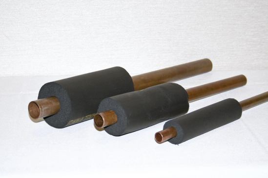

Pipe insulation prevents heat loss and improves system performance, especially when pipes are located underground or outside the thermal envelope. Wall thickness of the insulation should at least equal the nominal diameter of the pipe.
Gary Klein
Insulation. Besides increasing pipe lengths, these practices have energy consequences. Water in uninsulated piping loses heat five to 10 times more quickly under a slab than in room-temperature air. For this reason, I think it’s better to run piping for single-story slab-on-grade houses within the thermal envelope, either in the ceiling framing or buried within the attic insulation. Unless the ceiling will be insulated with blown-in insulation, the pipes should be wrapped with pipe insulation.
Most local codes don’t require insulated hot-water pipes unless there is a circulation loop, but they should. When hot-water events on the same twig, branch, or trunk occur between 10 and 45 minutes of each other, insulation significantly lowers the time-to-tap by reducing the rate at which the water cools down. For example, R-4 insulation doubles the cooldown time of 1/2-inch pipe, and triples the cooldown time of 3/4-inch pipe. In addition, insulation reduces temperature drop between the water heater and the fixtures while hot water is being used, regardless of the time between uses.
The 2012 IECC (R403.4) now requires minimum R-3 pipe insulation for most hot-water piping. My rule of thumb has been to size insulation thickness so that it is equal to the pipe’s nominal diameter. If you’re using hardware-store-variety polyethylene pipe sleeves, check their R-value; some 1/2-inch wall pipe insulation is rated as low as R-2.2.
When installing pipe insulation, slightly compress the sections lengthwise and seal the joints at the slits and between sections. (If you use foam pipe insulation that doesn’t comes with integral sealing tape, check with the insulation manufacturer for the recommended sealant.) Orienting the slits so that they face down will prevent the sleeves from falling off the pipe if the sealed joints fail.

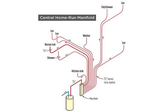

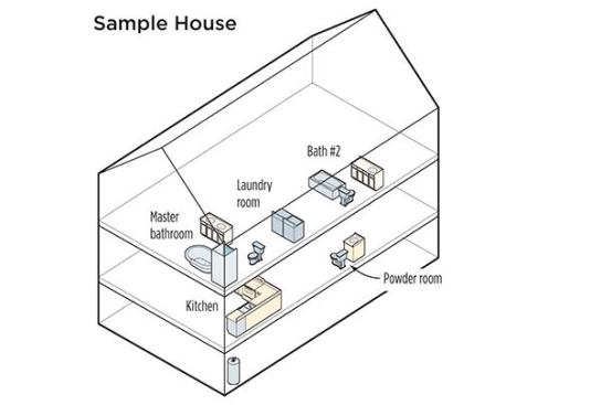

Comparing Efficiency in Three Hot-Water System Designs

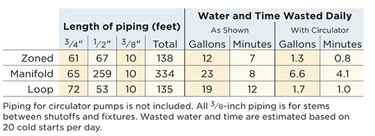

These schematic diagrams illustrate three different hotwater distribution system designs for a sample house based on the piping requirements shown in the table (bottom). The Zoned Trunk and Branch approach wastes the least water and has the shortest total time-to- tap. The table also shows that, regardless of the system design, adding demand-controlled circulator pumps (not shown) dramatically improves efficiency.
Performance
To illustrate the advantages of high-performance distribution piping, I’ve compared the performance of three different plumbing configurations in the same floor plan. In each case, the water heater is located in the same place in the basement, and I’ve evaluated performance both with and without on-demand circulator pumps. These could be located either at the hot-water heater, which would require a dedicated return line for each zone, or underneath a fixture, in which case the cold-water line would act as a return. (To keep the schematic simple, the pump locations are not shown.)
Zoned trunk-and-branch. In our example, the location of the water heater created a two-directional plumbing configuration, with one trunk line going up to the second-floor master bathroom and the other going past the kitchen and powder room on the first floor, then up to Bath #2. Depending on how the upstairs laundry room is supplied with hot water (our example shows it supplied from the master bath), this layout contains about 61 feet of 3/4-inch pipe, 67 feet of 1/2-inch pipe, and 10 feet of 3/8-inch pipe (these are stems from the angle stop to the fixture), for a total of 138 feet. Assuming an average total of 20 daily cold-start events, this system performs reasonably well, wasting about 12 gallons and seven minutes per day. However, 12 gallons is about 20% of the daily hot-water volume used by a family of three. With proper use of a circulation pump, waste drops to 1.3 gallons and 0.8 minutes. This is better than the two alternative designs, even when they include use of circulator pumps.
Central home-run manifold. In this configuration, one trunk line runs from the water heater to the manifold, then individual twigs run from the manifold to each fixture. At 334 feet of pipe, this layout uses almost two-and-a-half times as much pipe as the other configurations. (It is likely to have a similar amount of cold-water piping, too.) This system would waste about 23 gallons and 14 minutes per day for cold-start events (6.6 gallons and 4.1 minutes with a circulating pump).
Single-loop circulation. The third configuration consists of a single trunk line that goes upstairs to the master bath, through the laundry room to Bath #2, then down to the powder room; the kitchen is on its own branch. This layout contains a total of 135 feet of hot-water supply pipe, the least of the systems evaluated. However, when operated without an on-demand pump, it would waste about 19 gallons and 12 minutes per day for cold-start events, the second-worst-performing system evaluated. With the pump in operation, waste drops to 1.7 gallons and 1 minute per day, making it the second-best-performing system.
Choosing the best design. Thanks to a compact wet room layout (unusual for a modern house), the zoned trunk-and-branch system performs quite well for both cold- and hot-start events. Splitting the floor plan into zones is a good strategy for reducing the volume of water in trunk lines, but if the plumbing is ever upgraded with on-demand hot-water circulation, it will require separate pumps for each zone.
The central home-run manifold system requires more pipe and does not perform as well as the other configurations evaluated. The biggest drawback to a manifold system is that it is difficult to improve performance significantly without multiple on-demand circulation pumps, one for each fixture.
In this house, the single-loop circulation configuration contains the least amount of pipe (second smallest if the pump is located at the water heater), but without an on-demand pump it actually wastes almost as much water and time as the central home-run manifold system. On the other hand, it would probably be the least expensive system to install, since it contains the fewest feet of pipe and only one pump.
