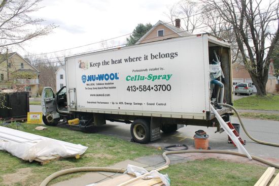

The key piece of equipment needed to install cellulose is a box truck equipped with a powerful blower that mixes the fiber with air and distributes it through a hose that’s typically 3 inches in diameter where it exits the truck. My company has two trucks, one of which is equipped with a large vacuum cleaner and a water tank for working with spray cellulose. We also have a van we use for doing prep work. Between the two trucks, we can blow more than 500 bags of insulation a day when everything is going well.
Cellulose comes in compact 30-pound bags. To prepare it for use, the material is unwrapped and tossed into a hopper in the back of the truck, where rotating paddles break it up from beneath. An auger feeds the finely shredded material to the blower.

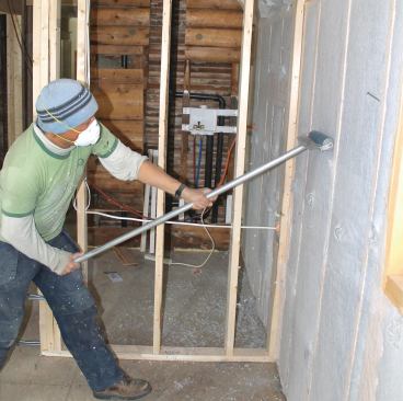

The damp cellulose is ordinarily sprayed to slightly beyond the full depth of the framing; because the material becomes even more strongly bonded as it dries, the excess is shaved off with rotary scrubbers soon after it’s applied. As the scrubbed-off cellulose accumulates on the floor, it’s vacuumed back into the truck and combined with fresh material for reuse. The adoption of high-pressure pumps has reduced the volume of water used and dramatically speeded drying time. Cellulose manufacturer National Fiber, for example, now provides a 24-hour drying-time warranty.

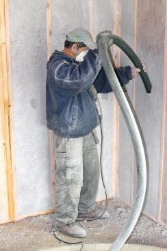

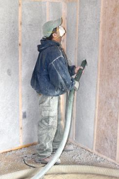

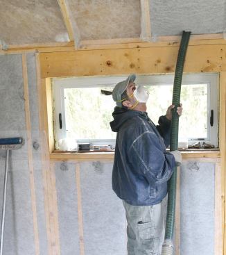

If you force enough loose-fill cellulose into a confined space under enough pressure, you end up with dense-pack — a firm, compact material that can’t settle and is very resistant to air infiltration. It can be blown into closed framing cavities — the approach most often used in retrofits — or open ones that have been closed on one side with netting.
The obvious benefit to the closed-cavity method is that you can insulate an existing structure without gutting it first. On the other hand, progress is slowed by the need to seek out and fill every framing cavity, including oddly shaped or unexpected ones tucked behind blocking or diagonal braces. And because cellulose can’t be packed into a space any faster than the air can escape, trying to force in too much material in too little time can yield a product that falls short of the required density of 3.5 to 4 pounds per cubic foot, or that bows out existing drywall or plaster.
Some installers will tell you they can dense-pack cavities that contain existing fiberglass, but I find that trying to do this always leaves some voids. When we have to deal with a previously insulated wall, we’ll remove a 2-foot strip of drywall at the bottom or a strip of sheathing on the outside, pull out and discard the batts, then net the opening before blowing the empty cavities.

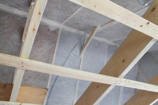

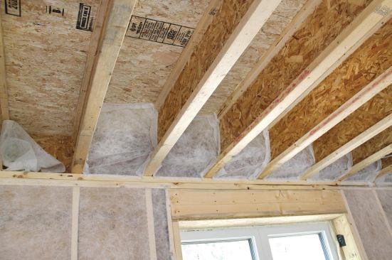

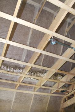

In new construction and gut retrofits, our preferred approach is to fasten netting over the entire frame and blow the cellulose behind the netting. Like damp-spray, this offers complete quality control, since the packed material can easily be seen and felt after installation. The permeable netting gives the air in the cavities an easy route of escape, making it possible to fill the cavities quickly.
Netting the Frame

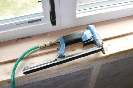

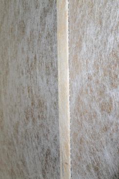

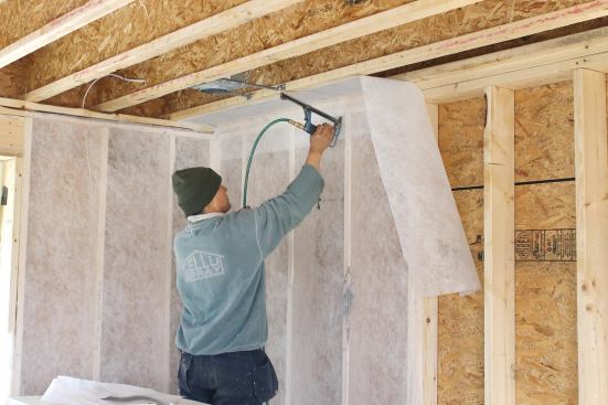

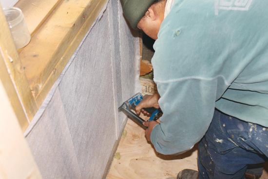

Cellulose netting is a tough, lightweight, nonwoven fabric. It comes in long rolls of varying widths, and is fastened to the framing with staples. We use pneumatic upholstery staplers for this, which fire off staples at high speed for as long as the trigger is depressed.

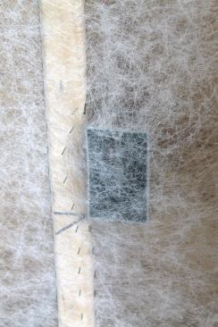

After cutting a sheet of netting, stretching it tight, and tacking it in place, we “stitch” a continuous line of staples along each side of the framing members to prevent the insulation from forcing its way between the netting and the face of the framing and interfering with the drywall. This takes practice, because the spacing of the fasteners depends on how quickly the operator moves the stapler — too slow, and they’ll be so close together that they’ll create a line of weakness in the netting; too fast, and the spacing may be wide enough to allow some cellulose to leak between staples onto the face of the stud.
Open expanses of wall can be netted fairly quickly, but the work slows down when cathedral ceilings, collar ties, dormers, and other irregular areas are involved. On most jobs, it will take about twice as many man-hours to install the netting as it will to blow the cavities.
