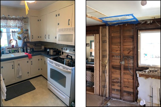

I’m a project manager for DBS Remodel, a residential remodeling company based in Poughkeepsie, N.Y. A few months ago, in the midst of remodeling a kitchen, we came across what we believed to be vermiculite insulation above the room’s plaster ceiling. Upon discovery, we quickly sealed up the ceiling with tape and plastic and notified the homeowners. Our clients had chosen to remain in their late-1950s Cape-style home during the remodel, so we felt a sense of urgency when reaching out to asbestos abatement companies to confirm our find.
“Before” image of the kitchen in the client’s late-1950s Cape-style home (left). Work stopped when vermiculite was found in the ceiling; the author quickly sealed off the demo hole and around a ceiling light after its discovery (right).

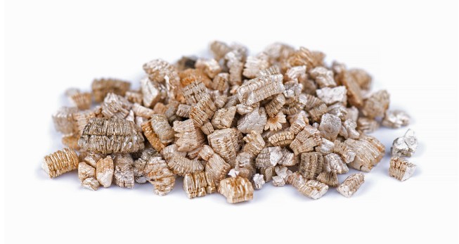

Kevin Mathisen of Lucas Environmental Services out of Kingston, N.Y., made a jobsite visit and verified that the light granular insulation was vermiculite. He noted that while it may or may not contain asbestos, a substantial amount of vermiculite that had been sold throughout the U.S. under the trade name “Zonolite” contained varying amounts of asbestos. As a result, New York state regulations assume vermiculite to be an asbestos-containing material.
Sample of vermiculite insulation.
Size matters. Our client’s kitchen was 150 square feet and Mathisen explained that New York state defines any work under 160 square feet as a “small” abatement project (square footage is used to estimate asbestos-tainted materials like floor tile or vermiculite, while linear footage is used for materials like pipe insulation). For abatement projects, square footage is one of various regulatory thresholds that impact the scope of the asbestos mitigation work. Even “small” projects require the rigors of a licensed abatement contractor setting up a containment area, removing the asbestos, and demobilizing the work area. In addition, baseline air testing, visual inspection of the containment, visual inspection of the completed removal area, and collection of final air samples must be conducted by a third-party air monitoring firm to avoid conflict of interest.
The estimate was $6,400 for the abatement work and an additional $800 for monitoring-supervising services. While the homeowners noted that neighbors up the road had just renovated a home similar in style and vintage to theirs and didn’t have an asbestos abatement, our clients quickly came to appreciate the steps we took to bring Lucas on board and that the vermiculite would be removed properly, even though it would add to the project’s cost.

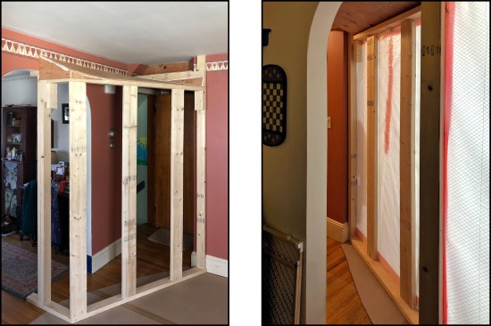

The abatement. The separation wall between the kitchen and the rest of the living area had to be beefier than a standard ZipWall dust barrier, so I framed a temporary wall out of 2-bys—on which Lucas later installed a double layer of woven reinforced plastic—in the middle of an open archway. This gave the clients access to their bathroom and bedroom areas.
A temporary 2-by wall was framed in the middle of an archway to isolate the kitchen and to allow access to the bathroom, bedrooms, and basement (left). A double layer of 6-mil poly is installed on the framed wall by the abatement contractor (right).

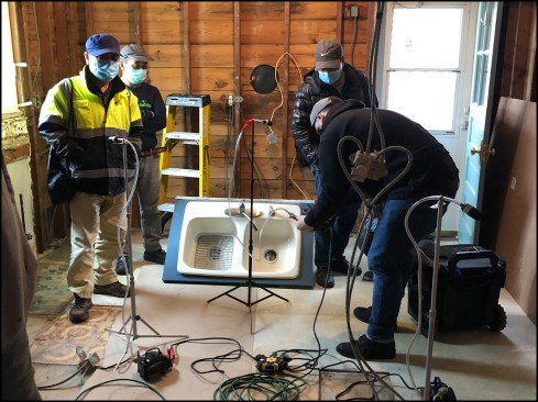

Once the third-party monitor, JPM Environmental Solutions, out of Newburgh, N.Y., had conducted baseline air testing, Lucas set up its containment shell and warning signage and cordoned off outdoor work areas. Wearing Tyvek suits, respirators, and gloves, workers wetted down the vermiculite with sprayers and bagged up the material, sealing the heavy-mil bags with duct tape. The bags were brought out to their box truck and later transported to their shop. The existing plaster ceiling and walls were removed and bagged up as well.
A third-party air monitoring firm sets up equipment to take a baseline air test.

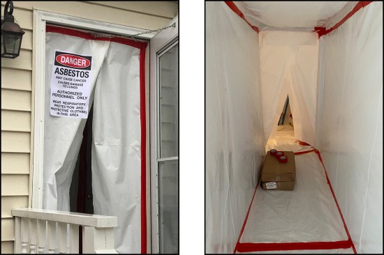

Warning signage is placed at the entrance of the containment area (left). Two layers of 6-mil reinforced fire-retardant poly, with seams sealed, cover floors, walls, and non-abatement surfaces. The enclosed hall shown here will be fitted out with a three-chambered decontamination/waste-out system consisting of a changing room, a shower room, and an equipment room (right).

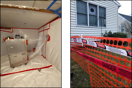

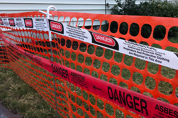

A 1,800-cfm HEPA-filtered air scrubber (left) exhausts to an exterior area that is fenced in with orange temp fencing and posted with warning signage and barrier tapes (right).

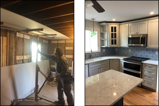

Work resumed after a short break. Wall stud bays were infilled with fiberglass batts and blocked-out for mounting the cabinets, then the drywall was installed (left). We didn’t insulate the ceiling because there was an existing finished second floor above the kitchen — we suspected the vermiculite may have been added to mitigate sound transmission between the two floors. The finished kitchen (right).
