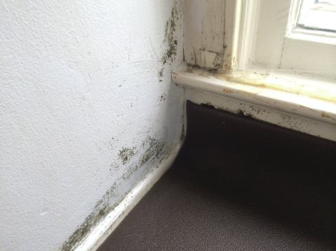

The bay window in the dining room wasn’t well insulated, which was easy to tell because of the mold. In fact, throughout the house, every poorly insulated surface was moldy. To combat this, the homeowners had posted a list of weekly chores for their kids that included wiping down many surfaces in the house with bleach. (In addition to walls being wiped down, the room curtains were bleached weekly, too. With all that bleach, there are likely VOC issues in the home.)
The entire interior of the house is repainted every few years with either Drylok or Kilz. The bay window had been freshly painted less than a month before our visit, yet mold was already popping through.

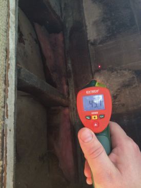

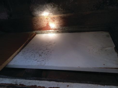

Under that same bay window ran the main cold air return for the house. This area was actually used for storage, and when we looked in there, we found pressboard that was coming apart from being soaked. All the wood was well below the dew point and was moldy. This isn’t exactly a nice, healthy place for the return air to pass through, is it?

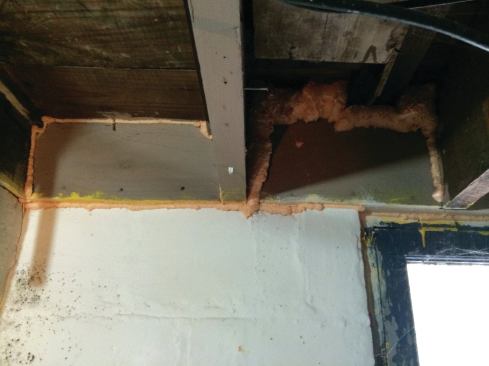

I was pleased with the air-sealing job my guys had done on the rim joists. But note the mold, in the bottom left corner of the photo, growing on the concrete-block wall that is above grade. The homeowner repaints this annually with Drylok, and had only just done it a few months before this photo was taken.
It was easy to find the spots where the dense-pack wall insulation was missing or had settled—no thermal camera needed. Mold ensued where the surface was below the dew point, and not where the temperature was above the dew point.

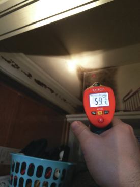

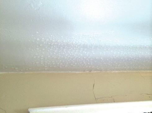

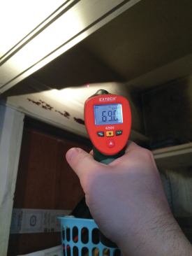

One spot we found was an omission from our previous work. My crew had to work around a ton of stuff in the attic, and the attic above this area of the ceiling didn’t get insulated. There was so much moisture in the house that water condensed on the ceiling. Before we came, it apparently condensed across the entire ceiling and woke up the owner’s three teenage boys quite frequently when they’d get a big drop of water in the face. The uninsulated ceiling area was about 60°F; the warm ceiling was 72°F.

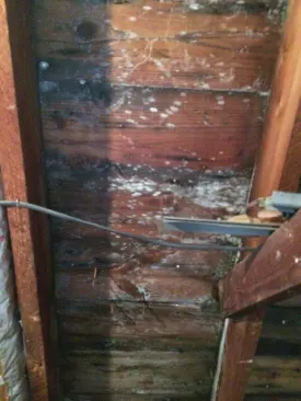

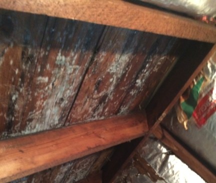

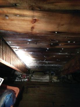

What was most surprising to me was that with all this mold in the house, the owners had only called me in about the mold in the attic. When we had insulated the attic, we had dropped the attic temperature, so condensation now formed on the underside of the roof, followed quickly by mold. The first 6 to 8 feet of the roof was completely soaked by the frost on the nails poking through.
