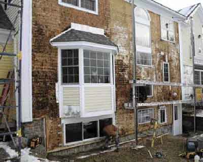

No back-priming. In addition, the 6-inch cedar bevel siding wasn't back-primed. It's possible that, at the time of construction, back-priming wasn't specified in housewrap installation instructions. Later, after researchers had shown that the tannins in cedar could break down housewrap's water resistance, manufacturers began to require that wood siding be back-primed (see "Can Moisture Beat Housewrap?," Notebook, 6/97).
Brown stains from water-soluble extractives in the unprimed clapboards clearly indicate the movement of water. The damage was much worse on the southern exposure, where solar vapor drive played a role.
Solar vapor drive. Another factor in the failure was the home's southern exposure. Although we repaired and re-sided the entire home, we found that damage to the OSB sheathing was limited largely to the southern side. This, according to architect Doug Viehmann, who designed the repair details for the job, was the result of solar vapor drive. Liquid water and water vapor always move from a warmer to a cooler surface, so when the sun heats the siding, it causes moisture to move upward in the capillary spaces — where the siding overlaps — toward the cooler sheathing. Because the tannins in the cedar allowed the water to move through the housewrap, the sheathing became soaked and began to rot.

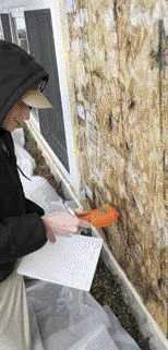

The author's crew used a hand-held moisture meter to mea-sure the moisture levels in the OSB-covered SIPs panels. Readings were highest around windows — which had been poorly flashed — and closer to grade, where water leaking in from above would have accumulated.
Levels were lowest on the second floor under the eaves overhang.
