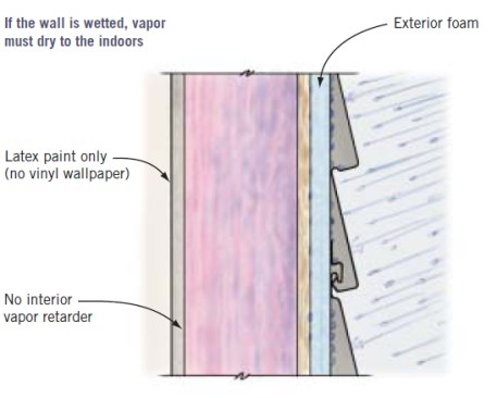

Dryable to the inside. Just as important, a wall should not have two vapor barriers, because that could trap moisture inside the wall (Figure 1). So if insulating sheathing is used, no poly vapor barrier should be attached to interior wall faces. But in very cold climates, says Lstiburek, Kraft-paper-faced batts are recommended. These facings are semipermeable, so they will slow vapor intrusion into the wall while still allowing moisture to escape into the heated space.
It’s inevitable that walls will get wet at some point — either during construction, from wind-driven rain, from a leak or a flood, or from elevated humidity levels. For this reason, all walls must be able to dry. With foam on the exterior, the only place to dry is to the inside, so it’s critical that no poly vapor retarder or vinyl wallpaper be installed on the interior and that the wall be painted with a breathable latex paint.

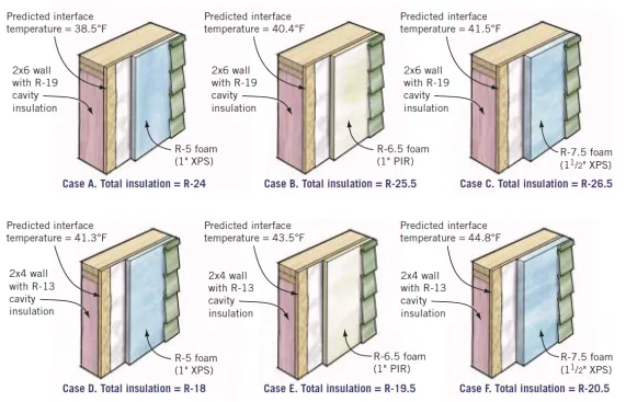

Calculating Foam Thickness
The illustrations below show the predicted temperatures within walls with insulated vapor-barrier sheathing in Boston, Mass. These predictions are based on a simple calculation described by Joseph Lstiburek:
Interface temp. = Indoor temp. – [(Indoor temp. – Outdoor temp.) X (Cavity R / Total R)]
The goal here is to find an interface temperature (the temperature at the inside face of the foam) that is above the dew point for the indoor conditions. If it falls below the dew point, there is a higher risk that water vapor will condense inside the wall and lead to moisture problems. In that case, increasing the thickness of the foam will better insulate the framed wall and maintain the interface temperature at a higher level.
For this calculation, the indoor conditions are assumed to be 70°F and 35% relative humidity — reasonable values if the rest of the house system is functioning well.
At this temperature and humidity, the dew point is 40°F, so the idea is to choose a foam sheathing R-value that will result in a calculated interface temperature above 40°F.
The outdoor design temperature is found by averaging the temperatures for the three coldest months for the year. For this example, in Boston: 33°F (Dec.), 28°F (Jan.), and 30°F (Feb.), for an average of 30.3°F. (Note: These represent monthly average temperatures, not monthly lows or average lows.)
After running the numbers, Case A is found to surpass the energy code, but risks condensation because the vapor-barrier temperature is below the dew point for the design indoor conditions. Case D does not risk condensation, but falls below the R-19 energy code minimum for wall insulation. All other cases satisfy moisture concerns as well as energy codes.

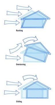

To resist the wind, as well as the possibility of a tidal surge, coastal homes must be stiff enough to resist racking, and they must also be anchored against sliding and overturning. The stiffness comes from plywood or OSB sheathing; foam isn’t enough.

Racking resistance. “The main function of the wood structural panel sheathing,” explains Joe Lstiburek, “is to provide racking resistance. It also helps support the housewrap. So I don’t think you’re going to be able to build in [coastal] conditions without sheathing your entire building with plywood or OSB.”

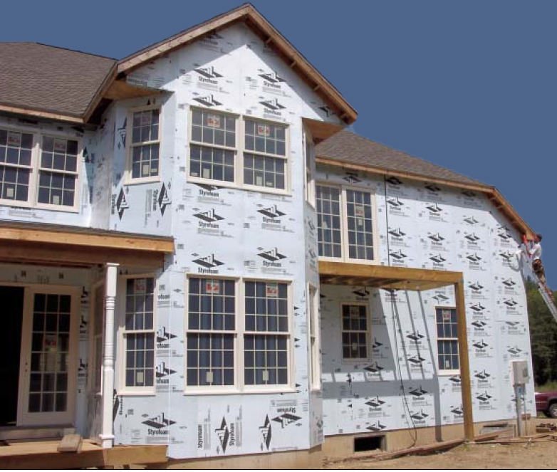

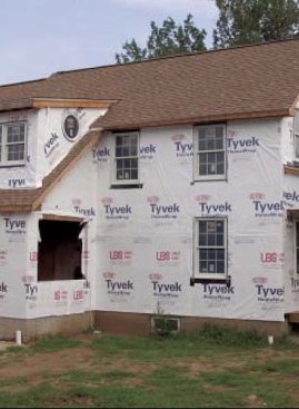

s Just as important in any wet climate, foam serves as a building’s drainage plane for rainwater management. A “Guide to Insulating Sheathing” posted among the technical resources on the buildingscience.com Web site offers several ways to detail the foam skin under siding. But for the severe weather of coastal conditions, Lstiburek calls for a more robust system.
Fully sheathe the building, he says, and then apply a layer of drainable housewrap (Figure 3). “Attach the windows and doors directly to the sheathing, and flash everything just as if you weren’t applying the foam.” After that, the foam gets installed over the housewrap and flashings (Figure 4). Most rainwater will be deflected by the cladding or by the foam sheathing beneath it, says Lstiburek, but any water that penetrates further will be shed by the flashings and housewrap; and any minor, incidental leaks should be able to dry into the conditioned space.
While foam is water resistant and provides a good barrier against the bulk of the weather, wind-driven rain can find its way around panels and through joints, so Caulkins relies on a housewrap and careful window flashing installed over a fully sheathed structure before installing the foam.

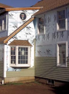

Contractor Craig Caulkins of Caulkins Building & Design in Niantic, Conn., routinely applies 1/2-inch or 1-inch Dow Styrofoam to home exteriors under vinyl siding.

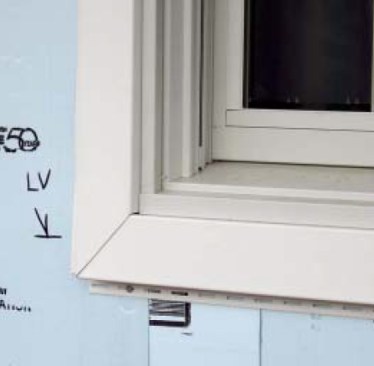

In combination with Andersen flanged vinyl windows, says Caulkins, no special furring or attaching method is required: Window flanges extend far enough from the wall to cover all foam edges. Crews flash the window openings with self-adhering membrane, fasten the window directly to OSB-sheathed wall, and then apply a two-piece window surround from CertainTeed.

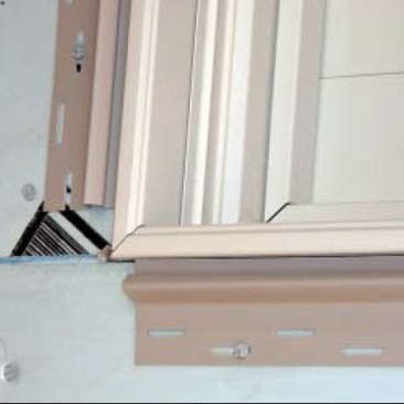

The base piece of the window surround is nailed through the foam into the window rough frame (left), and the matching top piece snaps into place over it.
