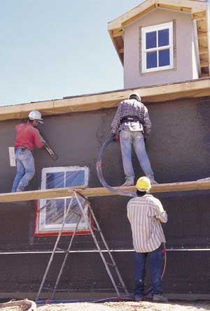

The fact that stucco is highly vapor-permeable doesn't mean that you can forget about the effects of water and water vapor on framing and sheathing. It's important to protect the framing and sheathing from any rainwater that does get behind the stucco (see Figure 1).
Figure 1. A properly installed weather-resistive barrier is essential to protect the structure from moisture intrusion. Here, 60-minute Type D kraft paper is being installed.
Make sure that the backup system of flashing, weep screeds, and a weather-resistive barrier is carefully installed. I have covered this subject at length in another article (see Stucco Flashing Details, 10/98), so I won't repeat it here. But the best way to think about the backup system is to imagine that you are all done with the prep work but the stucco hasn't been applied yet. If you were to spray water on the building with a hose, it should all run off without any water getting to the framing or sheathing (Figure 2).
Figure 2. Lath can either be stapled -- the fastest method -- or nailed. Special furring nails (inset) are designed to hold the lath off the wall so that it's properly embedded in the stucco.
