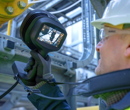

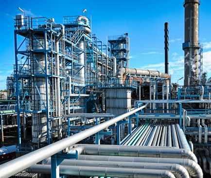

Imagine you are the facilities manager at the manufacturing plant shown in the photo below left, and you’ve been told there’s a leak in one of those pipes moving air or another gas under pressure. How do you find the leak?
At a cost of about $21,000, plant managers can use an acoustical imaging device made by Flir (right) to detect leaks in compressed air, gas, or vacuum piping systems.

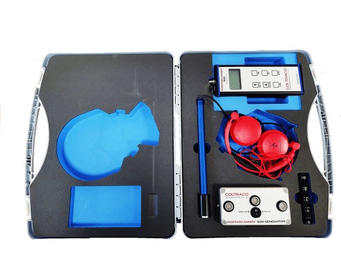

Coltraco’s equipment has two main parts—a sound generator and a microphone/wand connected to a digital receiver. There are two versions of the tool, Portascanner and Portascanner Airtight. The standard Portascanner (the model I own) simply identifies the leak location and supplies a basic reading as to the leak’s intensity.
Coltraco’s Portascanner consists of a sound generator and a microphone wand connected to a digital receiver.  This model identifies the leak location and supplies a basic reading as to the leak’s intensity.

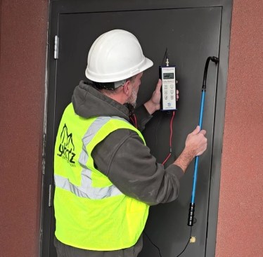

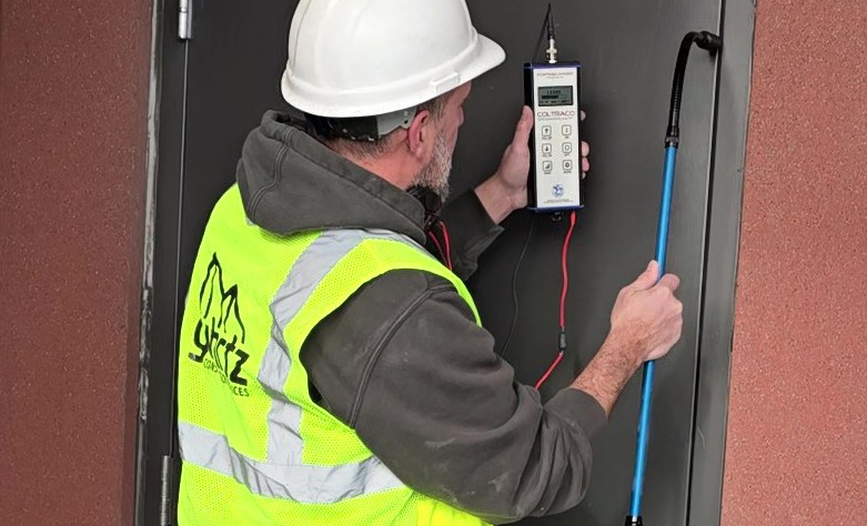

The author has begun using the Coltraco Portascanner, which the manufacturer has dubbed an “ultrasonic room integrity testing tool,” to find specific building enclosure leaks.

Using the more basic Portascanner is simple: You set up the sound generator, assemble the microphone/wand to the extension poles and handle, connect the microphone/wand to the receiver, plug in the headphones, and you are ready to go.
The generator produces sound at a frequency of 40kHz, well above what humans can hear. I did notice that my cats react to that frequency; the noise didn’t hurt them, but they heard it. The instructions suggest placing the generator about 15 feet from the area being tested, on the opposite side of the building assembly from the microphone/wand. The microphone/wand is then moved slowly along the area being tested. When it encounters an air leak, the digital receiver produces a sound through the headphones and shows a reading on the display as either a decibel scale or a linear scale that informs the user of the leak.
When a leak is detected, the sound will become louder in the headphones and the reading on the display will show the leak’s intensity. The decibel scale ranges from 0 to 75 and the linear scale, from 0 to 31,775. A reading of 0 on either scale means the assembly being tested is airtight. Higher readings indicate air leaking through the assembly. The manufacturer claims that leaks as small as 0.06mm—about half the diameter of human hair—can be detected with the equipment. That is a very small building leak.
