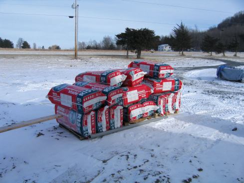

There are eight 3 ½-inch batts to a bag, which covers 60 square feet, and because each bag of Roxul was wrapped in a heavy plastic film, I could leave it outside without worrying about rain or snow damage. Detailed, illustrated installation instructions are also printed on the wrapper.

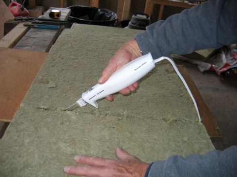

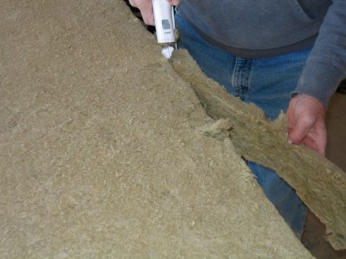

To cut the batts, a long-bladed knife, rather than a utility knife, is recommended because they are dense. And because Roxul is spun rock, the cutting knife needs frequent sharpening. A serrated bread knife works well, but what worked beautifully for me was a $15 electric carving knife. This knife also allowed me to shave off narrow strips easily. This was helpful for a narrow bay or when my first cuts proved to be too long
I created a cutting table by stretching a couple of plywood rips over sawhorses and simply ran the electric knife down the middle. For narrow pieces, I hung one edge of the batt beyond the plywood, and carved off what I needed.

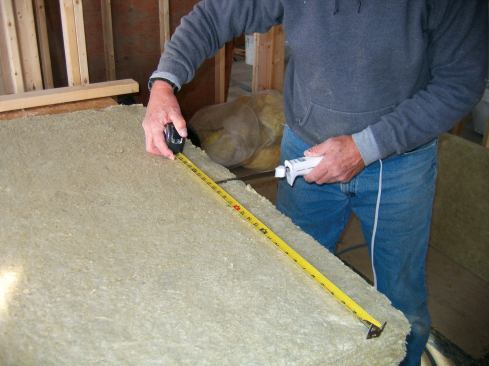

When I cut pieces to length, I cut them ¼- to ½-inch longer than my measurement to ensure a tight fit. I laid out my measurements and with a 4-foot level connected my references, creating a straight line to cut along. Surprisingly, I was able to draw a legible line on the ComfortBatts with a black permanent marker.
The house has four different window sizes. I pre-cut batts to match the heights of the wall cavities above and below the windows, and cut the batts to width as I placed each one. I sped up installation further by pre-cutting widths for several full-height bays at once.

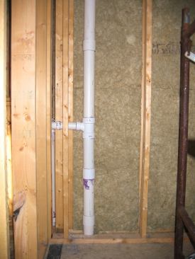

Squeezing any fibrous insulation behind electrical boxes is not a good idea, so we cut around the boxes. For wires, we scored the Roxul and inserted the wires into the grooves. For plumbing pipes, we made a V-groove to accommodate each one, always keeping the pipes to the warm side—the inner wythe of my double-stud wall framing served as a utility wall.
