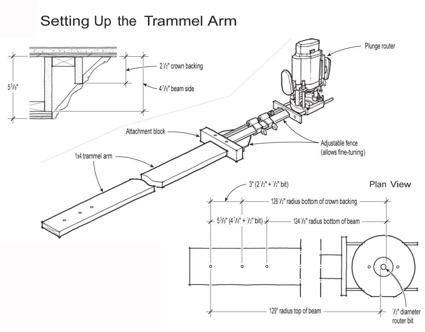

Setting Up the Trammel Arm
Because every piece of backing had to be precise, cutting it with a jigsaw was out of the question. Instead, we used a trammel arm — a piece of 1×4 — attached to a router. There are many ways to attach the router; some carpenters make an auxiliary wooden base and screw the router right to the base. For this job, we used an adjustable fence made by Porter-Cable (42700 Edge Guide, $40 at Amazon.com). Since this guide doesn’t fit every brand of router, we had a local machine shop make an aluminum adapter so we could use it with our Bosch plunge routers. The nice thing about the Porter-Cable guide is you can quickly fine-tune the trammel-point distance.
Working from the drywall surface, we set up the three trammel points. The longest radius was for the top of the beam, the shortest for the bottom of the beam; a third intermediate point was for the bottom of the upper-crown backing. The trick, when setting up a trammel arm, is to make sure you’re measuring to the correct side of the router bit.

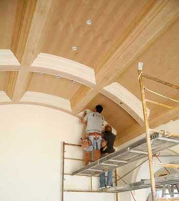

Installing the Crown
Each coffer had four pieces of straight hardwood crown (two lower, two upper) and four pieces of flexible plastic crown. Installation took a lot of patience. We ended up using a combination of coped ends and open miters to get it done.
Starting with the bottom crown, we first experimented with open miters. We found that cutting both pieces at 43 degrees got us close, but the joints didn’t close as tight as we wanted. We also tried coping the ends of the flexible crown, but still couldn’t get a good fit.
Finally, we tried coping the ends of the straight hardwood. Cutting the coped end at 43 degrees worked best. We cut the pieces a little long and pressed them into place. This locked the flex trim into position and hid the inconsistencies you always get between flexible molding and its hardwood equivalent. The tight copes hid everything.

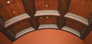

Except for the coloration difference between the flex molding and the solid alder, the upper and lower crowns looked like a single piece when we were finished. And by the time the painter finished applying multiple veneer coats and graining, the whole ceiling looked like alder.
