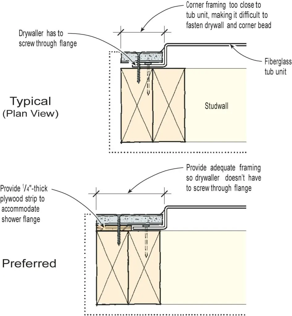

To prevent a bump in the drywall, don't screw through the tub/shower flange.
To avoid a bump in the drywall and the increased likelihood of a cracked finish (the likely result of the typical view at top), you have two choices: 1) Shim the framing next to a tub/shower unit so that it’s flush with the fiberglass flange and the drywaller doesn't need to screw through the flange (detail above).

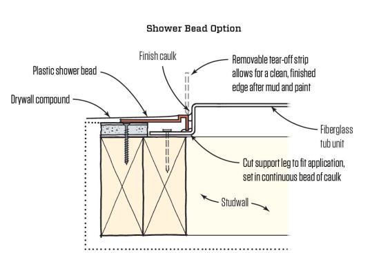

2) Or you can use specialty PVC drywall trim, such as the Shower Bead, which bridges the gap created by the flange and provides a clean, finished edge against the tub/shower unit.
