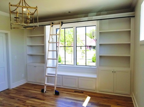

For years I avoided building ladders because unlike the code guidelines for stairs, those for a safe ladder were always a bit fuzzy to me. Then a few years ago, I found out that Custom Service Hardware (CSH) offered kits that eliminated the guesswork of building a library ladder. CSH sells kits with prebuilt ladders as well as kits with just hardware, and when a client requested a library ladder to access built-in bookshelves that we’d built in a bedroom, I jumped at the challenge. I also saved them a little money by building the ladder myself, out of maple that matched their hardwood floor.

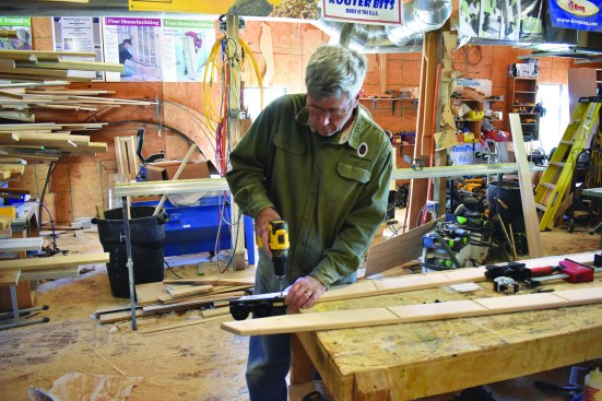

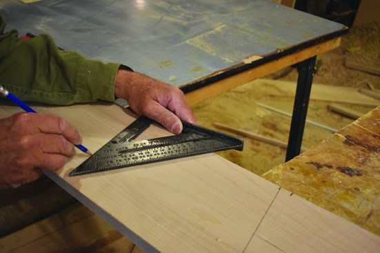

Making the rails and treads. CSH offers an online guide with the dimensions and angles for making your own ladder. Building the side rails began with selecting the flattest material I could find. Because of the work involved in milling the side rails, I decided to make a spare set of rails for a future ladder. Following the CSH guidelines, I made the finished rails 3 1/2 inches wide and 13/16 inch thick. I ripped the rails 3/16 inch oversize and straightened one edge on a jointer. To true the other edge, I ran the stock through a planer on edge.
Then he draws layout lines with a rafter square.

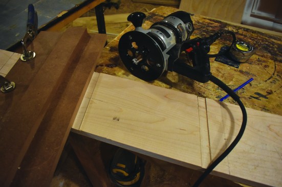

A stepped jig guides a router to cut the dadoes.

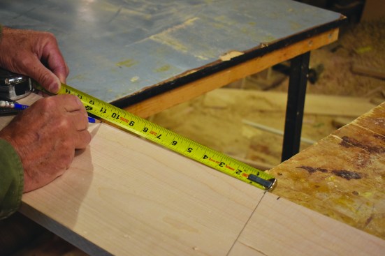

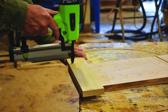

The guidelines recommended fitting the ladder treads into shallow dadoes cut into the rails at a 12-degree angle. Before cutting the dadoes, I tacked a scrap of 1-by stock to join the ends of each pair of side rails while I laid them out and routed them. I gave the treads 10 5/8 inches of rise between steps and drew layout lines with a rafter square set at 12 degrees. I made a stepped jig to guide the router for the dado cuts, with the step width being the distance from the edge of the 3/4-inch-diameter dado bit to the edge of the router base. I clamped the jig to the rails with the edge positioned on the layout line, and then let the router base travel along the edge of the step on the jig.

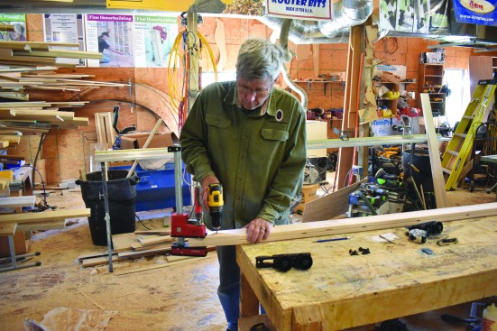

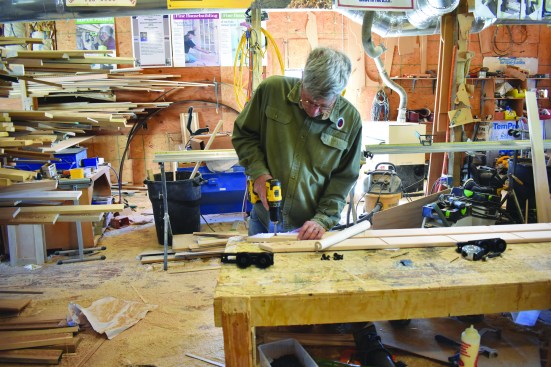

To soften the sharp edges on the rails, I ran a 1/4-inch round-over bit along every edge (6). I test-fit the upper rollers that mount along the 78-degree cut, then marked and drilled the mounting-hole locations.
The author drills holes for the rollers ...
The author drills holes for the rollers …
... and a pilot hole for the top rung.
… and a pilot hole for the top rung.

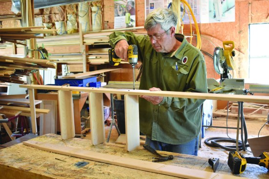

Building the ladder. Every library ladder has a turned rung between the tops of the rails where the rollers mount. I could have gotten one from CSH, but for this ladder, I turned a simple dowel on a lathe in the same maple as rest of the ladder. I cut the dowel to an overall length of 15 3/8 inches, and made 1/2-inch-long by 3/4-inch-diameter sections at each end to fit into round slots in the rails.
To install the dowel, I first clamped two opposing sides together, lined up the ends, and drilled a tiny pilot hole through both sides (8). I centered the pilot hole between the holes I’d drilled earlier for the rollers, and using a 3/4-inch Forstner bit, drilled a 9/16-inch-deep hole on the inside of each rail, using the pilot hole to start the bit.

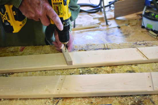

Because the treads would be held in place with exposed screws, I wanted uniform spacing for the screw heads. I made a drill guide out of 3/4-inch stock that fit into the dadoes to drill screw holes for each tread.

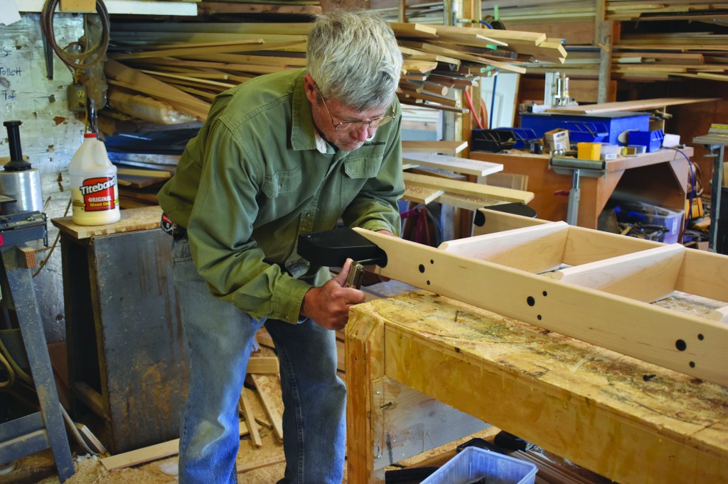

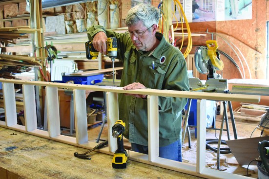

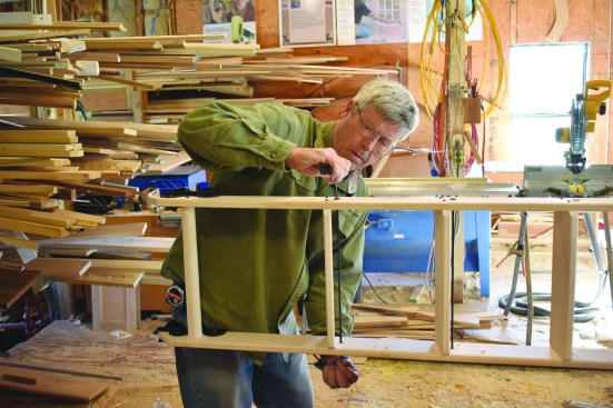

To ensure that everything would go together smoothly, I test fit the treads, shaving a little off the ends with a block plane to slide them easily into the dadoes. To assemble the ladder, I slipped the treads into one rail, predrilled holes in the treads, and drove in a pair of the 1 3/4-inch washer-head screws that came as part of the kit.
When I’d attached the treads and the top rung to one rail, I flipped the ladder over and attached the opposite rail (12). After attaching the treads to both rails, I attached the top rollers.

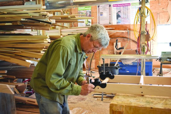

The last shop task was attaching the bottom rollers. The rollers have metal tabs that wrap around the bottoms of the rails and provide a lot of strength. One bolt and one screw hold each bottom roller in place. Even though the painter needed to finish the ladder before the final installation, I wanted to test fit the ladder and install the track, so I loaded up everything and headed to the jobsite.

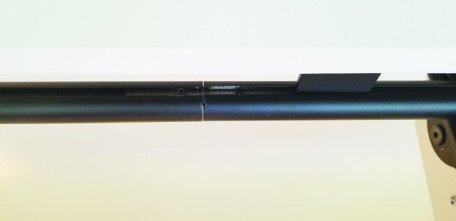

After inserting the splice hardware into the track (16), the second section attaches to the first, installed in similar fashion. The finished ladder is handsome and useful for accessing the bookshelves.
Ladder installation. The top ladder rollers travel on a cylindrical track that mounts on horizontal L brackets. Installing the ladder was a two-person job. First, we slid the mounting brackets into the slit in the track. Then one person held the track up while the other attached the brackets to the shelves, spacing them no more than 32 inches apart. We then slipped the ladder onto the installed section of track. After cutting the second track section to length, we secured it in place with the mounting brackets and connected the two sections with splice hardware inserted into the track.
