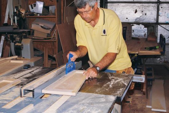

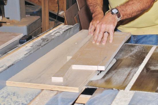

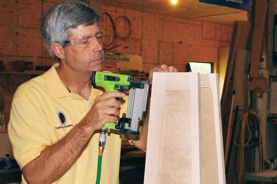

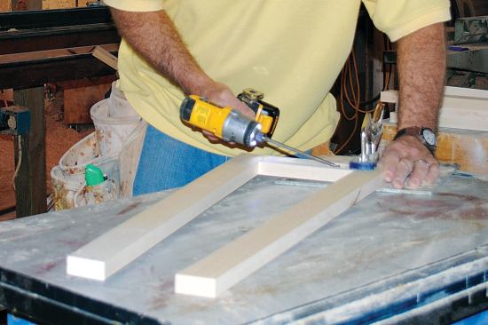

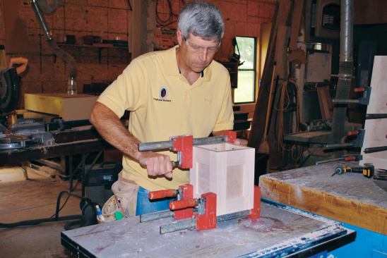

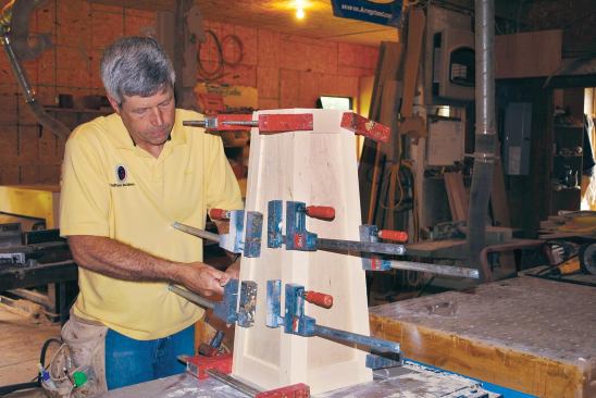

Pocket-screwed frames attached to an inner plywood column made for efficient assembly

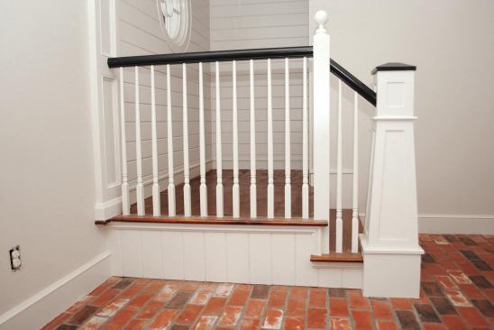

Phase 4: Installing the Newel Post
The final phase involved fastening the newel post in place and adding the decorative frame-and-panel base to conceal the structural connections. In the accompanying slideshow you’ll see how I:
  • Set blocking and cleats on the floor and first stair riser to provide adequate structural support for fastening the newel post in place
  • Fastened the base of the newel so that it won’t budge

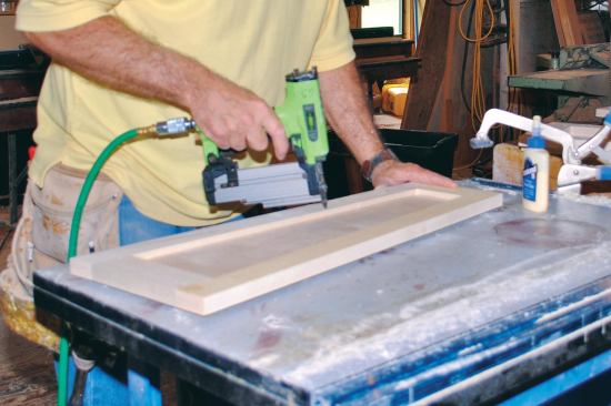

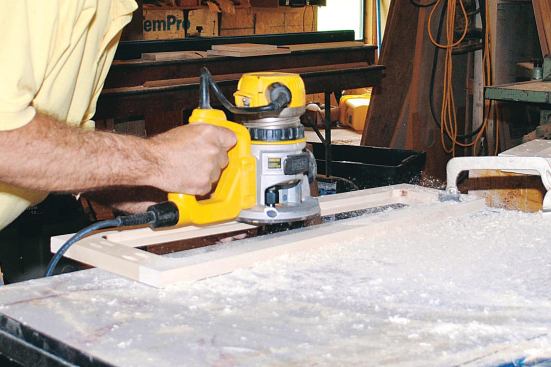

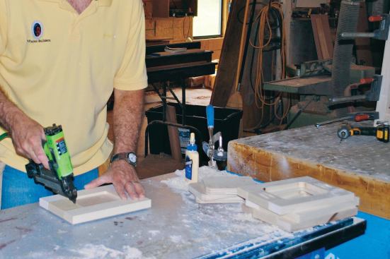

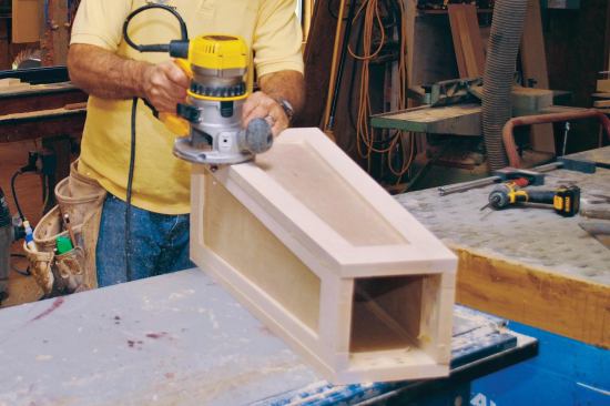

  • Finished the base of the newel post with panels and chamfered trim
